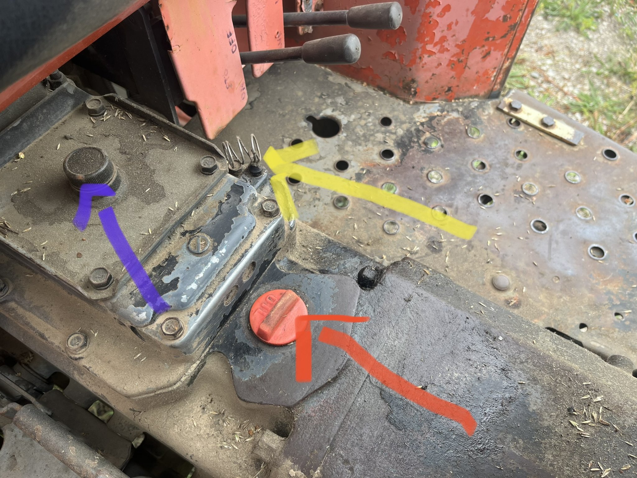

I was able to finish my mowing for a few months so I’ve got a little time to do a few things. I’m going to clean, pressure wash etc the whole thing and dive into more adjustments. I just did the fuel injection pump on my John Deere 5500 and it runs much better so I’m going to do this one as well. I’m probably going to do the hydraulic fluid as previously mentioned as it seems like it’s time. I’m attaching a pic if someone can tell me if there is only one point to put hydraulic oil into this tractor.
I've marked the pic with 3 arrows, is the red arrow the only spot to add the almost 12 gal hydraulic fluid? The yellow is my dipstick and is the blue one where a hydraulic line might go if you have a loader or backhoe?? Thanks again 4A2F4A6A-B364-4338-B1A7-BB21F85D20A6.jpeg
