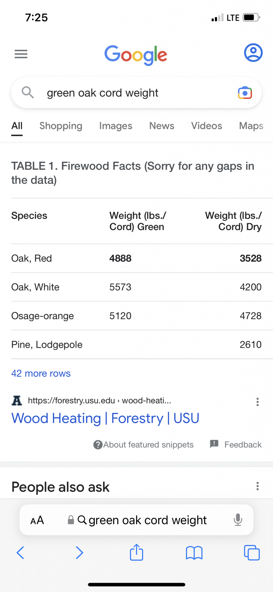

Very good points, thank you. I really have no clue what a full tote weighs loaded with the green oak. Only know what i could lift by trial and error of loading until the B didn't want to move it anymore. I will have to do some math and figure out around what the totes weigh full.
You could take an estimate of the cube your are using and see how much of a cord you think you get in there…I put a chart with green weights for you below. I’d think you probably have less than a face cord in the tote…probably 1/2 - 2/3 of a face cord would be my rough guess….but I really am not sure…depends on tightly you stack them and actual volume used.
Thank you.
