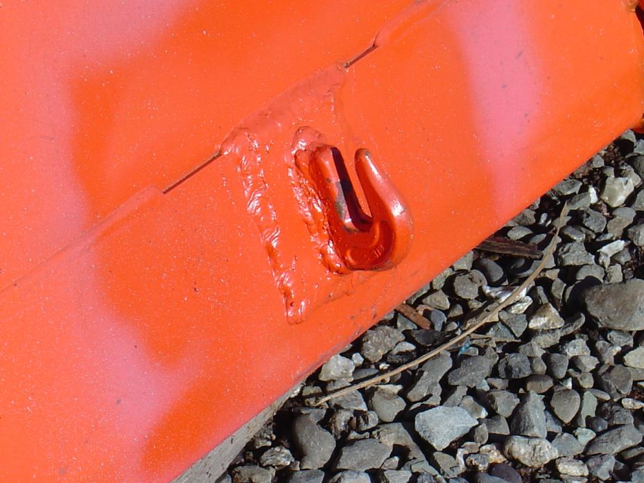

I put three on the top, one in the middle and one one each lined up with the loader arms. Be sure to add support, like a pipe, to the top of the regular duty bucket to keep from crushing the curled edge. (The heavy duty bucket already has a pipe on top.)
The center hook on the bucket will work to use the front edge of the bucket with the curl function.
Keep the two top edge hooks within the arms of the FEL to minimize off-center loads.

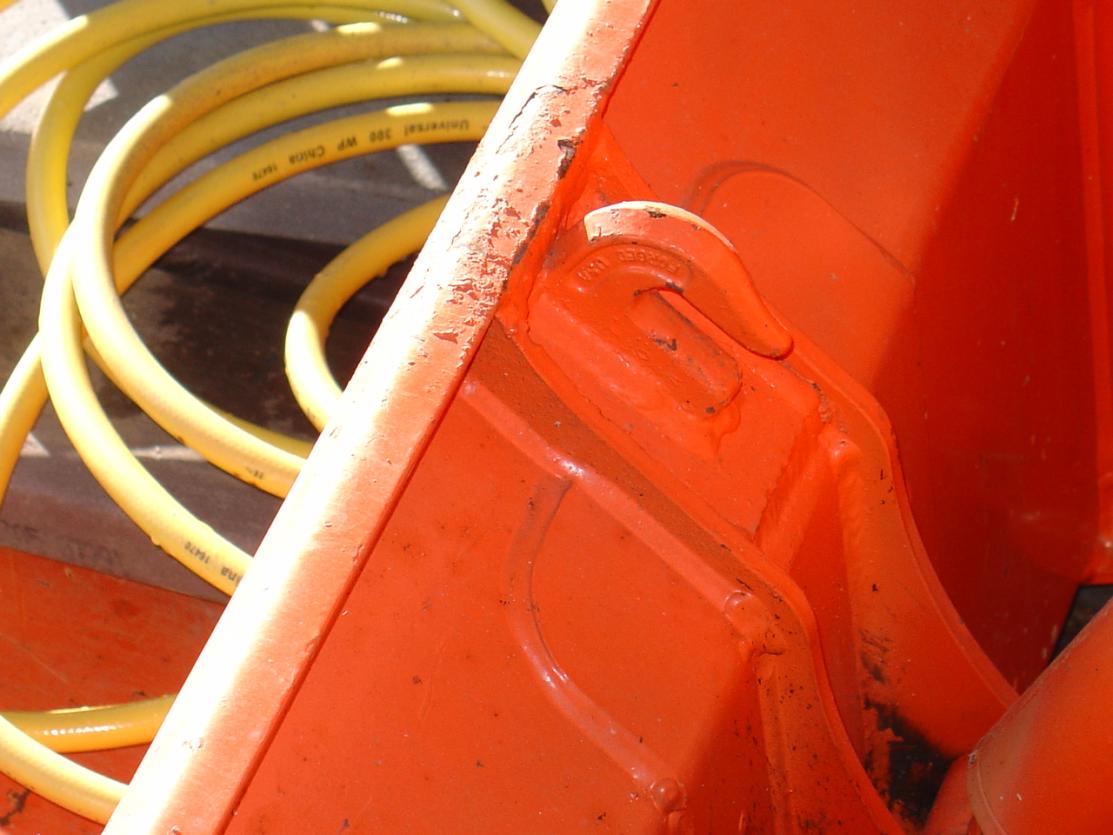

A hook is welded to the back of the bucket (near the brush guard, not inside) for heavier lifting.
Be sure to weld the hooks to a backing plate, maybe 4" x 5" and then weld that to the bucket.
There are special weld-on hooks that work perfectly.

GWD - thanks. My dealer recommended using the same type of hooks that are on your link. He also said that the hooks that are welded to the top of the bucket should be kept "inside" of the loader arms - like you suggested too.
I'd like to see a picture of the hook that is welded to the back of the bucket.

A BX2200 is not too long on lifting power with it's single cylinder bucket.With this in mind I just mounted a single slip hook on a plate welded to the reinforcement for the cylinder.

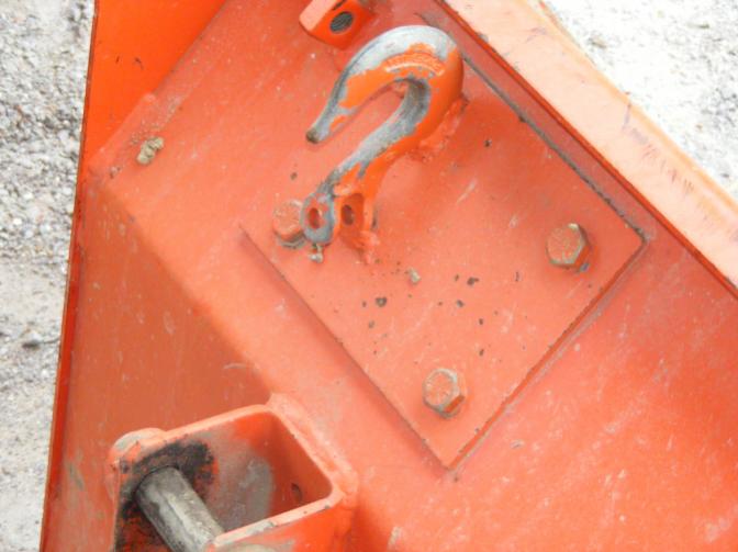

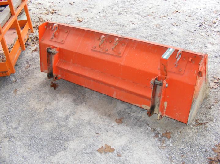

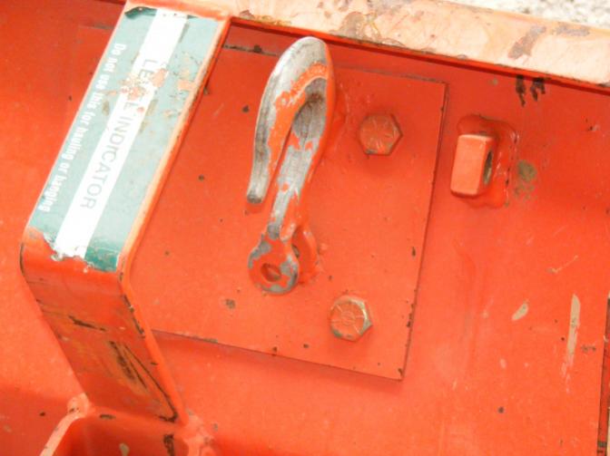

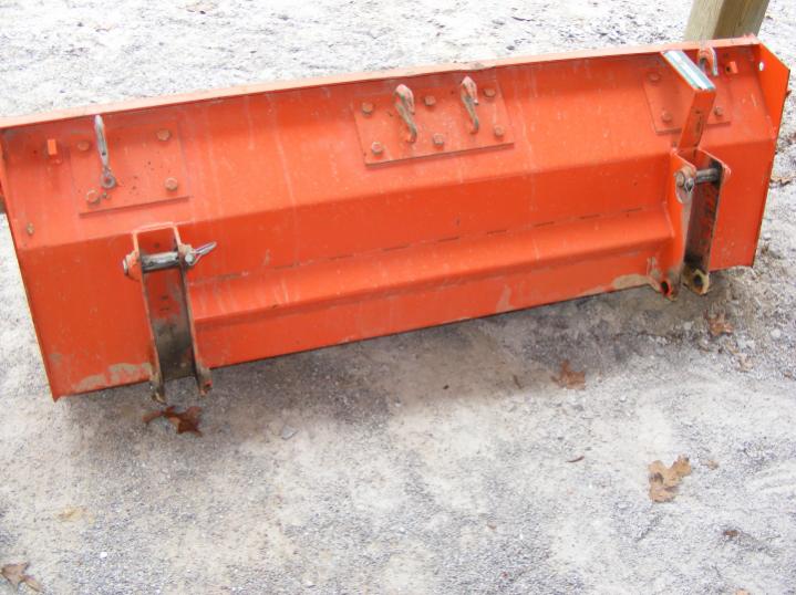

I have 4 hook on my bucket. 2 3/8 hooks in the center and 1 slip hook on each end. When I use the slip hooks on the end of the bucket I can then use the center hooks to adjust the chain length. Having 2 center hooks is nice when you need to have different length chains.
I welded mine to plates and then used grade 8 bolt to attach them. For one, I didn't want to burn the paint off my new loader and figured the plates would help to spread the load to a wider area.

You can see on Bulldog's second photo where the short piece of pipe could go under the top lip of the bucket to reinforce the top edge. It looks like 3/4" pipe would be the right size to reduce crushing on that bucket. In fact, one length of pipe under all four of the hook would spread the load quite well.
Now that the bucket has a few nicks maybe he'd consider it.

I fully agree with you on the pipe. It needs it or in the right circumstance the bucket will get bent. That bend in mine happened long time back. I have forks now so I don't lift with my bucket like I did before.

Can you post a photo showing the inside of the bucket. Just curious to see the bolts. I like your idea but think I would run the bolts the opposite way to keep from anything snagging inside the bucket.
