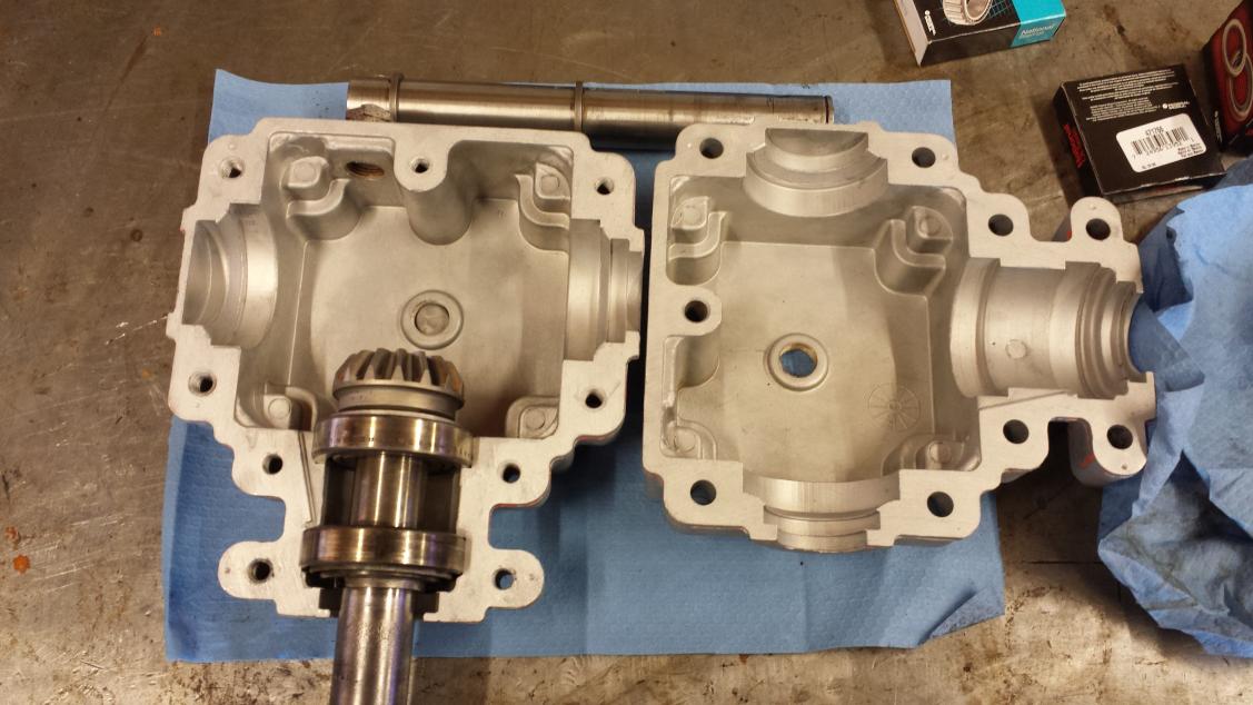

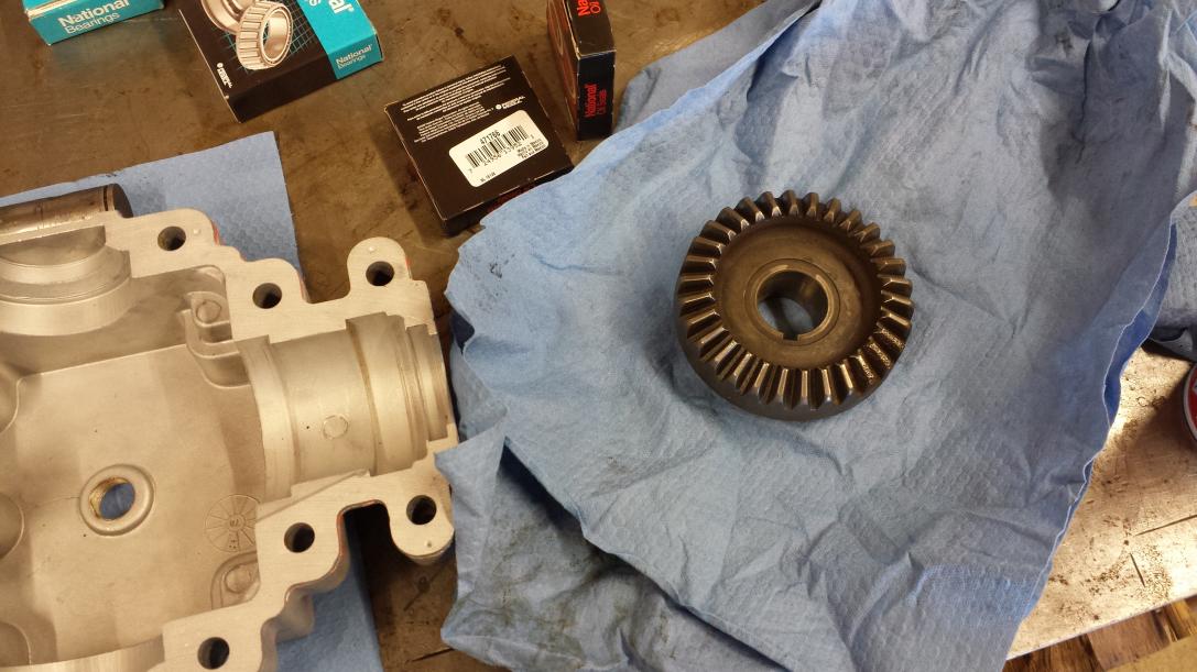

That gearbox listed looks almost exactly like what I have except i have the older model with the output shaft and gear all one piece. I don't have any pictures right now, but I finally got the gearbox apart after heating the pulley mount and the pto yoke to get them off. I took the bearings and seals to the parts store and they matched them up and will have new parts this afternoon. the other issue I ran in to is the main gear has some rusting and pitting on it. I will get a picture of it and post it later.

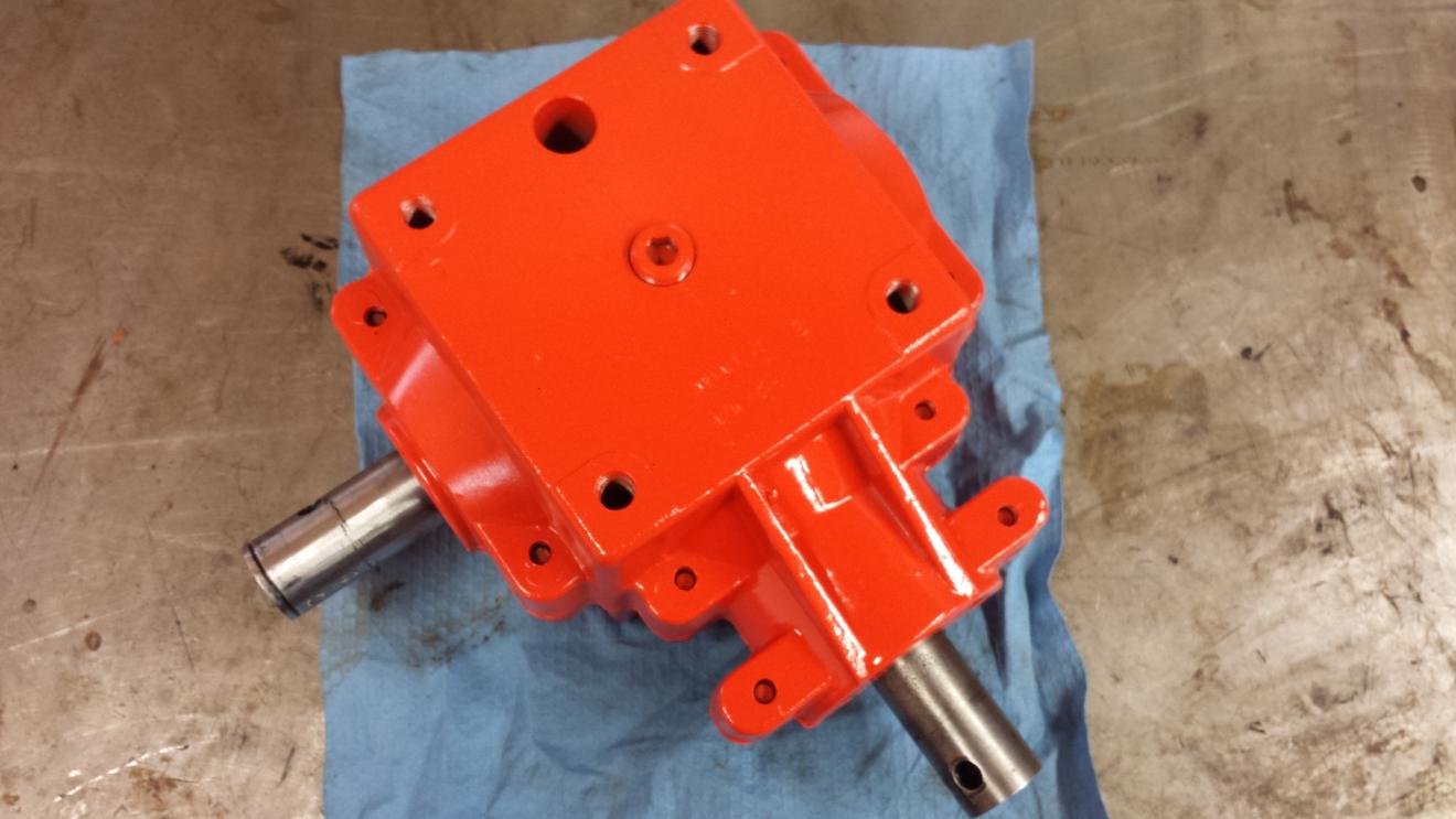

After taking it all apart, I bead blasted the case inside and out, it looks much better now. (I didn't take pics before I'm bad at pics) I installed the new bearings and seals, polished up the rusty gear as best as I could. I reassembled it with some engine assembly lube. I painted it Kubota Orange last night and will get more pics up as I start putting it back together.

Wow, that gearbox looks almost new. The gear look like they are in great shape.
Yup, top her up with oil and get to mowin'! :D

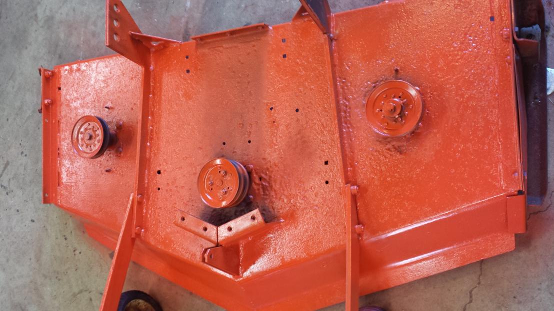

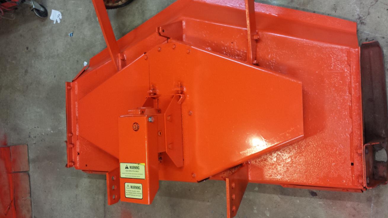

A few more pics, I got it all assembled and painted up and it works great. one bearing is a little noisy but I gave it several pumps of grease and I plan to run it till it gets a little sloppy and then replace it. as you can see in the one picture the deck is pretty pitted. I gave it a good wire brushing and painted it first with some stuff called chassis saver that I picked up at my local auto parts.I have had very good luck with it sticking to rust and keeping it covered (since its made for that) then painted orange over the top of the black. Amazing enough the gearbox is painted with Kubota orange II rattle can and the rest of the mower is painted with Dupli- color Chevy Orange engine paint at less than half the cost per can.
