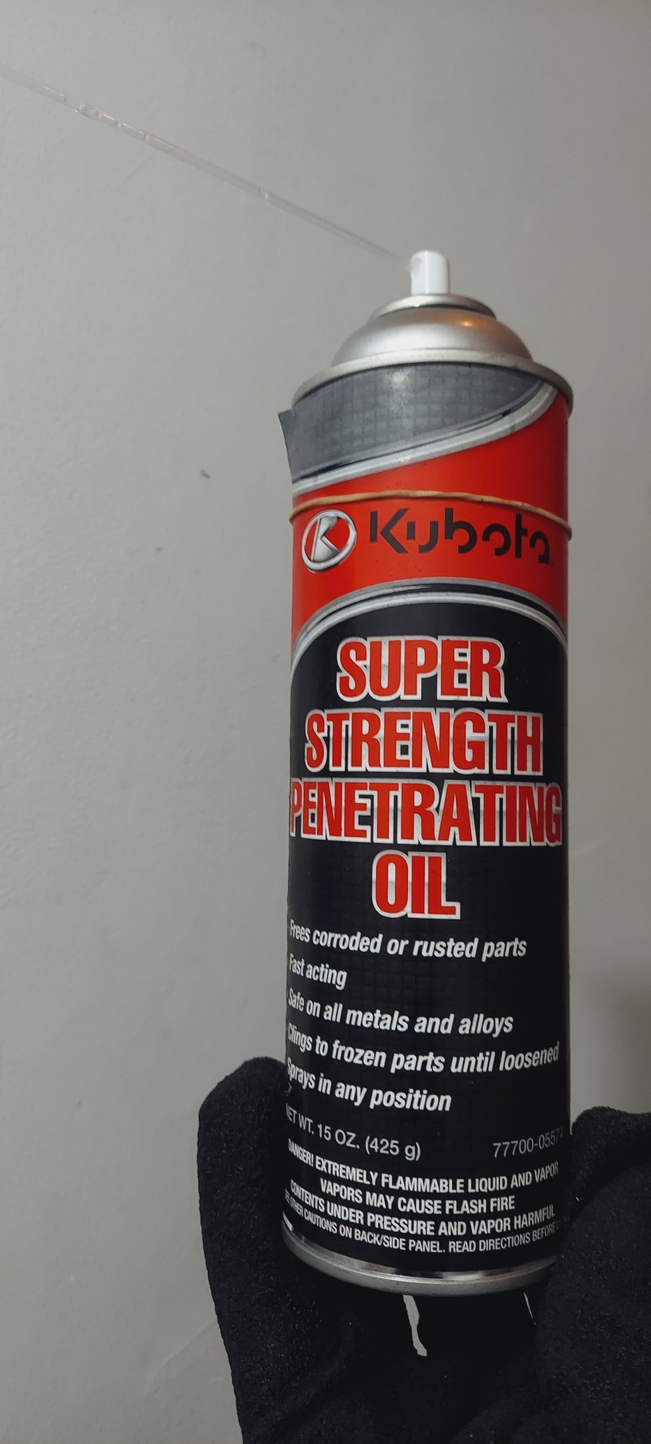

Has anyone seen a comparison with kubota's penetrating oil? My shop swears by it. Comes in a 15oz aerosol can for $11.44+tax. They said they used it and a #4 sledge to pound out my backhoe pins frozen by salty air. I couldn't do it with a 10T porta-power and Acetone/ATF.
