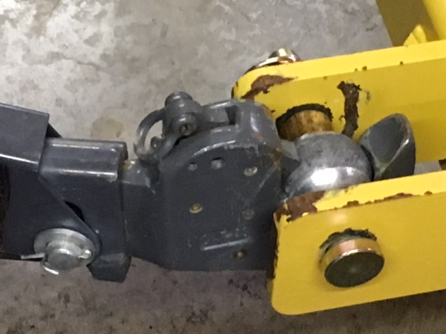

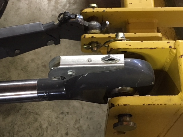

For those that do not know of the Euro type ends. You get full articulation with full contact in all positions.
