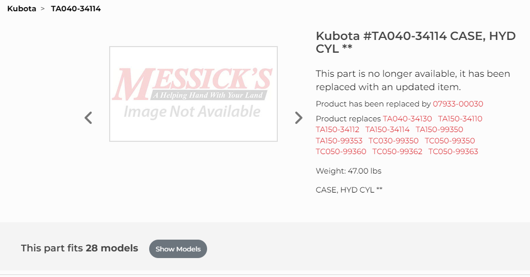

According to Messicks it does....It would have been the original, non-superseded part number.
I'm not seeing where there is any link between these two parts:
What he needs TA040-34114
and
The eBay listing TA040-34110

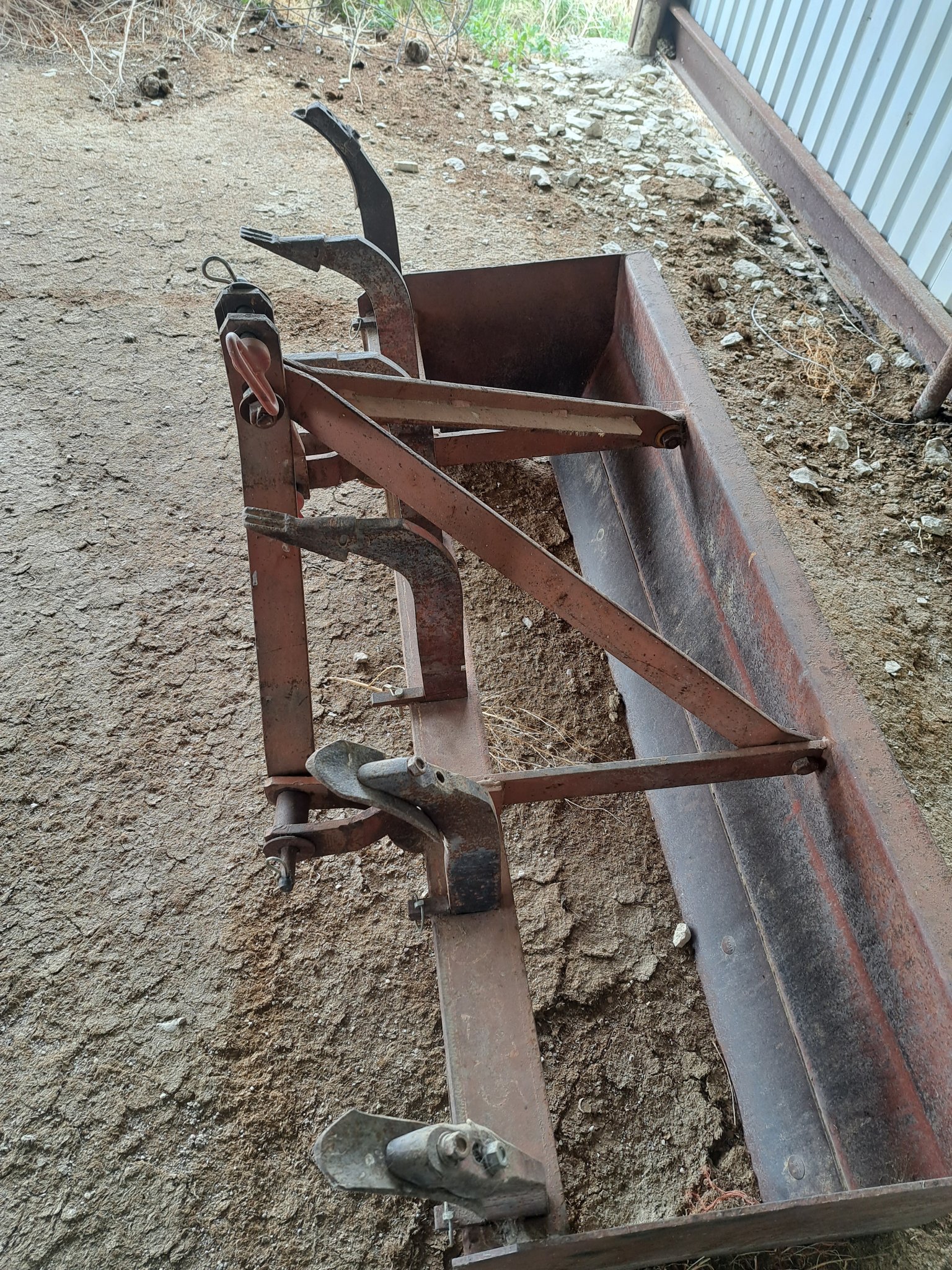

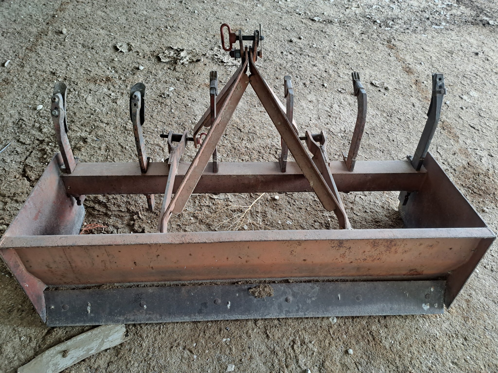

Does your brush hog have a floating top link?
Are you running around with it lifted and hitting bumps?
Because that will do exactly what you have going on!
Brush hog bounces and then slam, hits the cylinder with huge force, thus breaking the case.
taylorce1
L3010
May 4, 2023
11
Colorado
Yes it has a floating top link. I don't run around the property with the mower lifted, I keep the wheel on the ground as much as possible. However, it could be my old box blade it is pretty heavy duty and probably weighs more than my mower. 16838360210056670963488180283724.jpg 16838361455161447743538931198325.jpg
I got it from my Dad when he went to a 12' drawbar style box blade. I'm 51 next month and he's had it as far back as I can remember. I remember it behind our old JD 60 tractor when I was a kid.

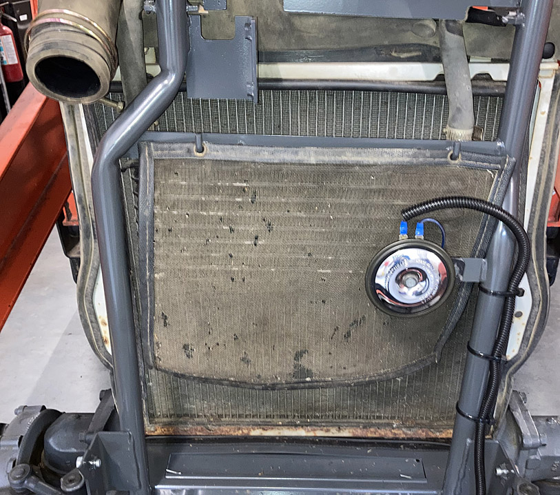

Fall is the worst time for mowing. Once everything dies and drys up, the radiator plugs quickly with dust and dried plant pieces. Once it starts to get up there in temperature and I stop to clean the radiator I'm done for the day. Until it dries out completely all the moisture from washing out the radiator does is cause it to plug up faster.
look at putting some type of cheap AC filter in front of the radiator.
this is a washable type
Then stop and shake it out or blow it out every half hour and get back to mowing.
The Grand L's do come with screen filters for the radiator and HST cooler. It's surprising the amount of crap they catch too.....
