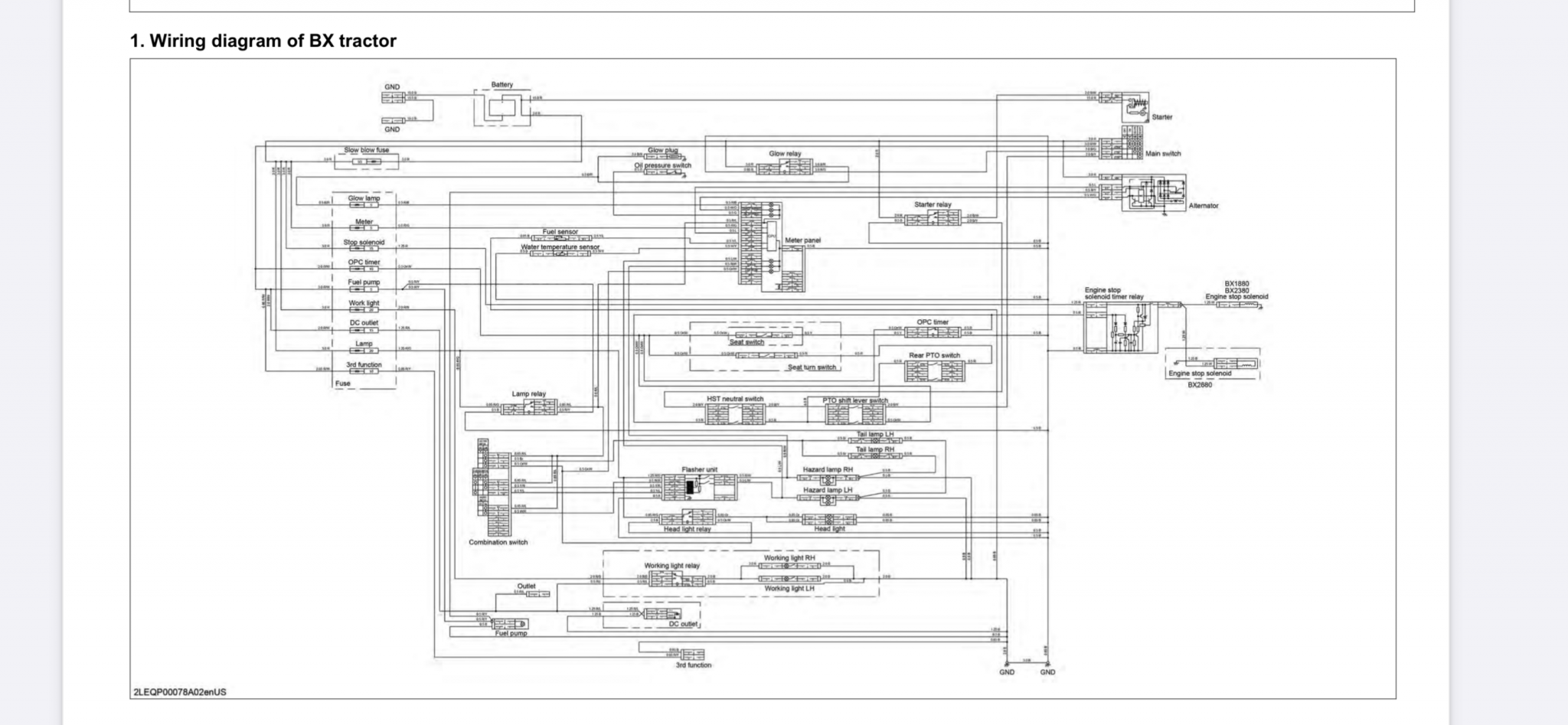

Not sure how this will turn out but here a screenshot from wiring diagram
The load side of the relay is a constant power feed, control side is ignition switch fed from the dc outlet circuit. If those wires are swapped at the relay it would cause it to be energized all the time
How does the relay work (not an electrical guy)? Suppose to only allowed a running tractor to power the lights?
If wired properly (according to the diagram) the relay would only be energized in the run/glow/start position of ignition switch. Basically it shouldn’t be energized when off.
