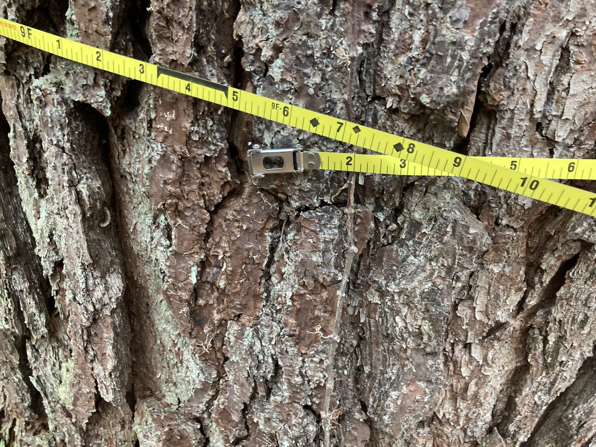

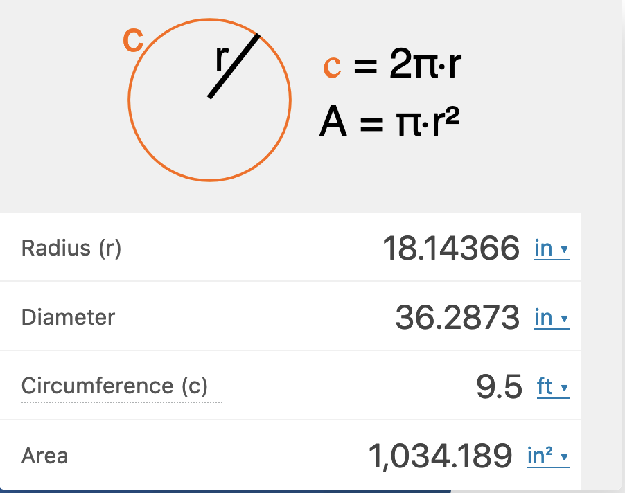

Cut the tree down and measure it properly. We want detailed pictures. :)
Turns out my brain box was off by a foot diameter. I measured a few of the big pines circumference today. Largest tree I could get to (lots of brush and brambles around the stand) was 9'6", equating to 36.25" diameter. I think the two big stands of pines are at least 40 years old. Image-26.png IMG_3138.JPG
8,001
5,188
Turns out my brain box was off by a foot diameter. I measured a few of the big pines circumference today. Largest tree I could get to (lots of brush and brambles around the stand) was 9'6", equating to 36.25" diameter. I think the two big stands of pines are at least 40 years old. View attachment 91671 View attachment 91672
You obviously have lots of pine lumber just waiting for you.
I would suspect that they are a lot more than 40 years old.
