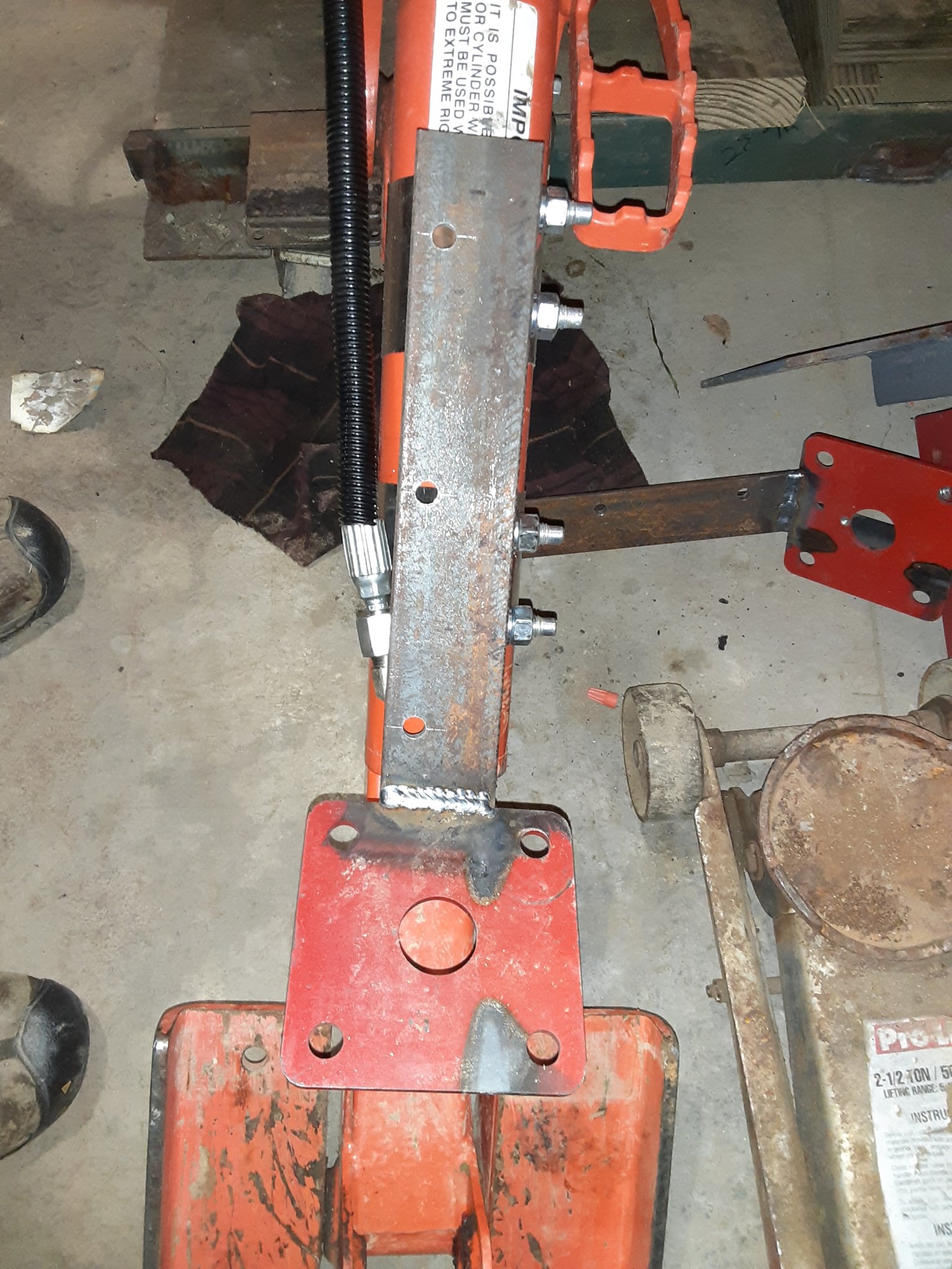

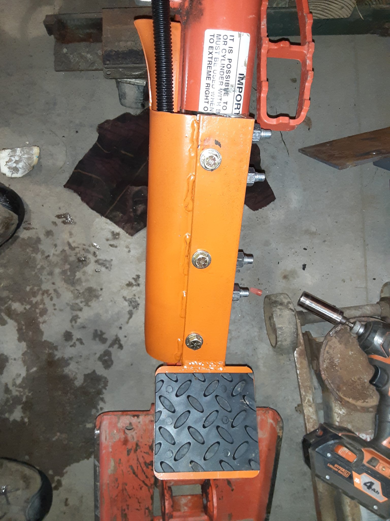

I ripped my right outrigger hose off in the woods with a grape vine and have given some thought to guard/step combo. My thought but untried is to make the guard protect the hose and fasten it to each cylinder with a couple of right sized exhaust clamps as long as it missed everything when up and the step was mounted to that. I was thinking a piece of 3" emt (something I have on hand) with one side cut out might even make both from one piece. Again not tried yet but figure it takes away all the problem with movement between the outrigger and the cylinder in the up and down.
Bill
Sometime between dec and now I tried my hand at a guard and this is the result.
I used 2 walker 33278 3" band clamps for each one. They are around $20 each around town but from Rockauto the are less than $10. I wanted it add a step and be solid to the cylinder so movement up and down wouldn't risk damage to the hose and fitting. I used an 11 inch piece of 2x2x1/4 angle and fastened it to the clamps with some extra 7/16 thread nuts I picked up at tsc. the angle winds up being even with the end of the cylinder and comes close to the platform when up on the other end.
The tubing was 3" od exhaust I think about 15" long but I would have to check on that. I split in half with the plasma cutter and trimmed to that shape cutting it back to 11" long in the mounting area. I welded a piece of flat stock to that and nuts on the back side to secure it to the angle. The step is a piece from some shipping I had that is about 4.5 square. I mounted it at 45 deg to the angle iron and as the one picture shoes it should be about right when the leg is down more in use. I haven't tried it yet only hooked it to the tractor while on the dolly. there is a support piece under the step, back to the end of the angle. Some rubber from HF i picked up to make it non slip. With it down and on the dolly which is attached height the step was secure and useful getting this 70 yo bag of bones up there. I would say my design is a bit in the way with it in the up position if you were trying to get on but I have always found it a little tight to get on and tend to put the leg down some before.

Impressive fabrication! I too appreciate steps to help with older people access.

Thats a pretty sweet idea!!!!!!
I really like the big step too.
It's also nice to hear that I am not the only one that has ripped a hose or 2 off...LOL
Thanks for posting.
