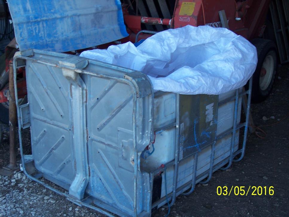

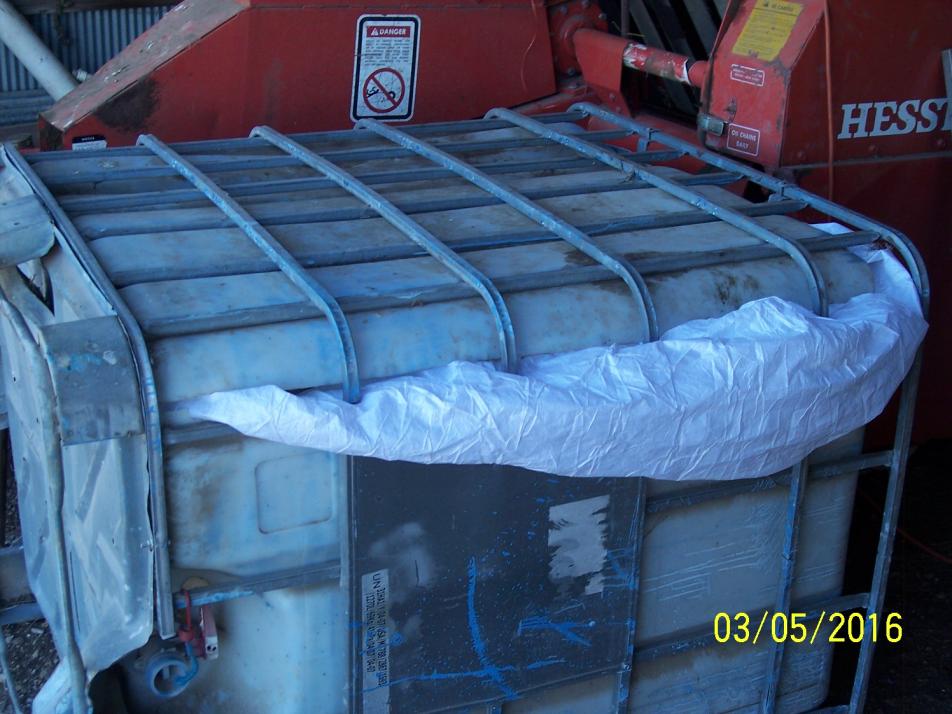

I get feed in bulk. I modified a metal tote to store it in. I laid the tote on its side and cut the metal and plastic. Used metal screws to reattach the plastic to the sq. tubing. Added two hinges (with screws) to what is now the top to allow feed to be enclosed completely.
Just unloaded a bag yesterday. 1485# set on wooden pallet. I pick up the bag and drive my truck off, then place into the container. Those bags JUST fit!
Many feed stores will load a container to what ever the customer wants size wise.
This store has a feed truck off load into the bags and they have various amounts in each bag. I didn't call and order, I just went in and got what they had. This bag has protein pellets. They're pretty dense. My metal tote is full at #1450.

A few more pictures.
It would be pretty easy to shorten the metal frame to any height needed. Or to put hinges and latch on a side and leave the top off.

Sheepfarmer, yes my tote stays in the barn. It takes about $5-$8 of hardware to make. Just two small hinges and about 20 sheet metal screws.
You can get an idea of the fill hole. It is on the side by the orange baler and you can see the ext. cord in the picture. Big black lid.
On the side (actually the bottom) is on the left side you can kinda see where the drain is. If you mentally rotate that picture counter-clockwise 90 deg. the tote would be how they are used when filled with liquid.
I took a picture of the empty bag and then one when the full bag was in it. All the bag fits under the lid by the time I leave the barn, with a bungee cord as a "lock".
Just as a thought, these totes will fit between the fender wells of a pick up (you can see the tote on the pallet in my truck) but I do not think you will be able to haul one if you have a topper on your. Better get a measurement before traveling too far.
