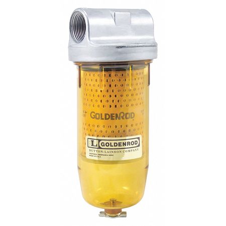

I use the Goldenrod 496 water-block filter system. Ibought it at TSC but amazon and many others also carry it:
Geo I saw this on line. I still wonder about the water freezing in the bottom. Your in Texas so I guess you dont have that problem? The tank is close to the ground. That filter looks a little long! I guess I cold remove some earth beneath the filter! Looks like it will use the old oil filter fittings?
Firstly, I’ve had that filter installed for over two years now on an outside storage tank subjected to temperature exgtremes (from 100+ to 17-F and never found water in that filter canister. This is likely because if water is in my stored fuel it is likely still in the bottom of the tank and has yet to be picked up by the system.
However, if water WERE in the bottom it’d be quickly visible and I’d drain the canister.…and even if I was lazy and/or missed it… there is sufficient room to allow it to freeze without blocking or breaking the container. It would likely first freeze the drain plug and prevent it from opening…but in any case the water would be visible and at the bottom of the canister…still below the filter media and below the exit point of the system.… so if that occurred…. I’d simply either wait until it warmed up and drain it….or unscrew the see-thru canister and dump it out.
BTW, the 496 filter media is different from their 495 filter media…in that it prevents passage of water thru the media. If water in such large quantity ever collects so as to reach the media… it would not be allowed to pass. (Their 495 media only prevents passage of particulates.).

If your concern is the Goldenrod (with the drain on the bottom) freezing, I have used that setup for over 30 years and never had anything freeze in it.

Well with the lack of room, tank is close to the ground, I wound up getting the goldenrod 596 spin on water block.
