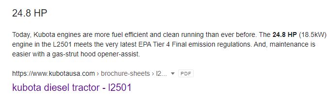

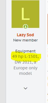

UMMMM, your L1501, what did you do to it?
Did you bolt a V2403 Turbo in it?
Because the last time I checked a L1501 was 15HP not 49HP.
I think that Kubota are inconsistent with their model numbering. Usually, the first 2 numbers after the L or M etc refer to an approximation of the HP (rounded up of course, but then they would, wouldn't they). With the models in the range where mine sits, it's the 2nd. and 3rd. numbers which indicates the power.
The L1 range was produced between 2018 and 2021. These models have been superseded by the L2 range.
Mine doesn't have a DPF, thank goodness, but the L2501 has plus other refinements. I'm quite happy with mine, particularly as I got it at a good discount as an end of line model.

I'm still really confused?
Your Equipment Description reads L1501, is it supposed to read L2501?
And if it is an L2501, someone's feed you a line about the first 2 numbers not being the HP.
And even with the change to the L3301, L3901 to L3302, L3902, they are still keeping the L2501.
The reason the L2501 does not have emissions equipment on it is because it's below 25HP.

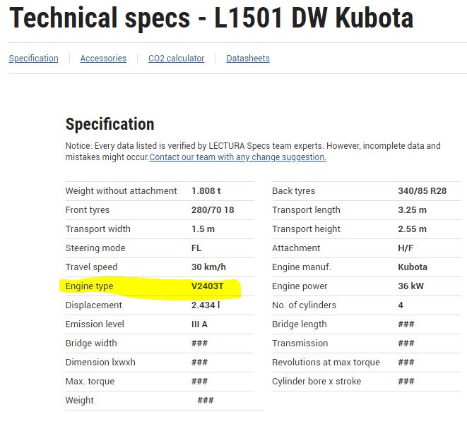

No my friend, you're talking American. My L1501 DW is an European model. Kubota are inconsistent with nomentcular. The L2501 over here is an updated version of my L1501
34,088
9,280
My sincerest apologies! 😔
I was not aware that Kubota had lost their ever loving minds! 🤪:unsure:o_O
Your L1501 DW does not match anything we have here!
It's a much bigger Engine than the L2501
I would say the different model lines are because of emissions laws???
It's really going to confuse the living snot out of a lot of people down the line!
I will say this, I was spot on with my guess at which engine you had in it! ;)
