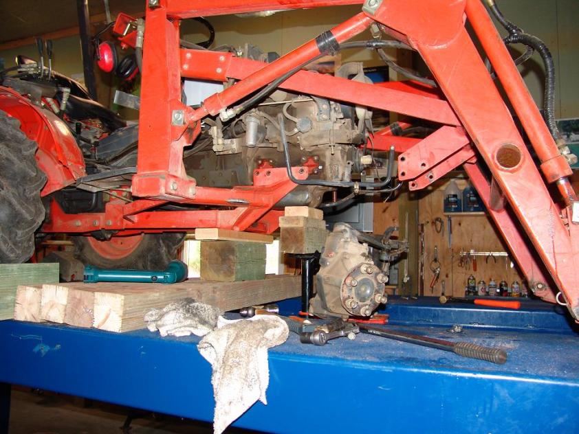

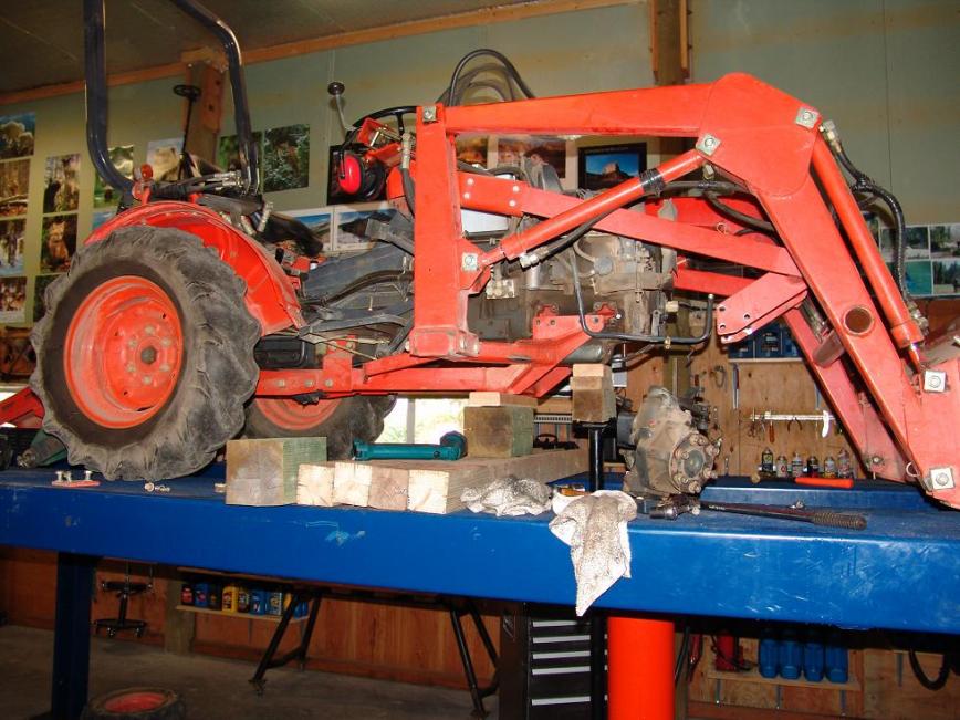

Hi again
One more question, a few comments and more pictures of my disaster
I never did get an answer regarding my question if I needed to remove the engine to get to the broken part
Figuired out you do NOT have to remove the engine
It was actually very easy getting the frame member off the tractor
Check out the pictures

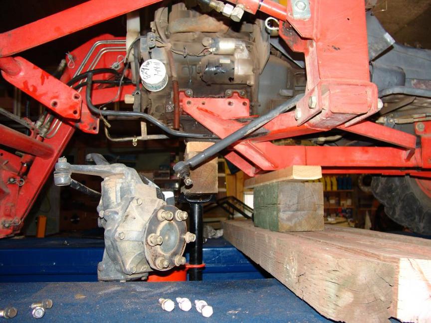

Question??????????
How much play should that shaft have in the mount?
It wobbles a bit more than I would expect
Looks to me like a new part rather than a weld job - Darn I was looking forward to getting back into welding stuff

Is the bore for the bolt worn or is the bolt itself worn or both, If it were mine I would weld the part then if the bore was too worn I would either ream it out and tac weld a bushing in place and if the bolt showed any sign of wear I would probably replace the bolt. Weld it up and add some fish plates to strengthen it and save the $350 for some other items on your tractor wish/need list.
KJINTF
B7100 & ZD326
May 7, 2011
23
Western Montana
Thanks
Both are worn plus the bushings inside the axle itself are shot
The little thing only has 860hrs on it 100% my back side in the saddle
I guess I was remiss in the TLC the little thing needed
Cleaned up the broken part and looks as if it's not worth repairing
Both bolt end and hole in the broken part are worn and show signs of heat / stress related issues
Right now my thoughts are to pay the price buy a new part and be done with it.

Never would have thought that part would crack, but would expect it wear in the pivot pin holes. Glad at least the problem was found. You must have missed my post on not removing the engine.
beemer
KJINTF
B7100 & ZD326
May 7, 2011
23
Western Montana
Thanks - beemer530
Yes I missed it because it was referencing a different model
Mine was similiar and the 8 bolts on either side with a transmission jack support under the oil pan worked just fine. That front axle assembly sure does weight a lot, I tried to lift it out of the way and gave up letting it just sit in place.
