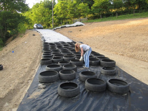

The idea is solid. No pun intended. There is a product called Geocell that can be used under gravel drives. Considering a high traffic drive should be 12" of gravel, the depth of the tires isn't bad. Although I prefer to use #1 or #2 stone as a base layer. For the soil around here anyway. If I had kept all my old motorcycle tires over the last decade I might have had enough.
Mark_BX25D
Bx25D
Jul 19, 2020
1,993
1,500

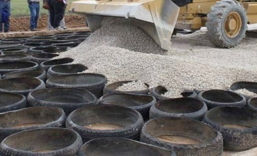

Seems like that would take a WHOLE lot more rock than doing it normally.
The idea is that you do it ONCE and done. It doesn't go anywhere like a regular gravel driveway will. Plus, it will handle way more heavy traffic.
That and the geotextile should keep it in place. I trenched alongside my driveway a few years ago, and got a nice cross-section of it. Gravel down a good 18 or more inches and it still needs new gravel from time to time. It just keeps migrating down. And yes, it also goes sideways out into the forest on one side and the lawn on the other.
I know about the geocell, but the tires are a new one on me. I'd be interested in seeing the long term durability. Tires are a problem in landfills because their shape and flexibility cause them to wiggle their way to the top. That's the reason our local landfill won't accept them unless they are cut into quarters. I'm wondering if the same problem would happen. But maybe with the sides cut out that doesn't happen?
Anyway, the chemical leaching is still a factor. I remember reading about the issue that motionclone mentioned.

Neat idea, but I'm wondering how well the tires would stay in place in a frost-prone area.
