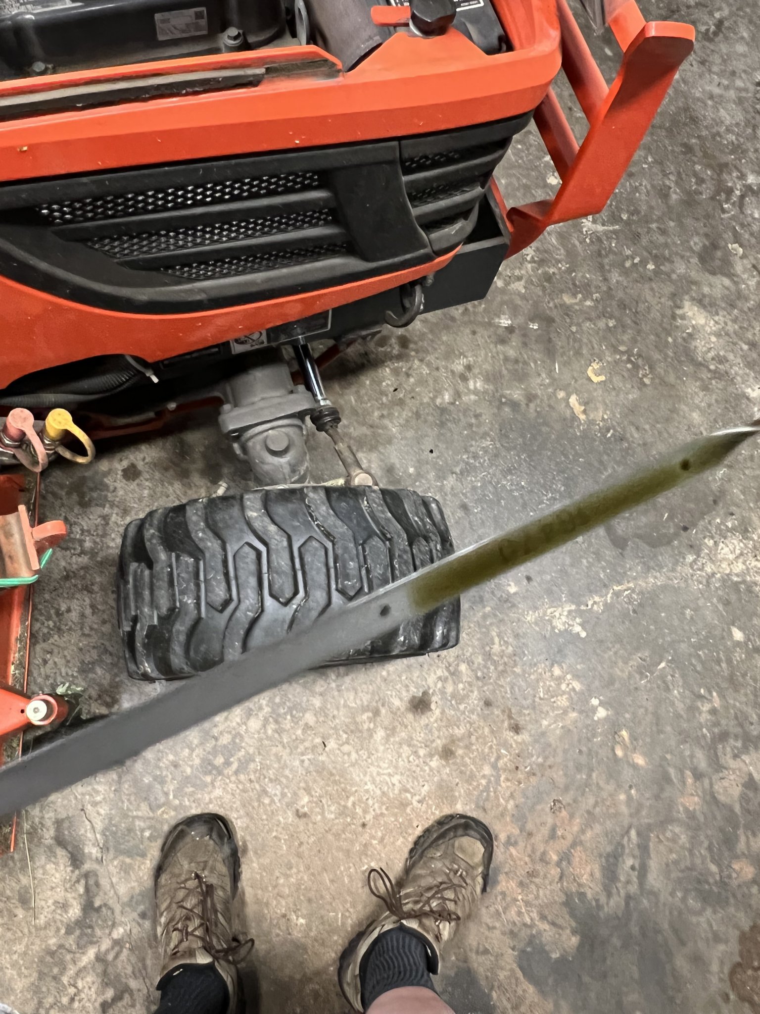

This is the stick from my 9 year old BX2360 with 460 hours. Rotella T6 5w-40 with 20 hours since last change. While darkened a little bit, it’s still quite clear and light. Picture doesn’t do it well.
I change oil about once a year. Usually amounts to 50-60 hours, but it could go much farther.
