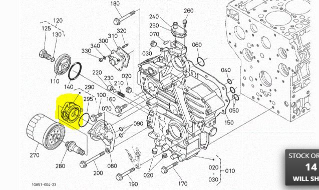

North Idaho Wolfman, Sorry, but that statement isn't true!
As far as Messicks/Kubota parts layout is concerned, the MX5000 has a water cooled oil cooler, and if there is corrosion or other problem with it, I would expect oil and water could mix together easily.
I'd certainly be looking at it before tearing anything else down, even if it isn't a known failure point.

MX5000, you could bypass the water lines with a joiner for a start, it doesn't need a cooler while you are not working it hard. It's possible you could remove altogether and get a threaded nipple to just put the filter back on, I expect it's just an add on on that engine. You can also get a pressure tester as mentioned, or a combustion gas tester like this one.

After looking at the oil cooler last night. It seems that the water lines are not even connected as there are two male barbs with no lines to them. Does this seem right to you guys. Also when you remove the dipstick while the engine running oil will spray out. Not sure if this helps

(heat exchanger inside the radiator).
Actually it's heat exchanger on the side of the gear case, that runs water through the plate around the oil and then water into the radiator.
I think the OP said the water line has been removed from it, so that would eliminate it as a cause. ;)
