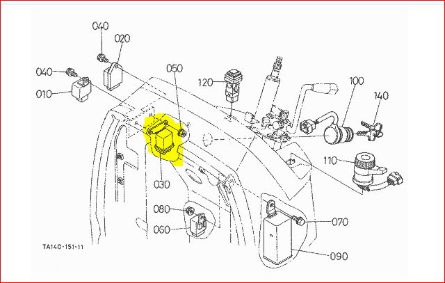

just checking to see what is the first place I should start, the glow plug indicator light on the dash does not come on when key is turned to first click. took panel off and checked bulb and it is fine, I don't think the glow plugs are working, tried leaving key on then checked plugs no heat.
34,447
9,699
You will need to pull the dash to get to the glow plug relay and check that it has power in and out, also check the fuses.

Wolfman is right on, as usual. The GP controller is a common problem. That was my first part failure of any kind and happened around 1150 hours on mine. About $70 at the orange tractor dealer. That diagram should help you. If I were you and the fuses are ruled out, I would just pick up the GP controller and replace it and you'll probably be done (since you will have pulled the dash loose anyway. There is a temp sensor relay also but try the controller first.

Can you clarify something for me, I ordered the part #030 as highlighted on the diagram. it was discribed as a gp relay, in that reply but in another reply it was called a controller, did I order the right part.
the lady at the parts dept. advised the relay was #020
#030 was $71.00 and #020 was 30 something.

020 is the GP controller
030 is the GP relay
34,447
9,699
I said that you need to check for power in and power out on the glow plug relay, I don't know if it's bad without that test.
If #30 has no high amperage power in then you have a fuse or wiring problem.
If #30 has high amperage (larger wire) power in (constant hot) and low amperage power in (signal from #20) when key is turned on and no High power out to the GP's then the relay is bad.
If #30 has high amperage (larger wire) power in (constant hot) and NO low amperage power in (signal from #20) when key is turned on and no High power out to the GP's then the controller #20 is bad.

thanks for your help Wolfman and KingCreek, replaced the controller and I now have glow plugs. -19* here right now with a wind chill of -30*c tractor strarted right up
