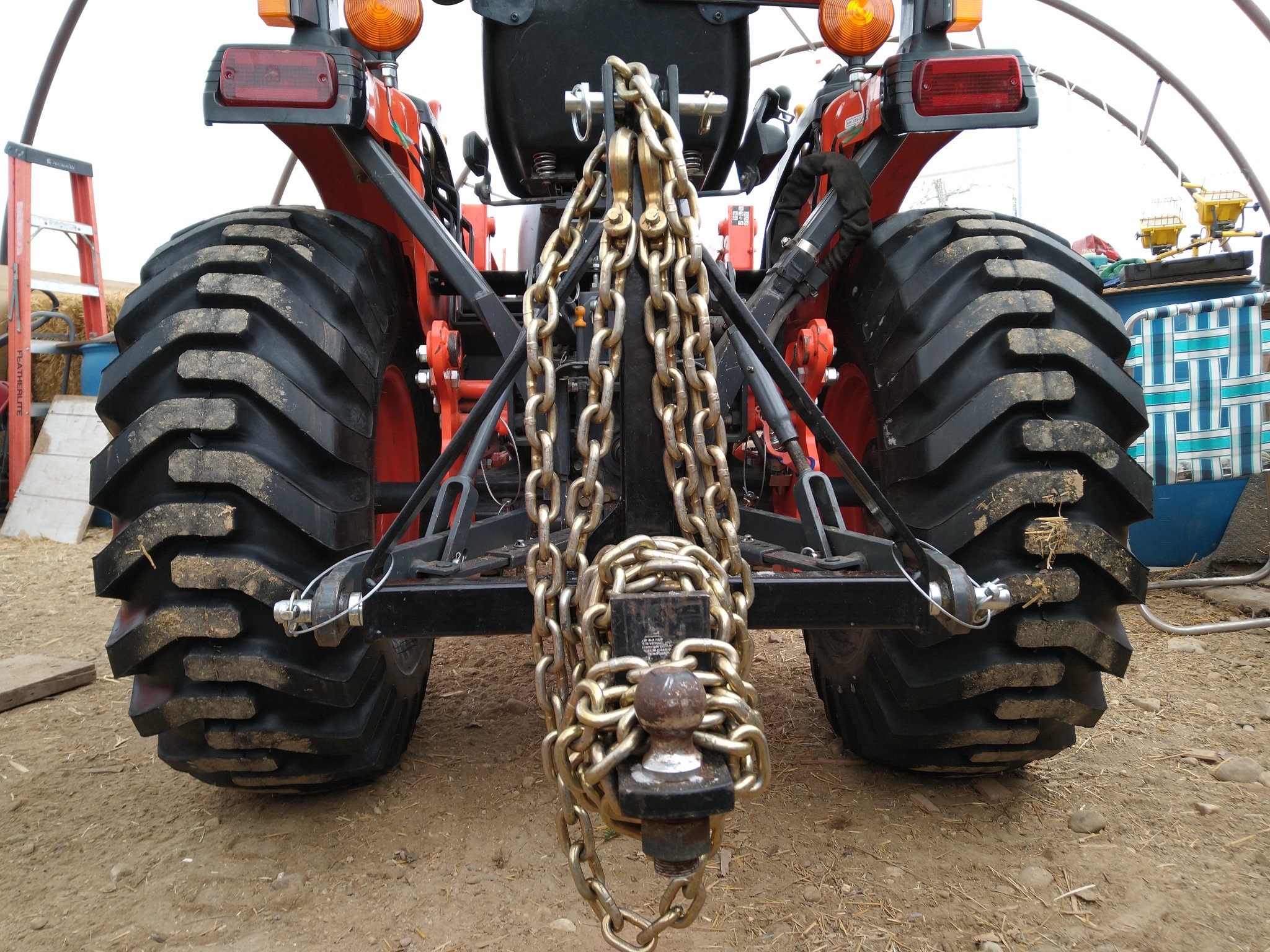

Unless there's longer term ongoing fence-building planned, like for livestock areas getting fenced over years as you adapt your lot, try and rent/borrow a 3-point post hole digger for one-off fencing. They're a lot to spring for for just a house yard or two worth of posts.
For log skidding I use a 1/4" hardened chain and a 3-point trailer hitch 2x2 receiver frame with trailer hitch and ball installed. Great for trailer moving too.
That's a 3/8" chain in photo, since got a 1/4" for ease of handling and put a hook one end and slip the other.

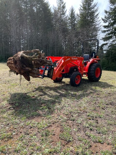

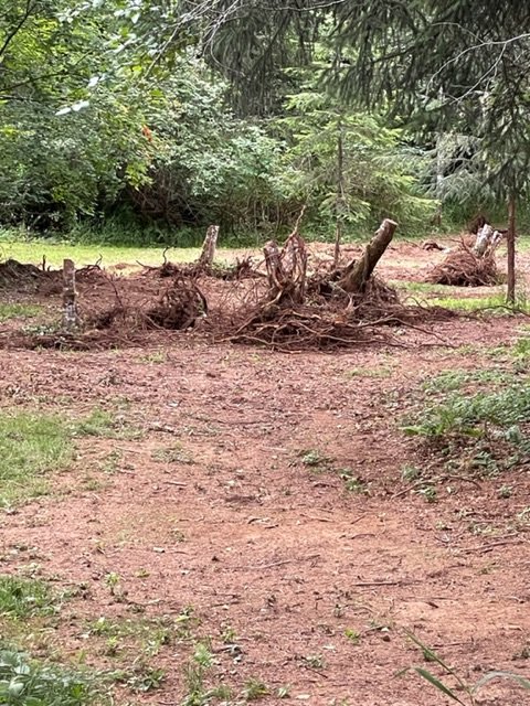

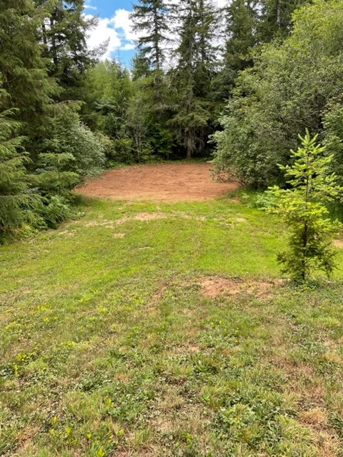

You can definitely get the job done without a grapple and a stump grinder. I got these jobs done with my L2501, a chainsaw, loader with bucket, loader with pallet forks and a box blade;

Thats pretty impressive .. I wonder how long it would take me to yoink my first stump with that set up ..

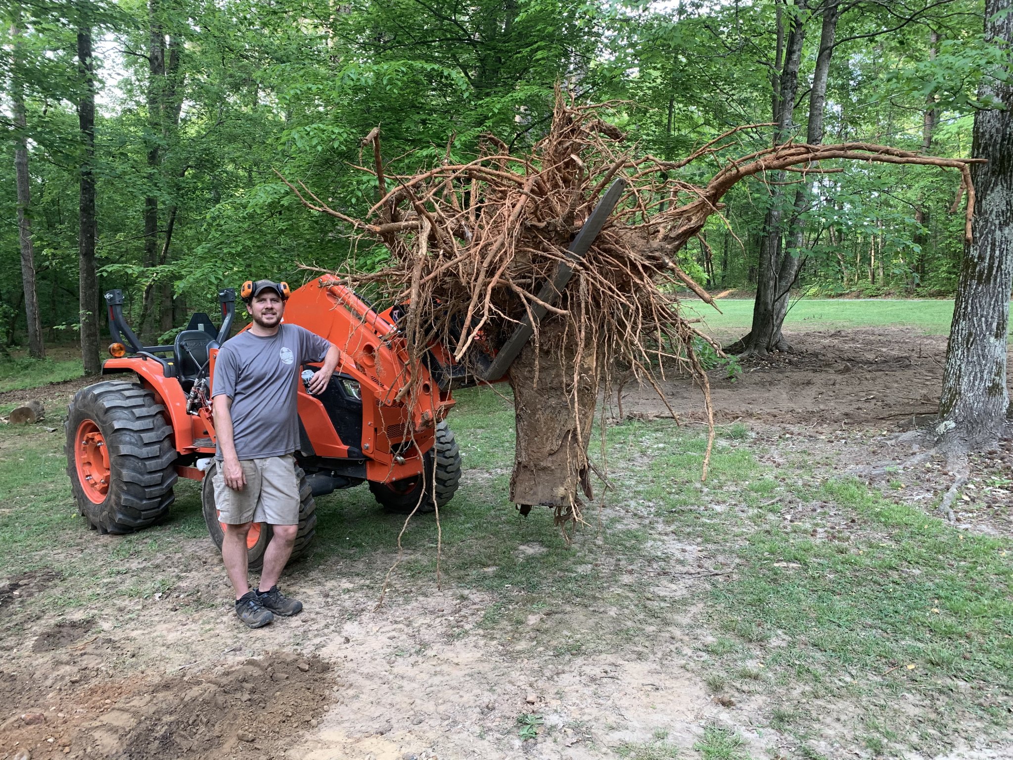

I’m about 6’2.
I always suggest MX, but seeing your property I believe that’d be overkill. I had an LX2610 before the MX. That’s a great little tractor. And I sometimes miss it on my 2ac, but then I take the MX across the street to the 80 of my FIL’s and forget about it. Lol.
This is the same stump from above, with LX pushing over the tree.
I think an LX would fit your property nicely.
Thank you. Not long. I cut the stumps a bit tall so I can have additional leverage and use the loader with bucket to loosen the stump from the ground. Once I get the stump loose, I use the bucket (sometimes the pallet forks) to lift the stump out of the ground. Works great. But, you need some tractor weight to do it.
