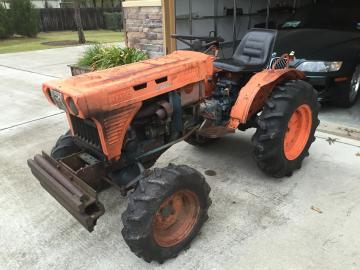

Hi guys, first post here. Last week I picked up a locally listed B7100 that is quite possibly the ugliest tractor on this site. Based on what I've learned the past few days it is most like a gray market 78 model. For the past 5 years it's seen only light mowing duty at a Christmas tree farm in Houston. Prior to that I have no idea how it's life was spent, but based on it's looks I imagine it was a hard one. A month ago it stalled while mowing due to fuel starvation and the seller wasn't able to get it going again. I tried a few times myself last week to no avail.
Since then I've removed and pressure washed the tank in and out, installed all new fuel lines from the tank to the injector pump, changed the fuel filter, replaced all 3 glow plugs as only one worked under power and tested the system beyond the lift pump with fresh diesel.
The seller had attempted to bleed the system at the lift pump and one of the delivery valve holders was loose closest to the firewall. I suspect breaking the union nut loose with only one wrench was the cause and I had to pull the other two just to get a crowsfoot on it. Decided new o rings were needed for all three that delayed me for a few days. Furthermore, 2 of the injectors could be turned by hand which concerned me.

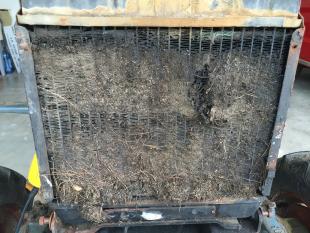

Anyhow, no oil in the rad or water in the oil but probably 10 pounds of crap in the rad fins once I pulled the grill. One more part to pick up before I attempt to start tomorrow. I don't plan on pulling the injectors for testing until I see if it will start based on what I've done so far. It really needs tons of work but I only plan to drag a box blade for driveway maintenance once in a while if I can get her running again on the cheap.

Welcome!
The B7100 was not a grey market tractor.

Thank you. I thought it may have been based on what I've read as it has no ROPS, PTO guard and has a 3 speed PTO.

Based on your pictures of the radiator, I'd say the previous own just neglected it. Probably removed all guards for whatever reason, who knows?
Looks like your rear wheels are set in about as far as they will go. You can move them out easily if you want a wider stance.

Haha thanks D2Cat! Hopefully after my next parts run to Kubota this afternoon I'll get her chugging again. The hours meter was replaced with a temp gauge so I don't know how many hours "Krusty" actually has. I just hope the injector pump and engine are in good shape. She was puffing white smoke when I tried last weekend so I think that's a good sign.

Check to see if your fan blade is reversible, this helps keep the fluff out of the radiator.
The blade on my B7001 pushes air away from the engine.
Unless you change the fan you can't reverse it.
Are you sure your's pushes through the radiator?
If it does, then someone has installed the wrong fan blade. ;)

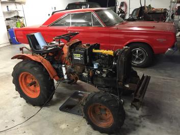

Krusty LIVES! I buttoned up her plumbing and bled, and bled and bled. After several attempts and a few false starts she finally sputtered and spewed out clouds of nasty smoke. I'm sure a combination of air and old diesel has a lot to do with it. More reading tonight and some fresh oil tomorrow to start. Thanks for the advice so far. I need to burn my clothes now.

So what's the secret to getting the threads started on the Hyd Screen Filter Banjo Bolt behind the right step? Bottle jack, prybar and swinging 1 pound wrench on my back while covered in hydraulic fluid just isn't working.

If your having that tough of a time it's probably bent, Try loosen the other end of the line and any clamps on the way. ;)

Thank you. The line relaxes about 1/4" longer than needs to be. A one inch ratchet strap looped around the aft part of the line then around the front axle helped it shrink while a bottle jack raised it to the right height. Least favorite job so far lol.
