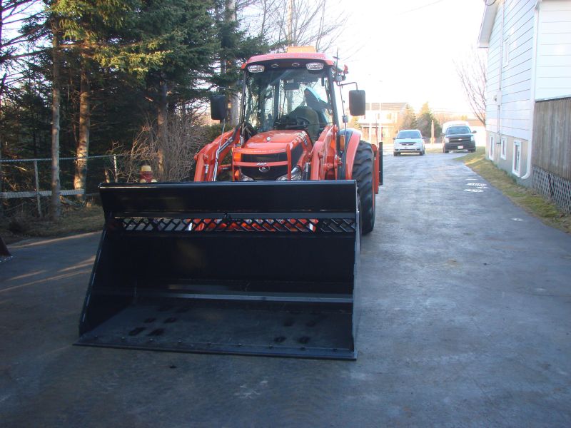

Been awhile since I've been on here. Shop has been busy plus we've had a lot of snow. Now that winter is over I figured I'd get ready for next winter. I ordered in a new light material/snow bucket for the tractor. I've had to move a lot of snow this past winter and with the smaller bucket that came with the tractor it meant many hours in the seat so I decided to double up the size and ordered the bucket.

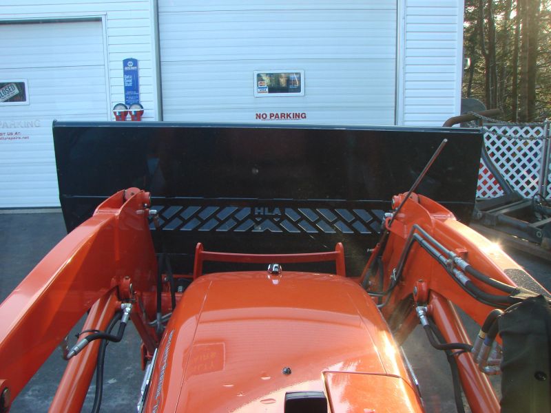

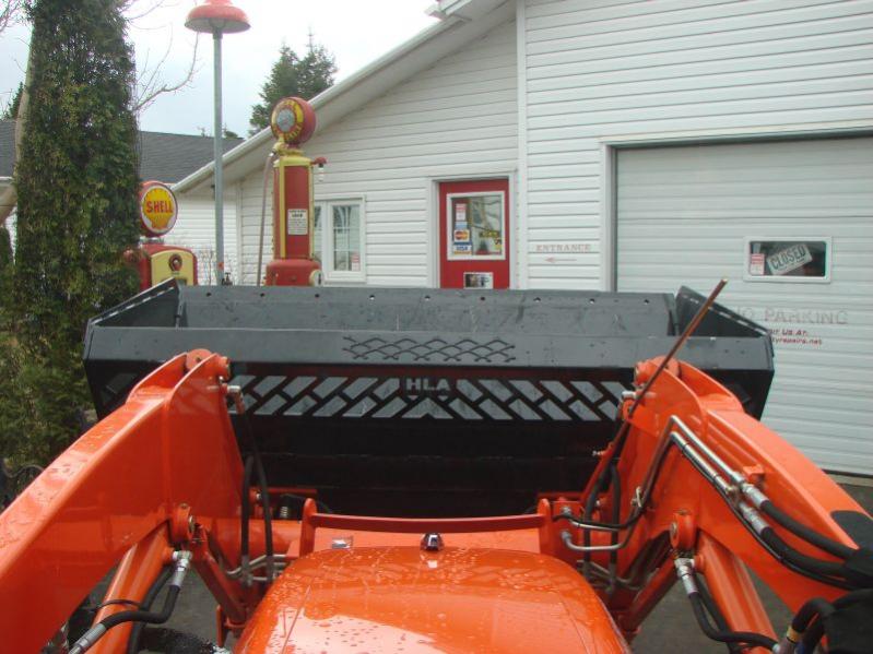

I got it last week but I wanted to add a waste guard. when these buckets are curled right back it can dump snow on the hood of the tractor or even brake the windshield out so my job to day was to fabricate the guard. Add a hook. Make up a cutting edge. Well it's not really a cutting edge but a stiffener for the bucket and I also added a couple of pieces of 1/2" flat bar to the under side of the bucket as well. I'll hard face the "cutting edge" later on. Here's how it went.

Thanks for the link. This bucket is Canadian made by a company called Horst. It looks well built. I just felt I could stiffen it up a bit more by adding to it like I did. I won't know how well it will work until next winter. We still get some snow but it's usually gone by mid day. Happy Easter.

Pat years ago while operating a 966 Cat loader I had a lump of snow come down off the bucket, it took the windshield out and cut my arms up pretty bad so that's why I do this type of mods to my buckets. It do help. This new snow bucket weighs in at 655 lbs and is 35.1 SAE Heaped Cap. It works out about double the size of the regular Kubota bucket. As I've mentioned above. It will only be used for light snow and only to move snow. I will be adding wheel weights as well in a few weeks just in case there needed. Thanks for posting.
