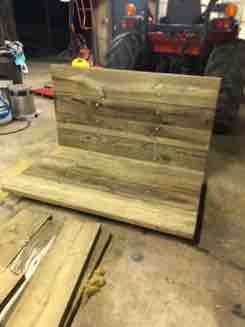

Built a carry all. Bought the frame from tractor supply, $165. Then got my lumber and bolts from Lowe’s, $100 or so. Used 1/2”x 3” Carrage bolts with flat washer, lock washer and nut. I had tried a lock nut at first but due to not being able to hold the head of the bolt... it would just spin the bolt when trying to tighten. So had to change that.
Starting with the back wall of it from bottom to top I used 2x10, 2x8, 2x8, and another 2x10. This put the back wall just about an inch over the top of the frame.
I used the same board setup for the floor. The first board butted up against the back wall board. I couldn’t do the floor first because it would not have allowed for the bolt holes to line up correctly.
It is 5’ wide. I plan to add sides to it and a 2x4 across the front for a lip to prevent anything from sliding out the back.
With time I may add a chainsaw holder, some other add on storage stuff like a small removable shelf, shovel holder, chain storage... not sure yet. Will adapt it with time! IMG_1266.JPG
