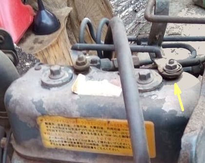

The rod in the panel that releases compression connects to a pair of linked levers on top of the valve cover. On my tractor, the first lever was mangled and assembled with the spring above the link instead of underneath where it clearly belongs. I took it apart and repaired the link, but when I started the engine after that, it no longer ran nice and smooth. It took many attempts to start before it caught, and then it smoked horribly grey smoke that filled the yard and kept dying. (Before, it belched a little black smoke upon starting, then the exhaust was clean and it purred, er, uh, little bulldog growled...)
I probably turned the screw with the nut (see picture) when removing the link before I realized it was an adjustment and not just a hold-down. I haven't found any reference to that adjustment. Is it an important or sensitive setting? My plan is to drain and replace the fuel, (the new filter will be here soon,) and that's an obvious step to take, but it ran so nice with the same old fuel several times before now! Eventually I'll pull the valve cover and adjust the valves as described in the manual, but in the meantime, I'm clueless. Any advice would be deeply appreciated.

If it ran before, my guess is that when you moved the spring, you moved the compression release causing this.

Your compression release simply opens the valves to release compression. This was to let the engine spin over faster to heat up quicker for easier starts.
Not sure on your engine, but some Kubotas were adjustable through two plugs on the valve cover. You may have to remove the cover and see how that engine is adjusted. It's a pretty simple setup, so don't let it scare you. If you take the valve cover off you should be able to reuse the gasket.

You need to loosen it up, as it has too much tension on it, and it's holding the valves open.
That adjustment of the two has a spring in it to return to closed.
You really don't need the compression release option anymore.
Decompression devices on these older models were because battery technology was not good enough to offer enough CCA at spin up and for an extended period of time.
New battery technology make the decompression device unneeded.
