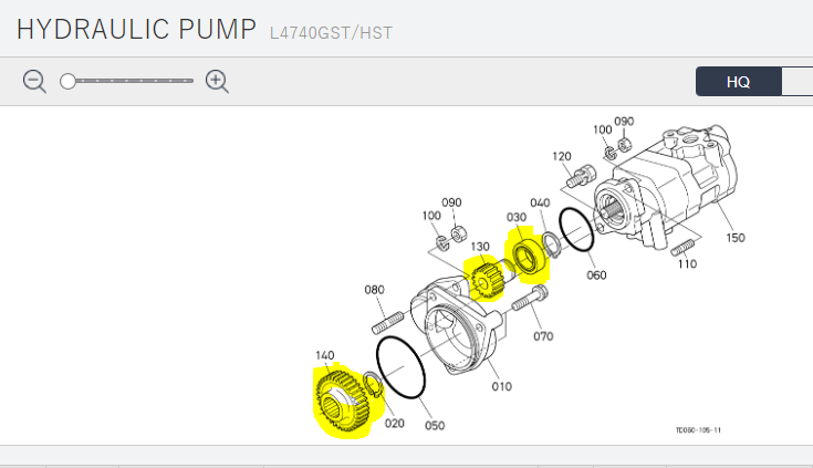

It's possible you have a bad bearing on the gear that drives the pump.
Or maybe bad teeth on the gears.
I replaced the pump along with all the gears and bearings (new o-rings too). I had to replace them, they were chewed up and missing teeth from the original pump breaking. I’ll make a video of the sound and post it. Thanks for the suggestions.
