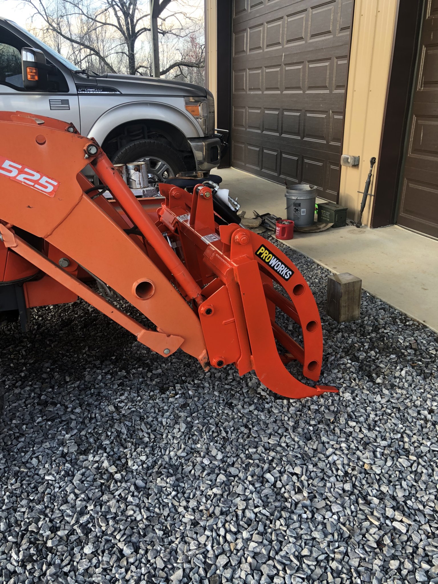

Just finished up adding a quick hitch adapter to the tractor. Went very smooth. Now I just need for the third function kit to show up so I can start using this grapple.
After I get that done, I need to have the new mounting plate for the loader bucket welded on so I can use that with the adapter.

Which adapter did you get? 3rd function?
It’s a ProWorks adapter. Bought it from SkidSteerAttacments in Huntsville AL.
the third function kit is a Kubota kit that I bought thru Summit Hydraulics in AZ.

I ordered a full mounting plate (center not cut out) 5/16" plate delivered off of Ebay for $129 about three months ago, but now they're up to $141 (but still not paid because it includes shipping).
I picked up a full mounting plate as well. i don’t trust my welding skills to competently do this job, so I’ll take the bucket and the mount to a fabrication shop to weld together.
