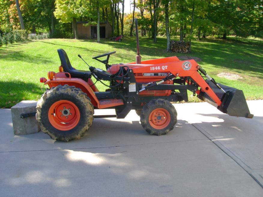

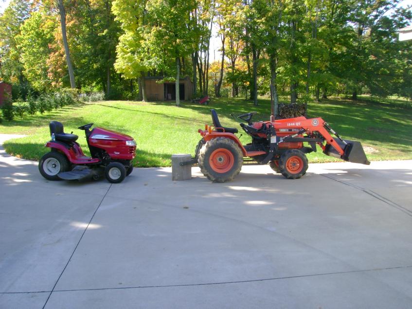

Just wanted to give a shout out. I can't believe i found this forum.
I just recently bought a 4X4 1986 B7200.
I have a Bush Hog FEL and a rear blade.
Its got 1300 hours on it.
I paid 4500 dollars for the tractor , including the FEL and the rear blade and counter weight.
The first thing i did after getting it home was an oil and filter change , topped off the Hyd fluid. Changed out the front axle gear oil and the oil in both differentials. Also replaced the fuel filter, and installed a new battery.
The only problem i have really noticed is that the rear lift bleeds off over time. Ive heard this is normal, would you guys agree?
I love my little Kubota.
Here are a few pics of my little beast.
