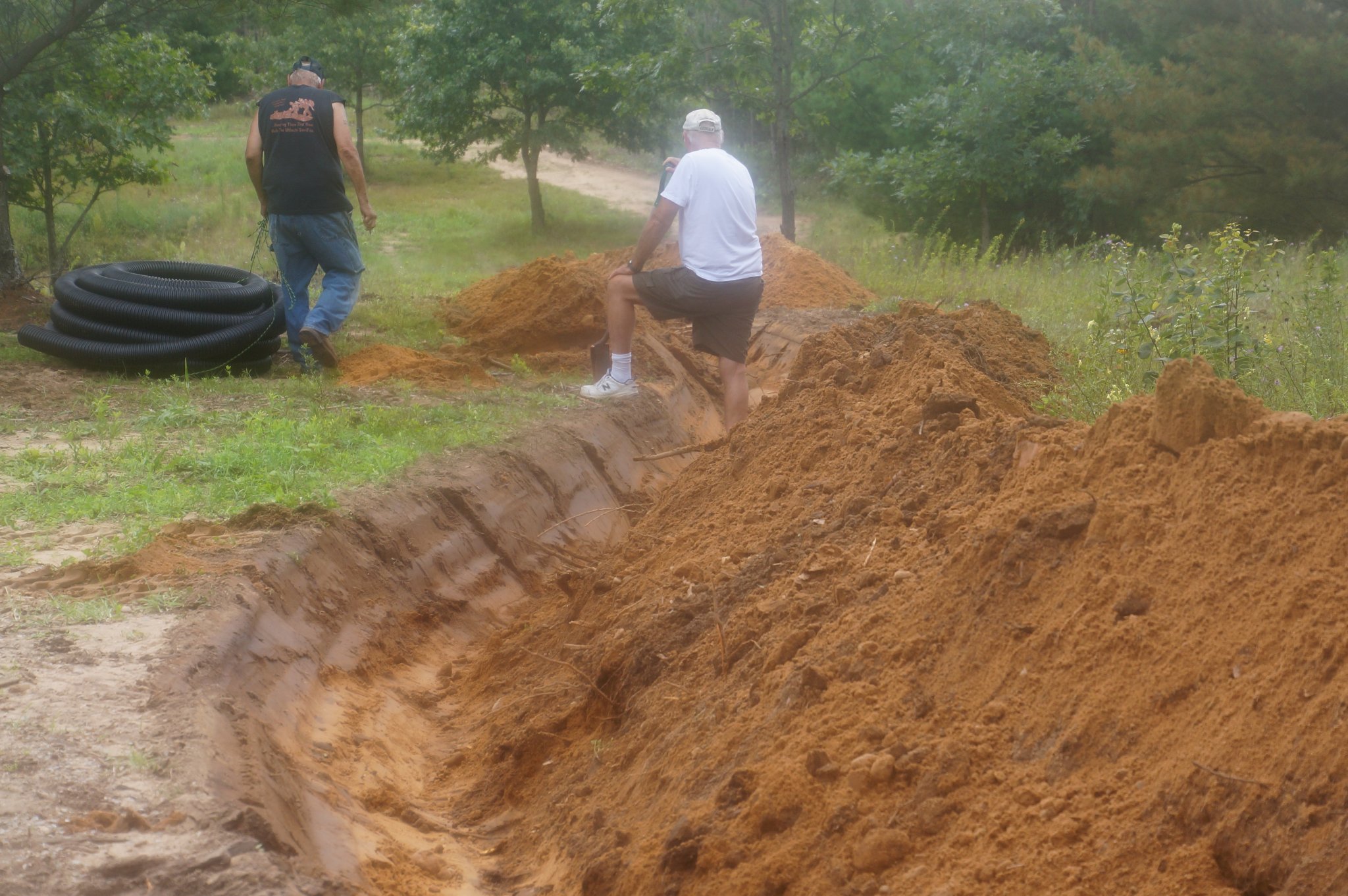

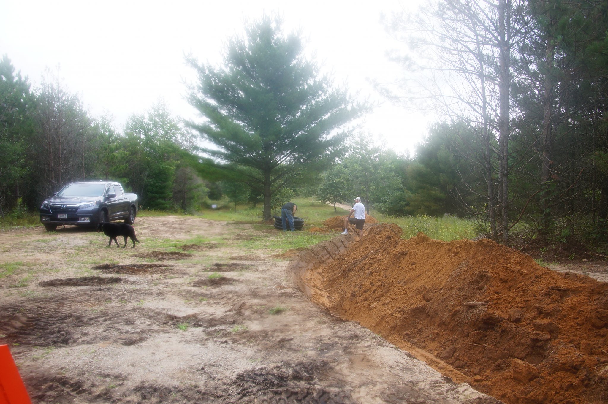

Couple of pictures of the ditch I dug with the L2501 and bucket. No tooth bar but I would like to try one.
I have always felt that I have a pretty good handle on what is working a machine as designed and what is 'abuse". In no way did I think I crossed the line into abuse when digging this ditch. Granted the L2501 is a larger machine than your considering but if your buying a loader tractor regardless its worth giving it a shot IMHO. If you feel its not up to the task, rent a back hoe or track hoe. Good digging! :)

dirt ? you got DIRT under the grass ?? !!
neighbour 1000' away IS the 'terminal moraine' up here..sigh, rocks, boulders, stones, sand and yeah some dirt....it was a very sloooow process to move some of it with theBH on the BX23S.
13,008
4,390
Looks like Ken is digging through an old garden spot. Not a rock/pebble in sight! I do see a couple roots though. :)

My property has somewhat of an interesting history. Geologically located in what is known as the central sands area. Late 1800's to about 1930 was a diary farm. How they made a living in this sandy soil is beyond me. Sometime after WWII a Christmas tree company purchased the land, planted/harvested non-native Scots pines. It was sold in the early 1990's then sat fallow till 2017 when I purchased it. I have about 5 large rock piles scattered about that contain some pretty good sized boulders. I would assume either the farm family or more likely the Christmas tree operators piled these rocks up. My land does have quite a bit of topography and is located near to glacier terminations. There is a hiking trail being built in Wisconsin that is called the "ice age trail" and I have been contacted to see if I wanted to give easements though my land.
