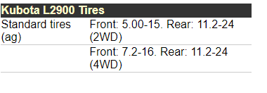

I don't know diddly about the L2900 but a lot of tractor websites are giving the front tire size of a Kubota L2900 as 5.00-15
Whether that is correct or not, I couldn't say.
What does your manual say?
How would this size (if correct) differ from a Carlisle Farm Specialist 7-16 R1 ?
Just more questions ! (LOL--sorry)

Those 5.00-15's are for a 2 wheel drive L2900 - shoot, you can place ANY tire that fits the rim on that.
but for 4 wheel drive -

Fair enough. (nice catch) I'll change the question (slightly)
How do 7.2-16's compare to the Carlisle Farm Specialist 7-16 R1 that came off it?
Someone else can do the math this time as I don't know this machine whatsoever.
I am sure there's a % tolerance built into the operation there somewhere
