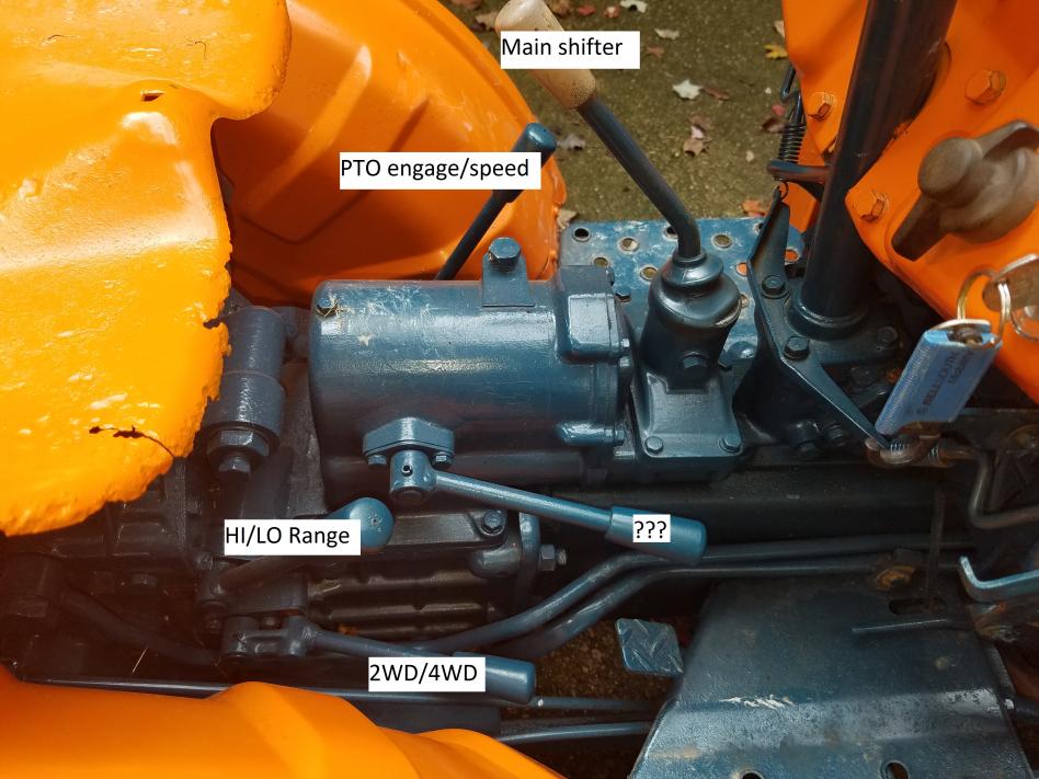

Hi folks...I'm joining your ranks here, just picked up an old Kubota B6000 with Front Loader last night.
I've got what's probably a silly question already...what does this extra lever do? I found and downloaded an owner's manual, and it doesn't show this lever. See the pic below...

Does it reverse the PTO direction?
Did you try it? Press in the clutch, throw the lever, and gradually release the clutch and see if anything happens.

Ah...now wouldn't that be nice (since the B6000 PTO spins the wrong direction). I will try it later today and see what happens. Is this by any chance that PTO reverser add-on that I've seen mentioned a couple of times? (UPDATE: I looked up a pic of that PTO reverser...that's not it, or at least not the one that was made by Hub City.)

Don't take this as gospel, because I'm just guessing.
Some older Kubota's had a creeper gear option, which is an extra hi/lo range selector, to get REAL slow for ground work/tilling, etc.
Maybe this is the lever for that?
If you search "creeper" here, it might show. Seems there have been similar questions before with pictures.
That was my guess also.

Any idea how it works (functionally, I mean)? Is it like the Hi-Lo range selector, except "Normal" or "Extra Low"? I saw in the post mentioned above that there may be a gear between 1st and 2nd on the main shifter that works with this creeper gear lever (something like "middle gear" on the main shifter, then hi creeper and low creeper on the creeper lever maybe?). I guess I don't quite understand how they work together. Any clarification appreciated!

You need to understand the purpose of creeper gears.
It is not to provide you with more force for heavy work. Use it like that and it will break and cause a big mess inside your entire gearbox.
Some farm operations require the machine to be moving much slower than the normal first gear low range. These creeper gears are only for low speed low load operation. I have not used creeper gears one so this is a guess. I expect it will have two positions on your unidentified lever in your first post so it is going to be like a hi low range lever.

Not all B6000 are gray markets. Some are north American models. Really depends on the serial number. Serial number plates are different between the north American models and the gray market models. All B6000 have the bass ackward pto ;)

One of my old 8Ns had what they call a Sherman transmission option which sounds like the creeper gear. I hardly ever used it over the 30 years I had the tractor. It really lowered the speed so you should be able to tell it right away when you engage it.

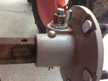

So, possibly another silly question...the rear stance with tires is a little narrower than the front. Front tire to tire from outer edge is about 40 inches wide. Rear tire to tire outer edge is around (didn't get exact measurement) 36 -
38 inches or so. (Rear tires are definitely a couple inches or so inside the loader frame and bucket, while front tires are a couple inches outside the loader frame and bucket.) It *looks like* I could flip the wheels around ("dish them out", as I believe it's called), making the rear stance around 42 inches or so wide (which I believe would be a good thing...wider will be more stable and possibly a little safer. Also, I added a quick hitch, and the hitch arms are within 1/2" of the tires now). Is there any reason I couldn't flip the rear wheels around to make the stance wider? Looks like the wheel actually sits on a ridge on the hub...I of course can't tell for sure if they would fit exactly right until I just attempt it (and I might need shorter wheel lugs, don't know yet). Thoughts anyone?

Check your axle for holes. The hubs should be adjustable for width.
