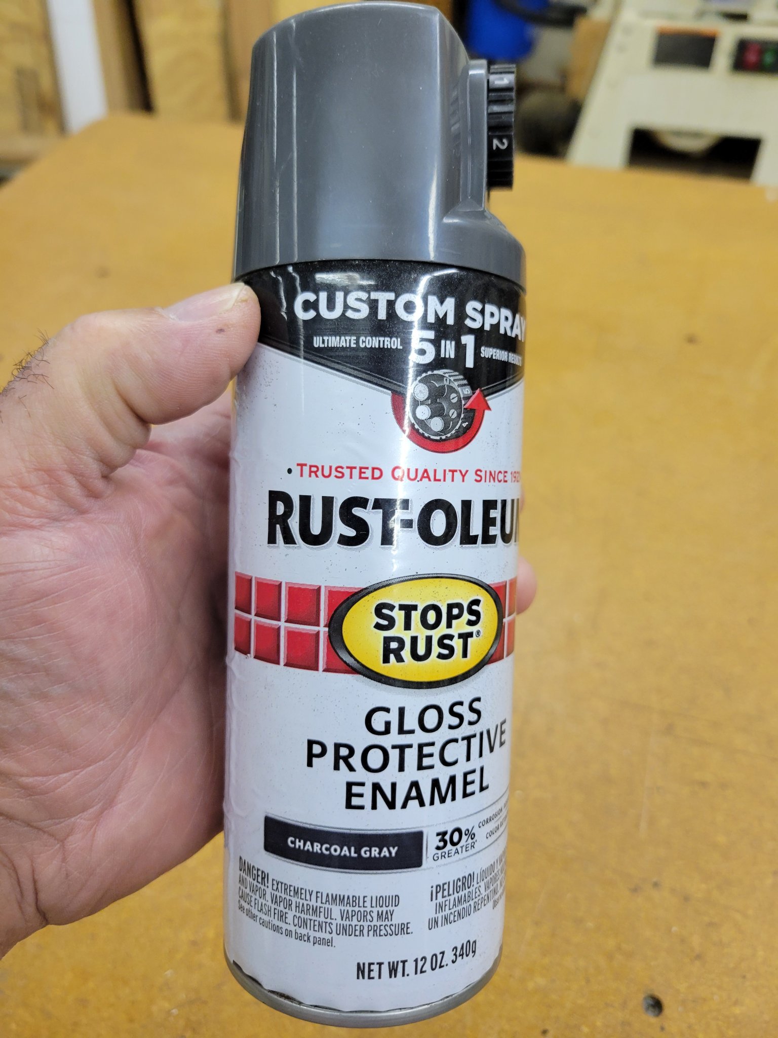

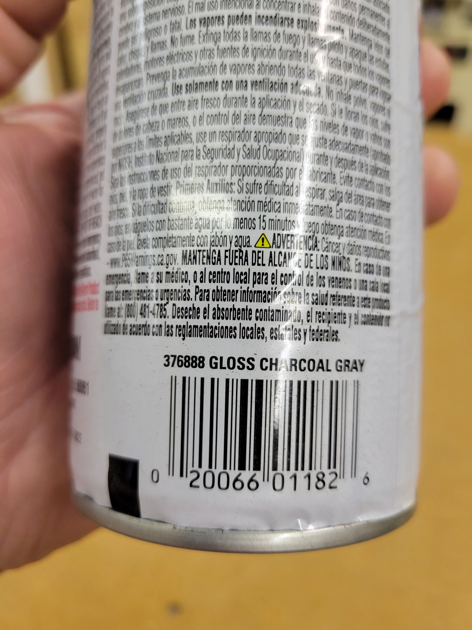

I buy Kubota filters only because the dealer is 3 miles away, they are reasonably priced, and I'm too lazy to cross it over to anything else. I paint the ugly white canister with a Rust Oleum gray paint that is a dead nuts match for Kubota gray so it looks nice.
It would be nice to know EXACTLY what rustoleum gray you used that was a dead nuts match!
