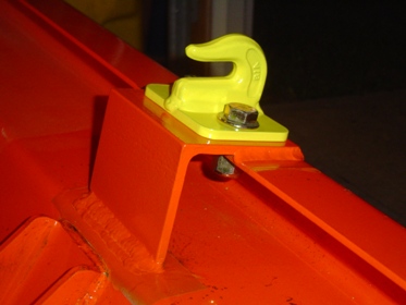

I made a bracket for the bucket lip on my B3200 60" bucket for Kenny's Bolt on Hooks.
I chose to use the bolt on hook so that if I wanted I could swap to the Bolt on Clevis Eye if needed.

I really like the way that looks. Too bad I don't know how to weld...

Nice job on your bracket. Looks good!
Welding skill is easy to rent. Print that picture, take it and the bucket to a professional welding shop, write a check. Done.
That's a 30 minute job for a professional and you're pretty much guaranteed that it will be done right.

Thanks. All truth be known, I really don't know how to weld either... I've never had any formal training other than dad showing me a little bit and giving me a pile of scrap to play with.
From a simple How to Weld book to all of the information on the internet it isn't hard to pick up and it is a fun hobby.
Thank you.
That is why I posted it. Copy away.

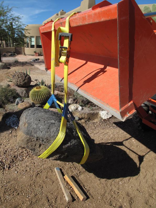

Bolt-on hooks are a great idea....

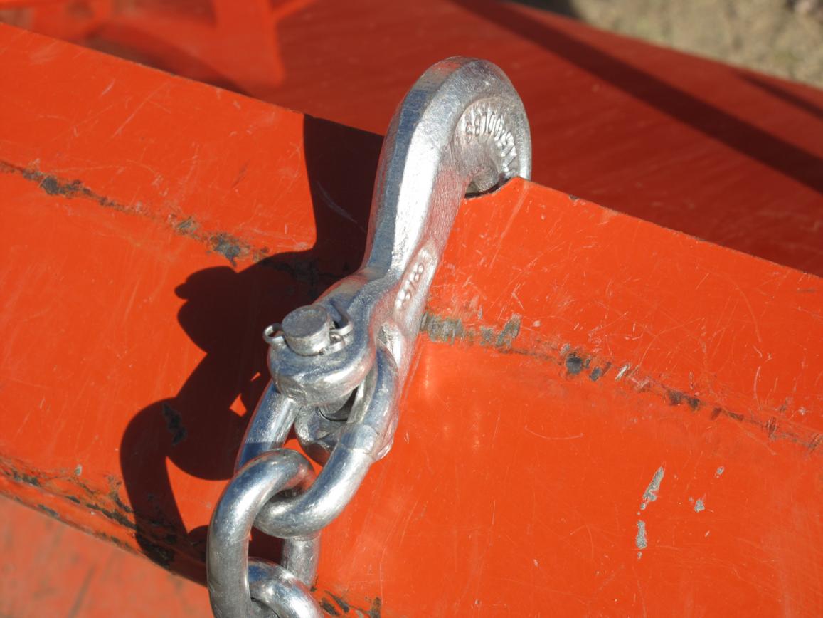

I have been moving boulders a bunch and use Harbor Freight 6000 lb straps and a 10,000lb binder strap. I use 14' HF chains with hooks attached to the same location to pull trees and posts out of the ground. NEVER hook to the lower bucket edge as you will damage or bend it. Always use the upper frame, like this...
Here's the chains...

Ray, did you grind that piece out of the bucket where your chain hook is located (your second picture)? I am wondering about the strength at that point and if you made that cut so that the hook does not slip when hauling a load?
