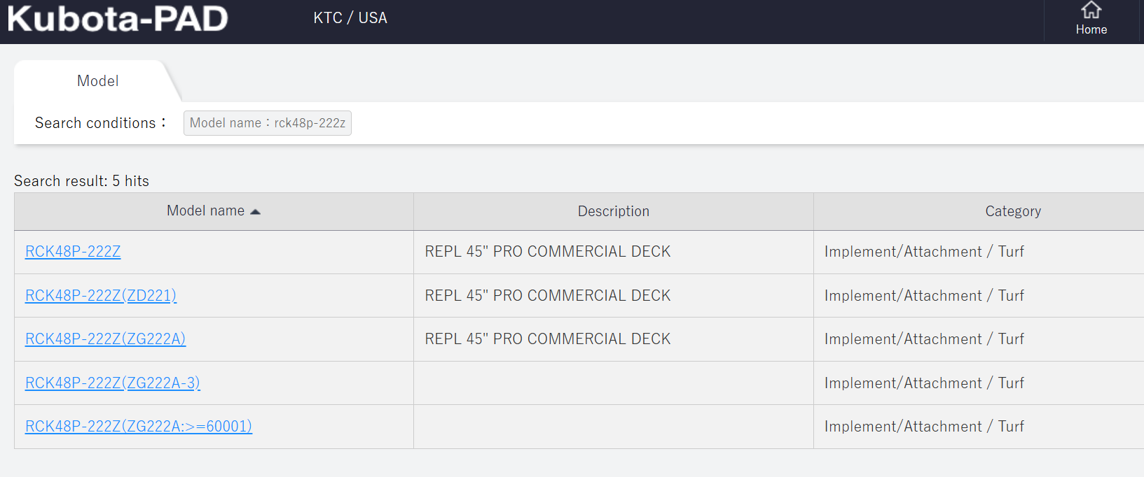

I used the Kubota parts site.
Kubota Tractor Corporation - Illustrated Parts List (kubotausa.com)
There's a bunch of ZG222 mower models.
Looks like each might have one or two mower models.
I DON'T KNOW IF THIS IS YOUR YOUR MOWER MODEL.

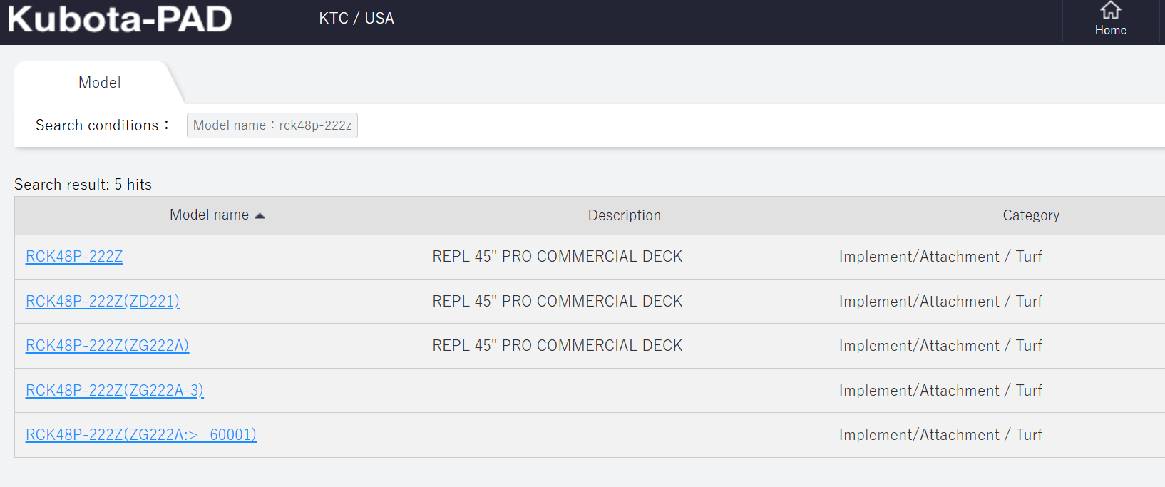

I only grabbed RCK48P-222 as that one was handy and there's variations of that - - check your mower model and go from there. Can likely search Messicks or Kubota site with your MOWER Model #.
