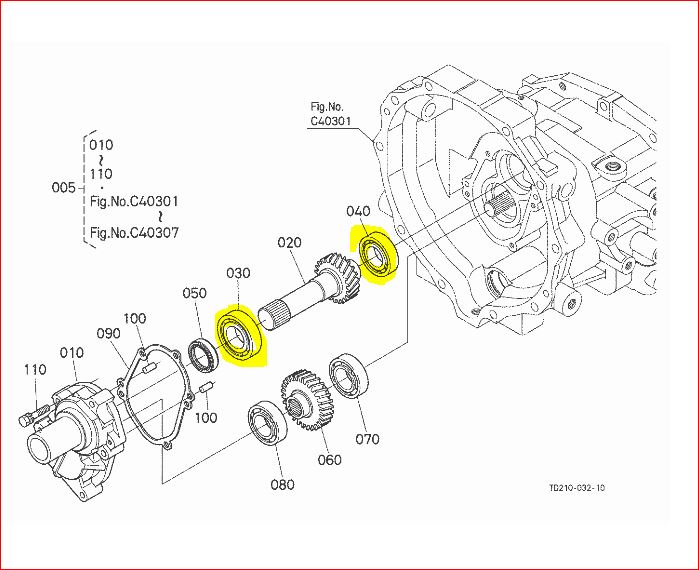

My main problem is that I have run into something new to me. The end of the transmission input shaft is splined all the way to the end with nothing to enter a pilot bushing. The flywheel doesn't have a pilot bushing or a pilot bearing. The end of the spline just seems to hang into space with nothing to support it except the steel of the flywheel. Could it be possible that a bushing bearing isn't required? I know that the answer to this is going to be obvious but it seems to have everyone around here stumped. I wasn't there to see it come apart so I'm playing catch up.

The shaft being splined to the end requires something around those splines going into the crankshaft or it will be short lived.
How much tolerance is there between the splines and the hole? Does it look like, at some time, there was a bushing or something in the hole? Does it look like the end of the shaft has been broken?
On my L305, according to the parts book, the splined end steps down to a smooth shaft, goes the release hub, which has a release bearing on it. Then into crankshaft. It shows a ball bearing there.
33,082
8,495
It is exactly that, the shaft that feeds the HST is supported by 2 bearings that are very large right behind the throw-out bearing housing, and the shaft size and make up allows it to "float" unlike a geared transmission. ;)
I know it doesn't agree with all of what we have known about pilot bearings and input shafts over the years.

I finally talked to someone at Kubota that explained it to me. Just as Wolfman said, the input shaft is supported by those huge bearings inside the transmission and the engine doesn't require a pilot bearing. It's counter-intuitive to me but that's what they decided to do. Now, with that solved we need to get busy reassembling the tractor and see how many bolts we have left over. Thanks to everyone for your help.
