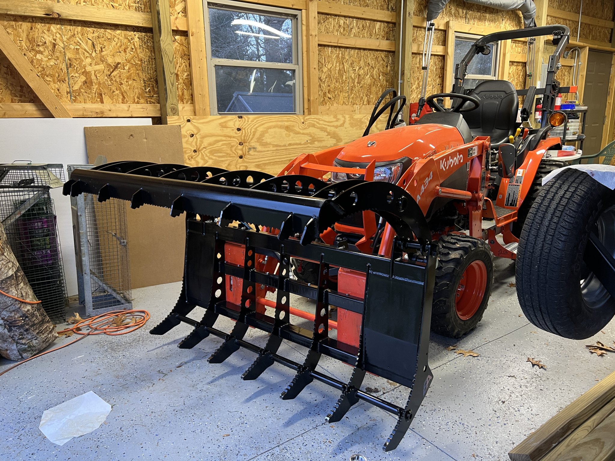

OK - that EA coupler is a Safeway S40 series coupler and does not interchange with the S20 series on your old grapple. You will need to replace something and the easiest is going to be the couplers on the EA grapple.
Edit: Scratch that!! After checking the Safeway catalog the S40 and S20 are both listed as AG couplers and use the exact same nipples. The difference is the S40 female is a two way sleeve push/pull to connect coupler. I use them a lot and should have remembered that. Are you sure you are getting the sleeve locked? You don't retract it to connect - it actually extends to connect. Just grasp the sleeve tightly and push it onto the nipple and then let go - it will lock automagically.
Got all excited when I read this and ran out there to try it... sorry to say no luck.... boohoo!
And no the sleeve doesn't feel like it is locked, has about an 1/8" slop push pull but it doesn't come off....
Not sure what to do next... Tried both ways, retract to connect and push pull, same result....

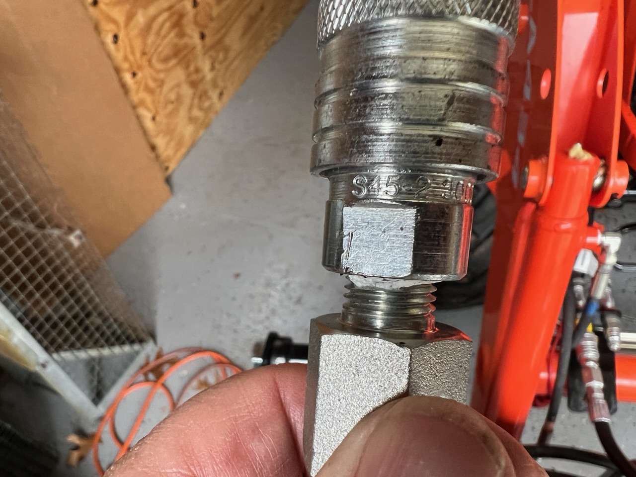

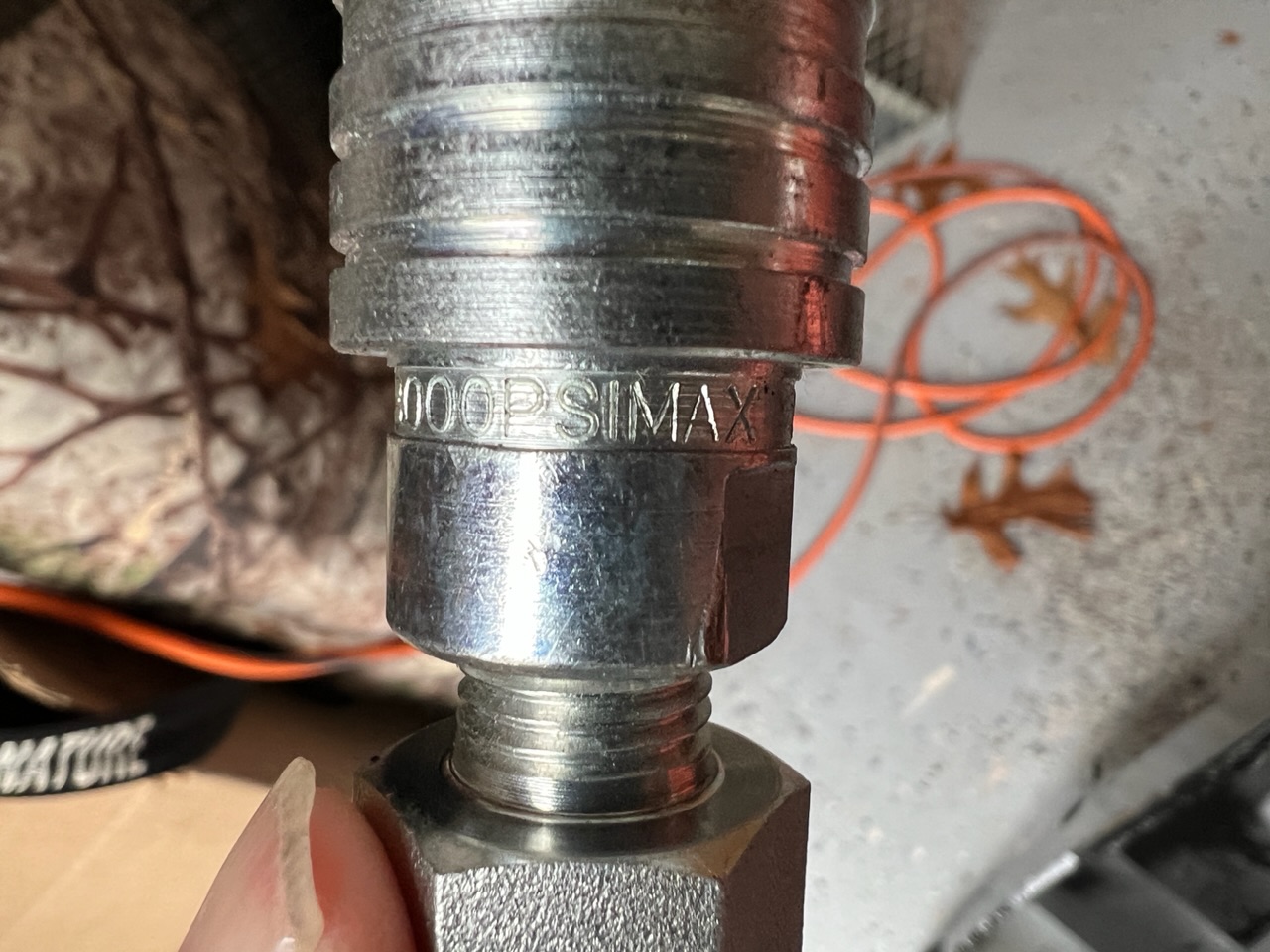

Your old couplers are SH20 series couplers NOT S20 series. I had it right the first time and got my wires crossed when I started looking at the catalogs. The SH series couplers do NOT interchange with Safeway S20 or S40 or any other series agricultural couplers. The 6000 PSI pressure rating on your old couplers finally got me back on the correct catalog page.
So back to my original response - you have incompatible couplers and need to replace something. Replacing the S40 couplers on the EA grapple with matching SH20 couplers is the cheapest way to go.

If I have the part numbers correct the old couplers have SAE6 end connections and your new ones are 1/4 female NPT. They wont swap without the correct adapters.

Should not be anything on the SAE threads. Heat and o,-rings dont play well together. Vise and a pipe wrench / cheater if they are real stubborn.
FINALLY got the connectors off! And yeah they have adaptors they used that are different, I’m not up on threads, I used to know…. Need SAE to npt? Help please!

If I correctly remember what we discussed you have 1/4" female pipe hose . I would suggest a couple of these - SAE port to female pipe swivel. Easy to connect and no sealant needed on either end.
