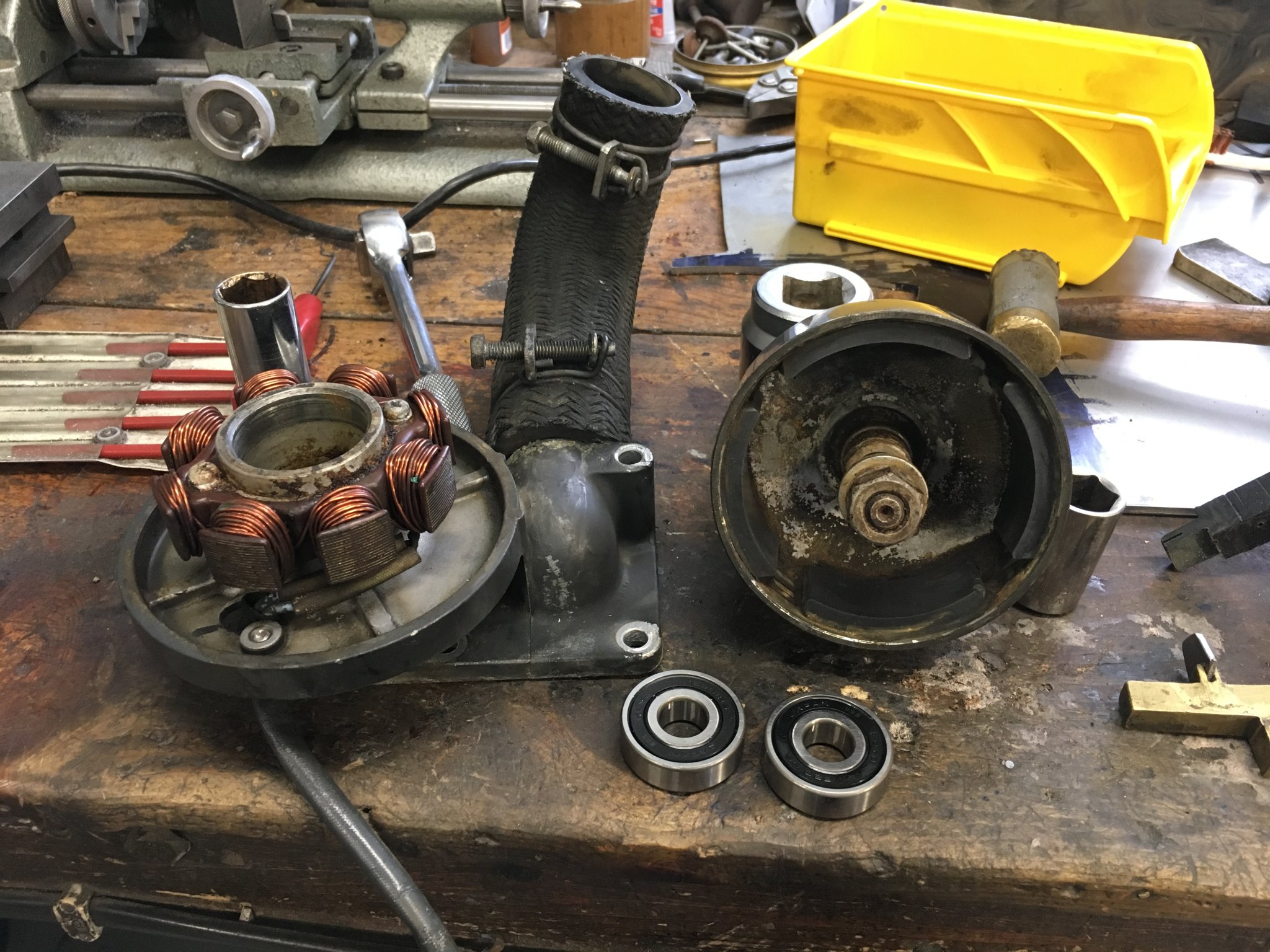

Incase your wondering, this is what is inside the dynamo. My bearings went bad and I replaced, along with the gasket between the back of the casting and the engine block.

The back of the dynamo is a water flange and that's probably where your leak is at.

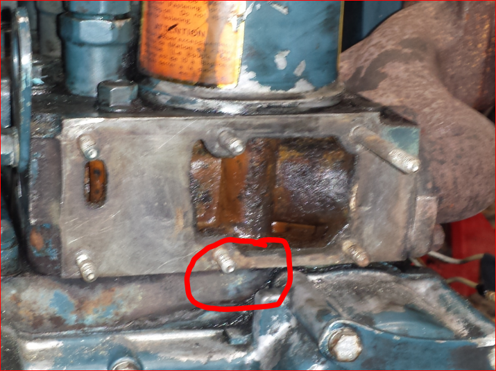

The dyno has 6 nuts - 5 of them are easy to get off - 1 of them is "hard" to get off and a real PITA tp get back on.
Get a 10 mm ratcheting wrench - something like 2 degree clicks.
What I came up with was to drill a very small hole RIGHT in the middle of the lower middle bolt. I am talking like 1/32 or so - then I get the body back on and you can place the 5 easy nuts on and get them snug - then there is enough room to take a piece of stiff wire and place it INTO the hole at the end of the bolt, allow the wire to come out past, then slide the nut down the wire and your finger can give it a few flicks and it will spin right on. Trust me any other way makes you want to pull your hair out!
