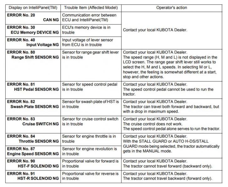

Sorry for delay, I fell asleep with tablet on my lap. :( long day. What it says first under error code 20 is
CAN bus wiring is disconnected or short circuited
No signals from main ECU for longer than 5 sec (error cleared if signal sent and received later).
Main ECU damaged.
Sounds like your dealer is guessing the second one will work unless you think there is a wire loose too.
To clear an error (from p 9s22)
1. Hold down display mode switch and turn key on. You should see a screen that says service inspect and a bunch of letters. Somewhere in here let go of both of those switches.
2. Press the display mode switch to scroll through the letter choices. (My very little experience with this panel is scrolling is accomplished by brief touches). A buzzer rings. Choose display D. Choosing is accomplished by a long press. Hold the display mode button down steadily for more than 2 sec.
3. You should see a screen that says "Want to clear error? Hold button for 3 s more."
Hold the button down for 3 sec to delete the information. You should then see a screen that says "cleared". (Let go of button here?)
4. You should then see notice to "turn off key" and that would save the change.
I would avoid getting into the other lettered choices, except J, in case you accidentally reset something else.

Any way I could get that code book? I have an error 40 on mine.
Error 40 according to owner's manual is "Input voltage to sensor from ECU is in trouble" contact your dealer, the wsm has more information, but its scattered around and I am usibg a paper copy. I believe it is the range shift lever sensor they are talking about, but not sure. To start with it suggests checking the grounds. More later
sheepfarmer
Nov 14, 2014
4,438
677
MidMichigan
You pretty much need the wsm. There are pages to tell you how to check the voltage from the ecu using the intellipanel, and a page to tell you where to check the connector from the H-DS lever, by taking cover off steering column etc. If you have an HST besides checking grounds you could try jiggling the turtle/rabbit lever.
