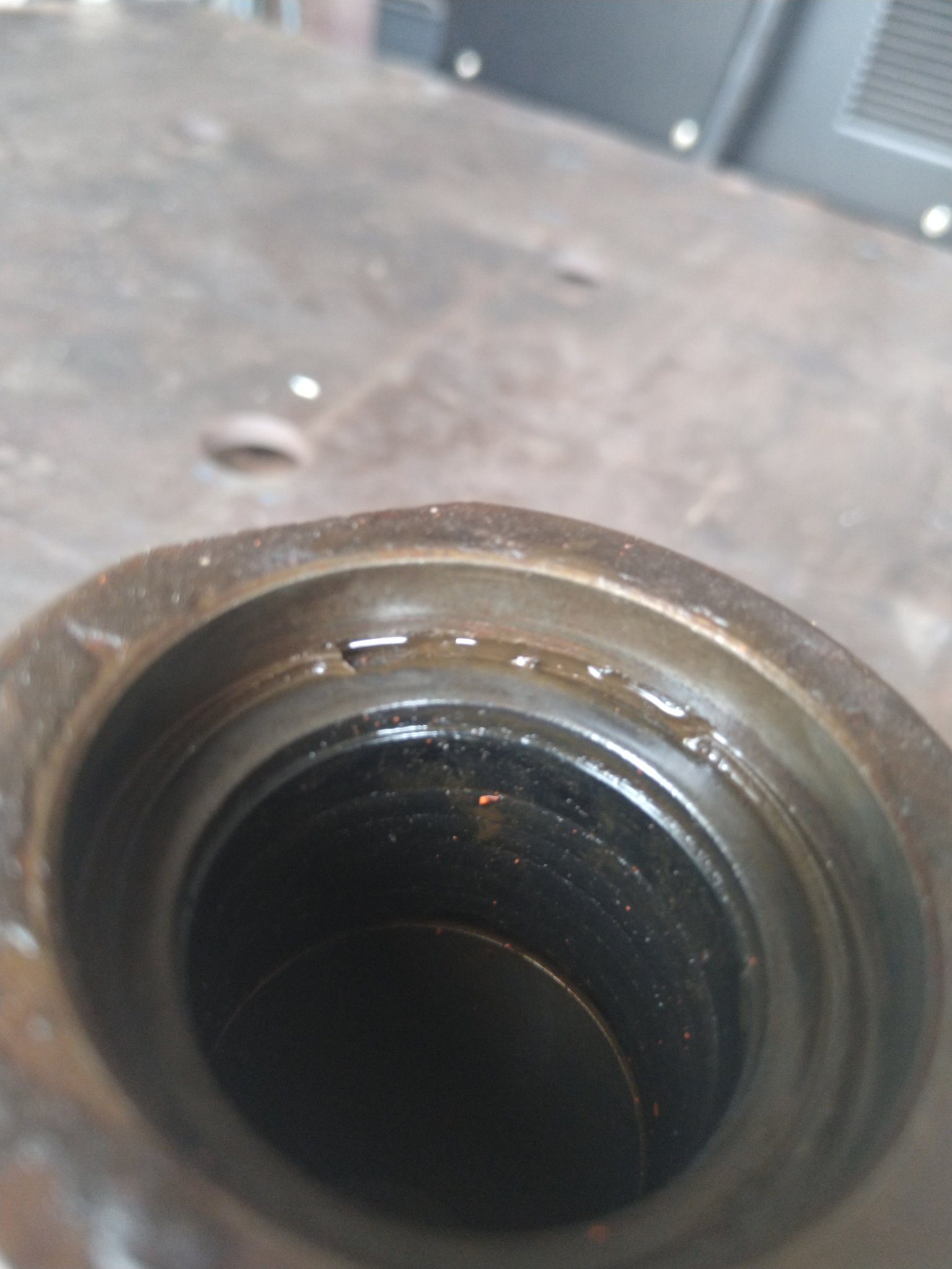

Don't forget the rod seal and wiper in the cap. Where was it leaking?
Edit, you'll need to remove the piston to replace the rod seal and wiper.

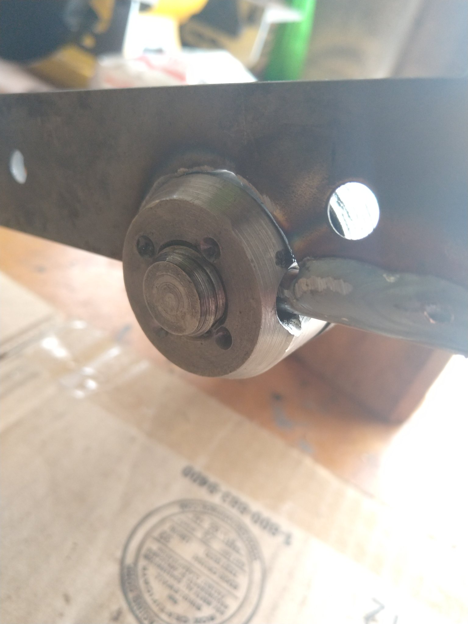

The pistons come off and apart pretty quickly & easily (hopefully, which is what I'm trying to find out now) once the details are understood. The fundamentals aren't any different than downhole oil tools I've worked on in the past, so I'm confident with the seal replacement. It's the 1st time analysis that I'm mainly struggling with. I just don't want to overlook something obvious. If I don't get it right the 1st time, I'm just out my time and a little bit of $. If I throw in the towel right away, I'm out up to ~$1000 for all 4 cylinders. Seems a worthy effort to me.
So, at this time, I'm curious about the 4 impressions on the bottom of the piston. Are they as I imagine, threadlockers?

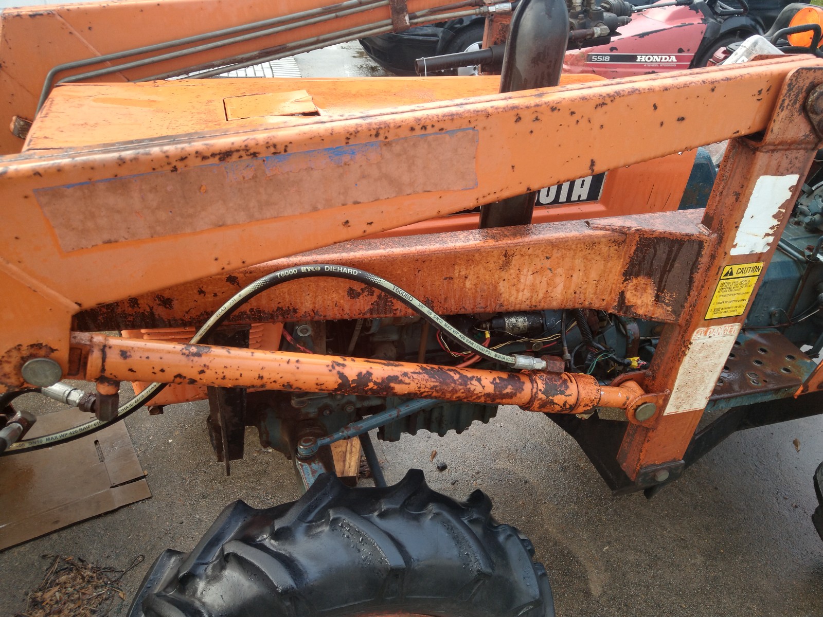

I've not tried too hard to find a kit since I don't have the FEL model number. It would be my 1st option if I had the info, though. The plan as of now is to remove the seals and take them to the hydraulics shop for matching.

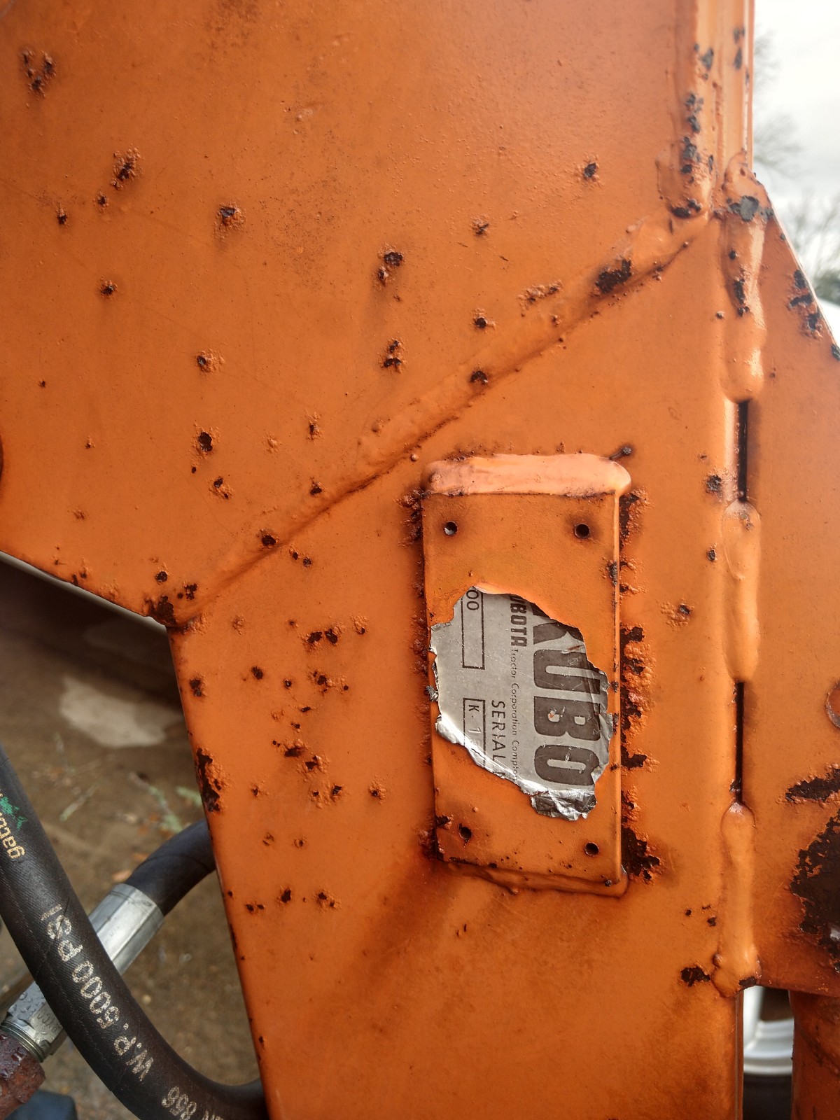

So this is the condition of the FEL labels. The only thing I can halfway make out is "501" on the right side, but this doesn't look like OEM marking to me.
Rough, I know. This is an initial stage of a general restoration.

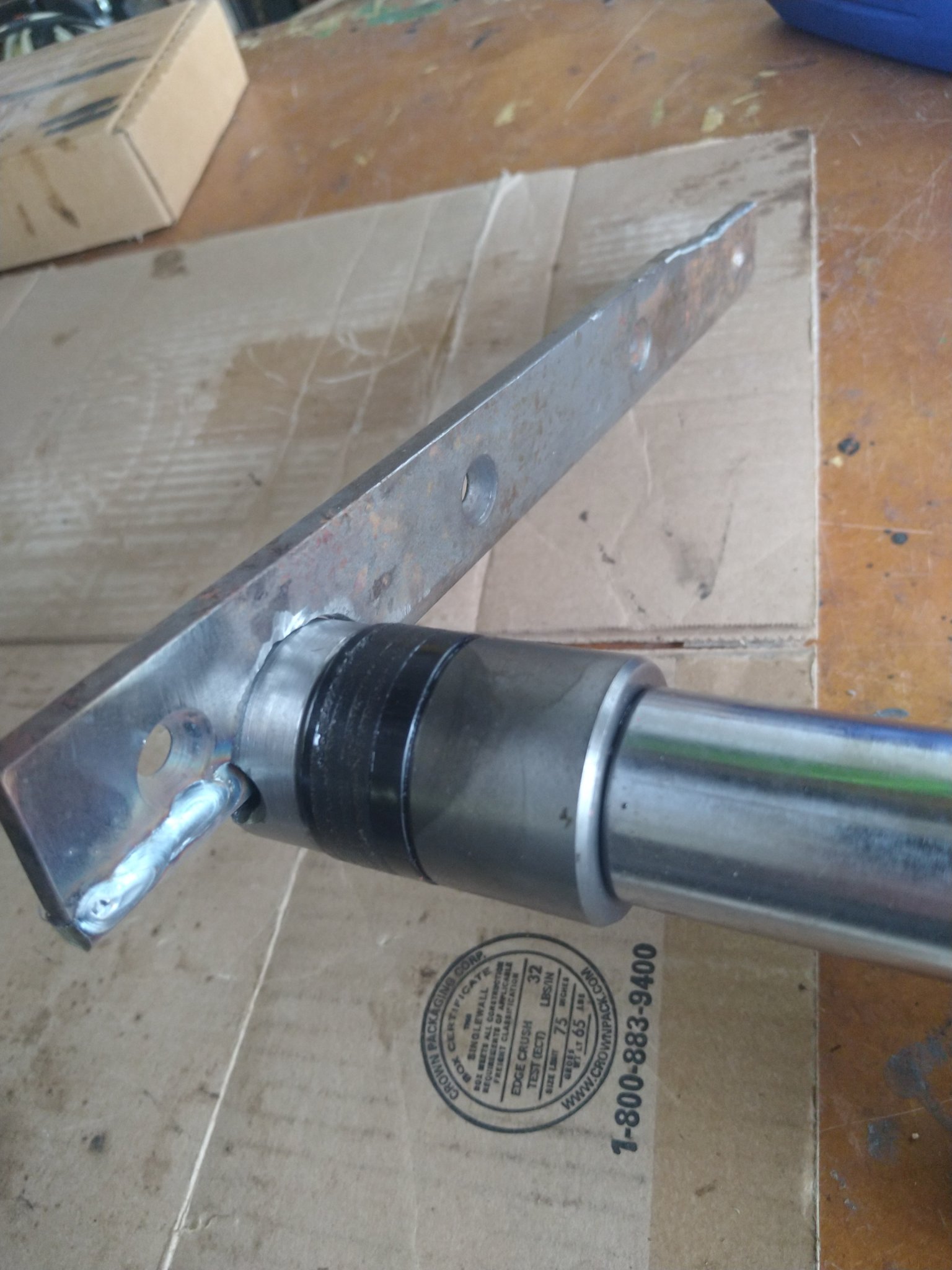

I'm definitely considering doing that since the piston does look to be held on there with metal deformation at those 4 punch marks. That would make sense since that part coming off in use would be bad. I made a spanner and the piston is not rotating even with hammer taps on the end of the spanner. I'd be in the clear if I could get the piston off.

Nice wrench! It'll be tight for sure. Some people would use a big pipe wrench and then file off the tool marks. Just don't get hurt.

I do have a big pipe wrench and thought about it, but decided to go this route. I can definitely put more a$$ into the spanner, but wasn't going to get too aggressive before getting some more feedback from y'all.

All mine had hex nuts holding them on. A 3/4" drive socket and 4' cheater did the trick. I'm fair sized.

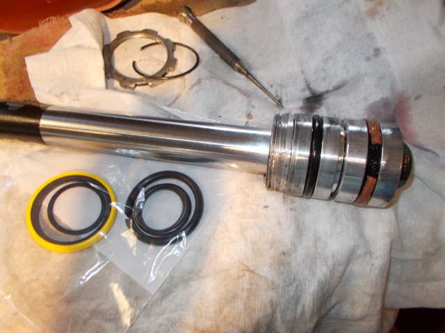

I did get the piston off after putting a cheater pipe on the spanner. The piston seal was a chevron stack with a couple of plastic end pieces.
The ID cap has the same type of seal setup. The stack is held in place by a interior circlip. Unfortunately, BOTH tabs of the circlip are broken off. One was broken when I pulled out the wiper, and the other broke when I probed it a bit with my pick. So now's the challenge. Not alot of meat to grab hold of. I don't think I can get picks in behind what remains of it. Even if I could, I doubt I could get enough force on it that way.
I could get my dremel with the diamond cutoff disk on it to cut it in half....

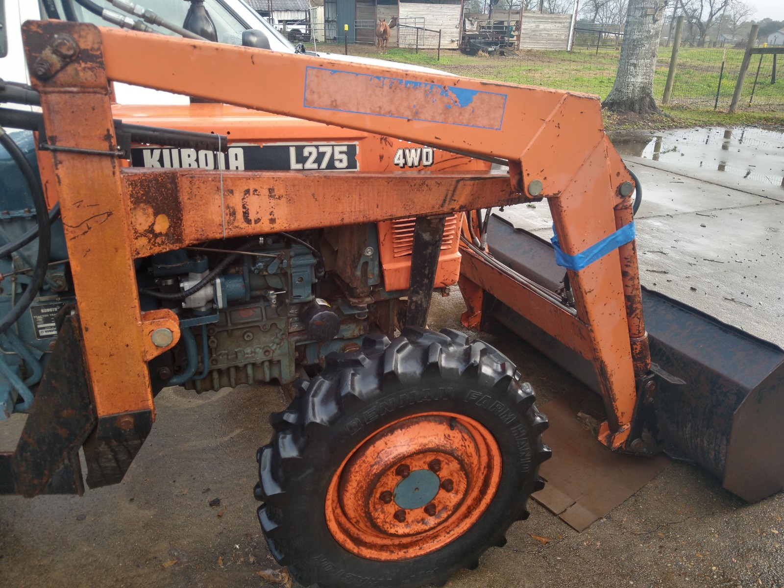

I'm guessing you've googled your tractor and determined that it is not a BF400 loader? https://www.tractordata.com/farm-tractors/001/2/8/1284-kubota-l275-attachments.html
If it is: https://www.messicks.com/ku/84655
It is not, unless they have different variations in design over the years. All pictures & diagrams of the BF400 I've seen are different from mine, which is pictured in post 27. Cylinders are definitely different from the exploded views in the Messicks link.

That's what I saw. Do your cylinders have any id stamped in them?

Saying "you're the man" would be an understatement. Thanks so much for the pointer, and the document on top of it all. Where's the forum donation button????
