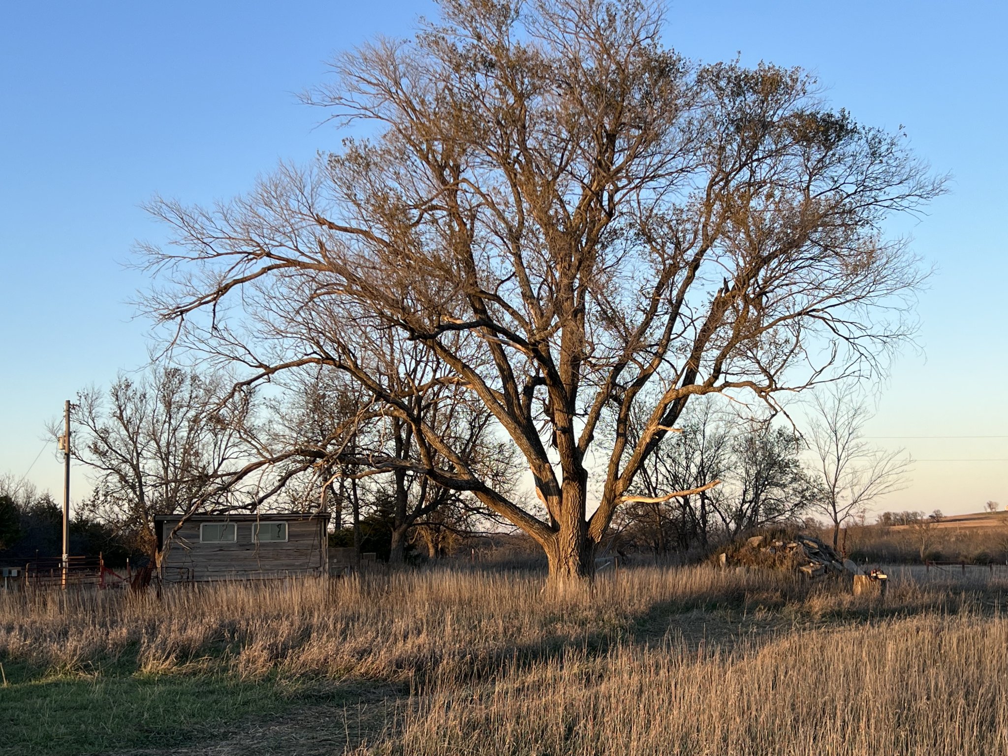

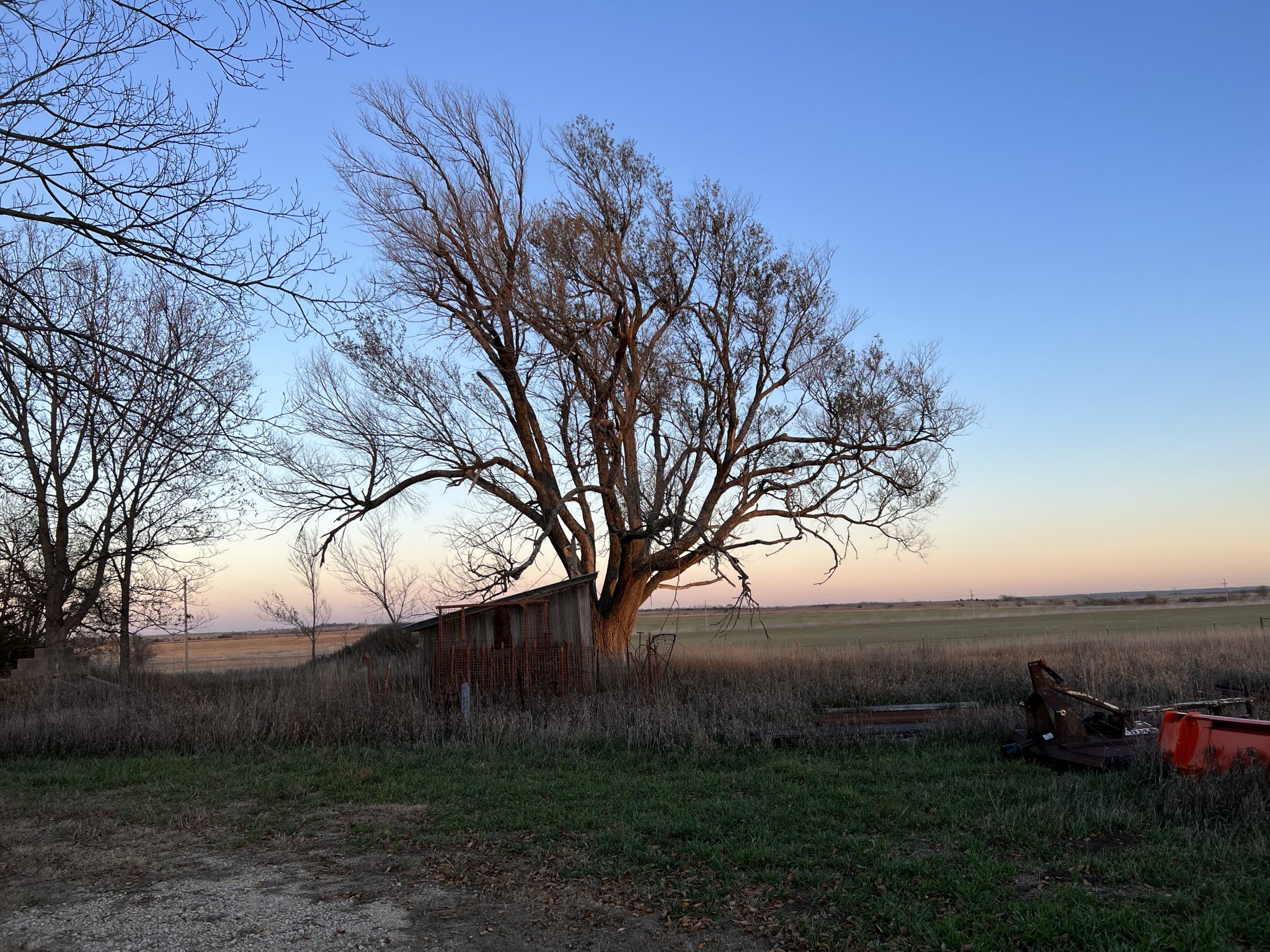

I have a large elm to bring down. It’s growing where the new shop will be erected.
Right is East, Left is West
Right is South, Left us North
I’m torn between removing some limbs before dropping it or all at 1 time. The limbs are just high enough to need a platform of some type, if cutting before the tree is down.
What direction do you think it will fall? How would you bring it down? The chicken coup will be raised anyway, so potential damage is of no consequence, other than just in the way.
The Northwoods guys have impressed me with some of their work, how would you do it? I have 2 saws, plenty of chain, tractor, & could draft a little help.

I would take the East, West, and North limb off, then fall it South

I would say it would would fall to the east or south without help. A tractor will help guide it but I have seen trees that size drag a tractor and fall away from the direction of pull.
Look on Youtube for videos of falling a tree using a hydraulic jack. That will give you a good idea of how to control the direction of fall without depending on a movable object as an anchor point for a chain or winch.

The direction it falls is dependent on how its cut. If you were to cut it straight I'd say it would likely fall south perhaps slightly west judging by what looks to be the majority of mass. Assuming that it doesn't pivot on itself.
The key is to control the drop. You can remove limbs to bias weight in the direction you want it to drop. But as long as they don't hinder your escape path and there are no obstacles you want ro prevent from damaging it isn't 100% necessary. If it were me, assuming its a healthy tree, I'd just cut a wedge on the south side, straight cut from the north and use a felling wedge to force it to fall that way. Controlled drops are safe drops.
I'm not a professional though, just dropped quite a bit of timber in my time.

I find it hard to give rec. based on these photos.
I sense your skill level as a faller is low as seems you be thinking of bringing it down in 1 piece so recommending a climb and work your way down strategy out of the question.
so based on limited info. initial reaction would be recommend you consider to take each of the 4 main limbs individually from a gnd position leaving the main stock at what looks like the 5' level intact for the last cut at ground level

That would be a good tree to work down with the LimbHog! One limb at a time, but I'm not driving down there for the practice

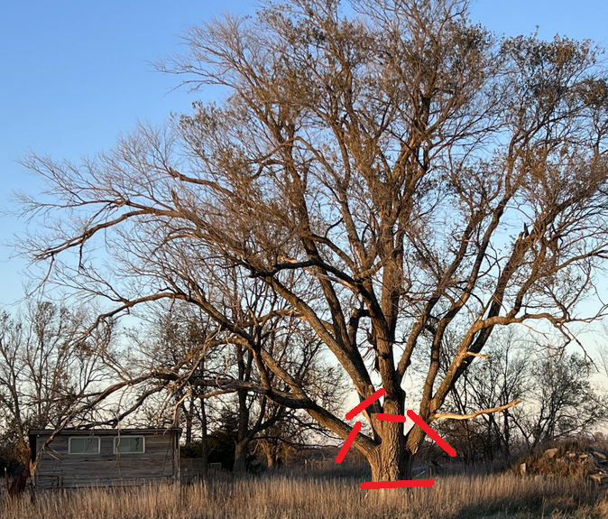

Thank you for the replies. You are right, I’m not a professional, but did clear 73 acres of medium & heavy forest (NRCS measurements) with only 1 ER visit & that was a pencil thin 3’ locust tree (another story).
The Husqvarna video is great, that guy is a professional.
This Elm has the largest base, oval shaped, all of 4’ the long way, of any tree I’ve put down. It is very old & prob hollow in the center.
I may chain the tractor to a limb to guide it down, but not to the tree. I understand physics. I also understand it is hard to judge the tree by 2 pictures. I asked the question because I wanted opinions.
I’m inclined to take the W limb over the coup first. The N limb may go N when I make that plunge cut. There appears to be a seam that goes down both sides of the trunk that makes me wonder if it will try to separate. I think the N limb needs to go second to eliminate that possibility. The remaining mass will take the tree S & maybe a little E. I do have a JD 750 bulldozer on the property that I could utilize. I’ll talk to the owner & see what he thinks. I’d like to get the tree on the ground, then cut it up.
The tree will come down Thanksgiving weekend. I’ll check my life ins. policy. Hmmm, it was the wife who suggested taking those trees down & putting the shop there.

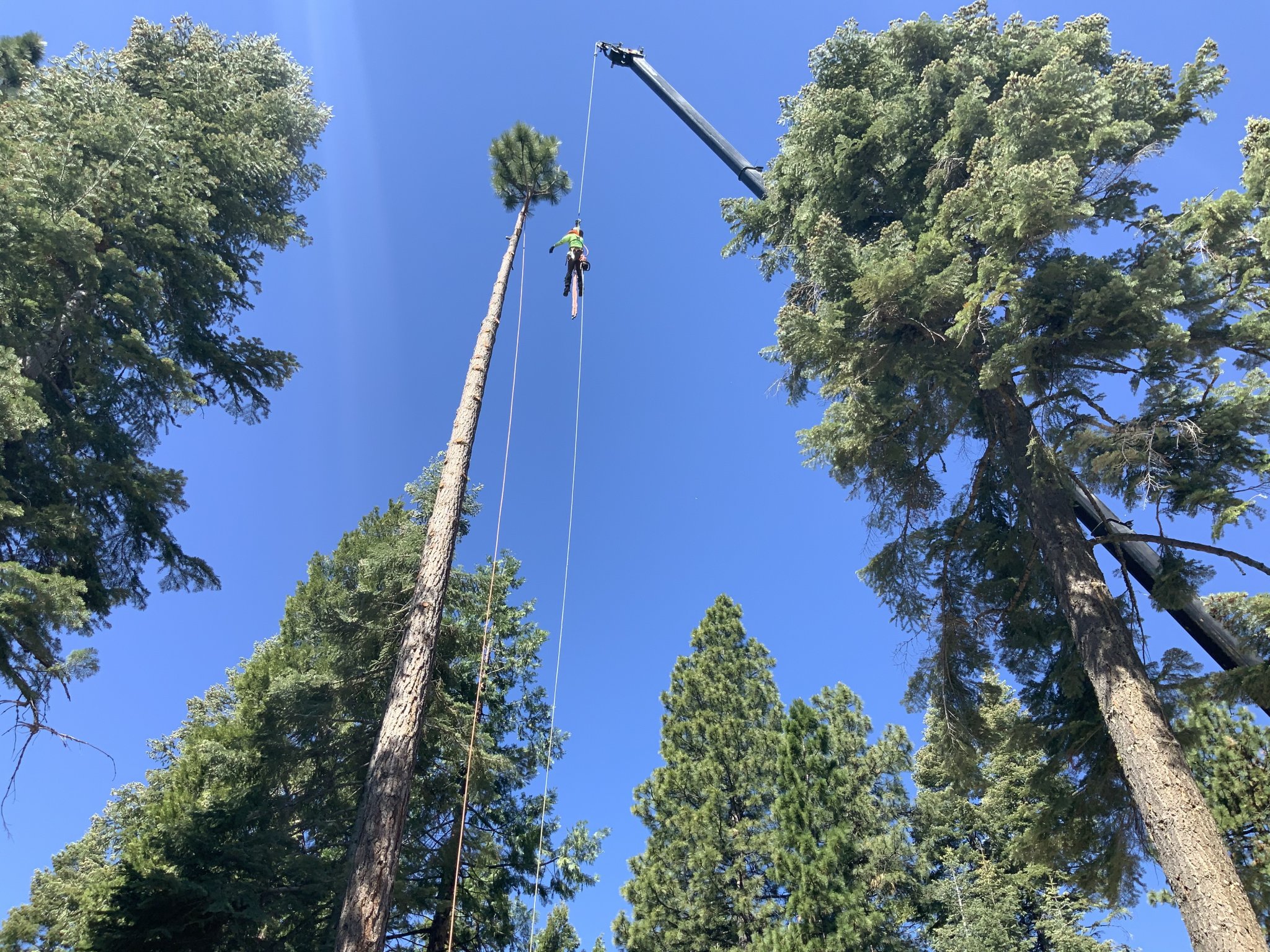

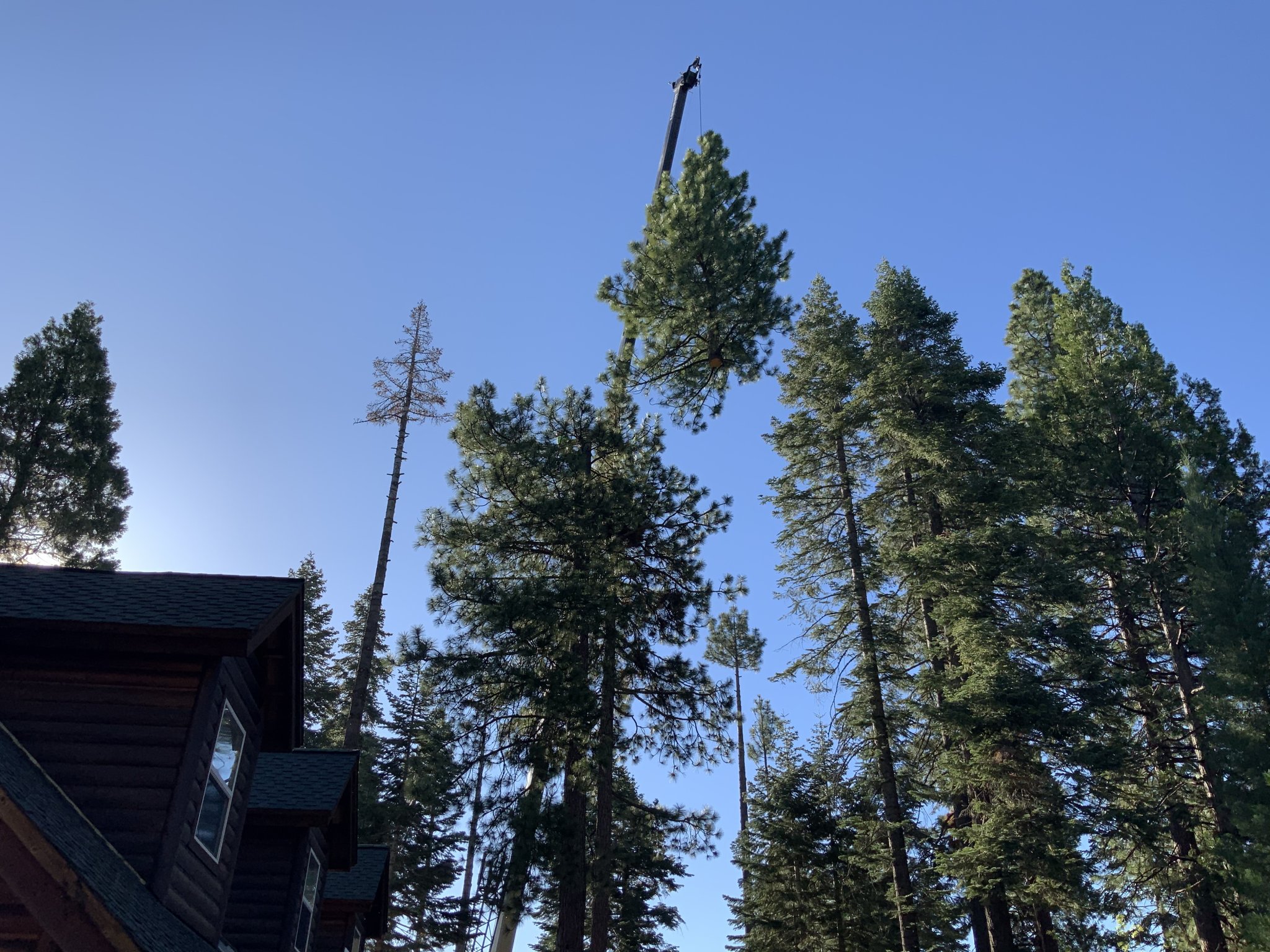

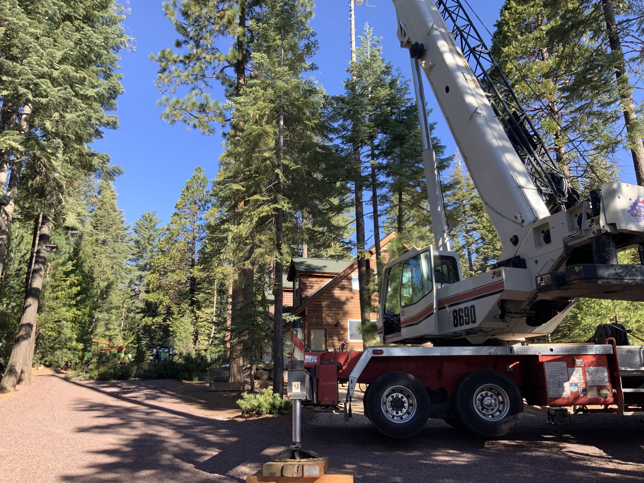

I worked for a tree service many moons ago. about 1/3 of the tree work we did was removing home owner felling from some of their garages or homes! I cut one 4’ diameter tree up in a master bed that had fallen thru the guys roof when he tried it on a windy day…opps…
Up the 3’ I do myself. Bigger that that I pay for a crane and crew. I have found the crane technique very safe and clean.
