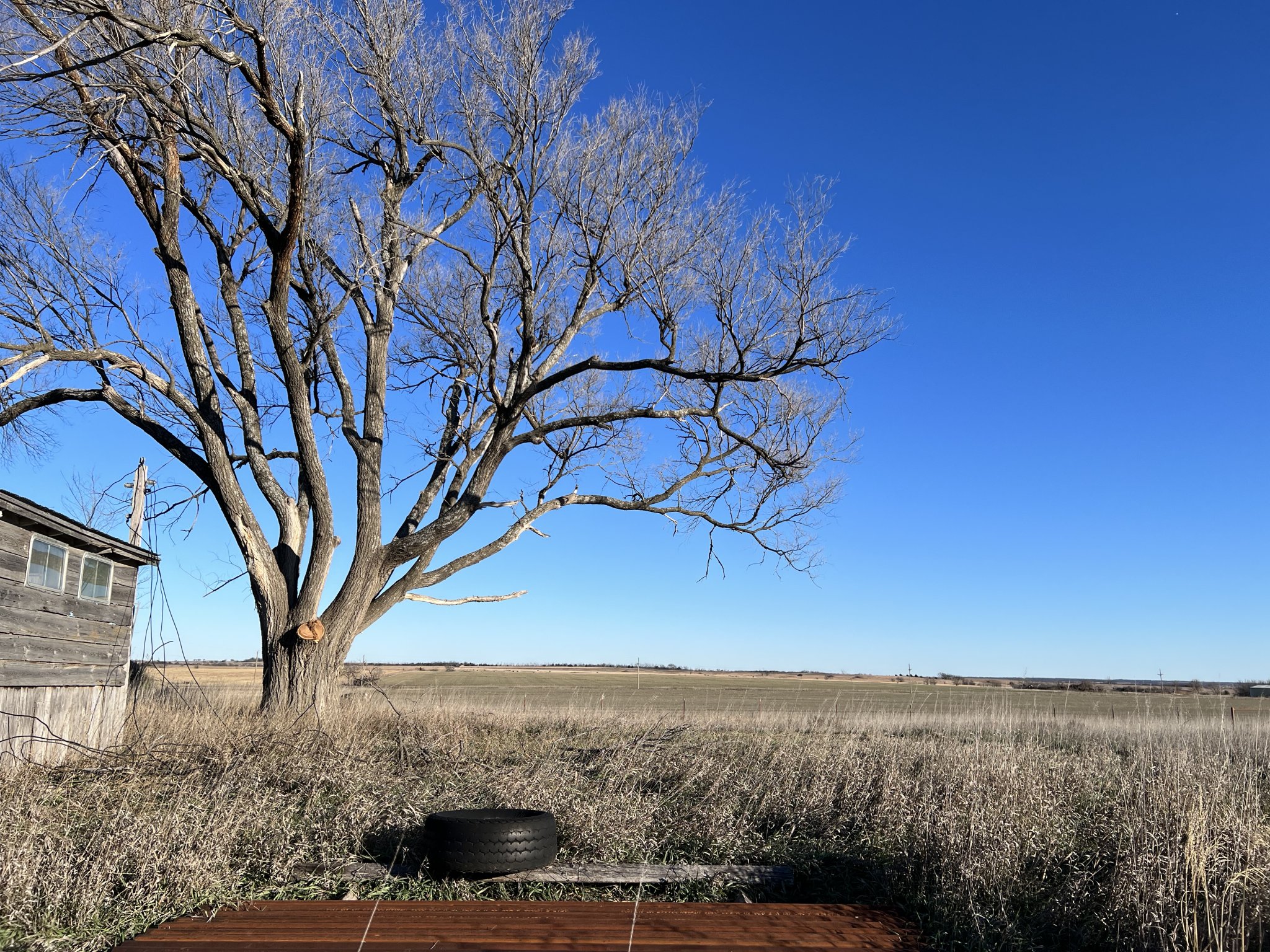

It should fall to the South as the majority of weight is on the South side.
Could use a picture of the East and West side of the lower trunk where the roots flare.
Back the felling cut up with wedges as you advance the back cut and keep the hinge the same thickness on both sides as the tree appears balanced East to West.
Bonus would be pulling it with a line up high, won't steer it but will prompt it over and you'll see if it moves and your wedges loosen.
Do you have a large saw with a long bar?

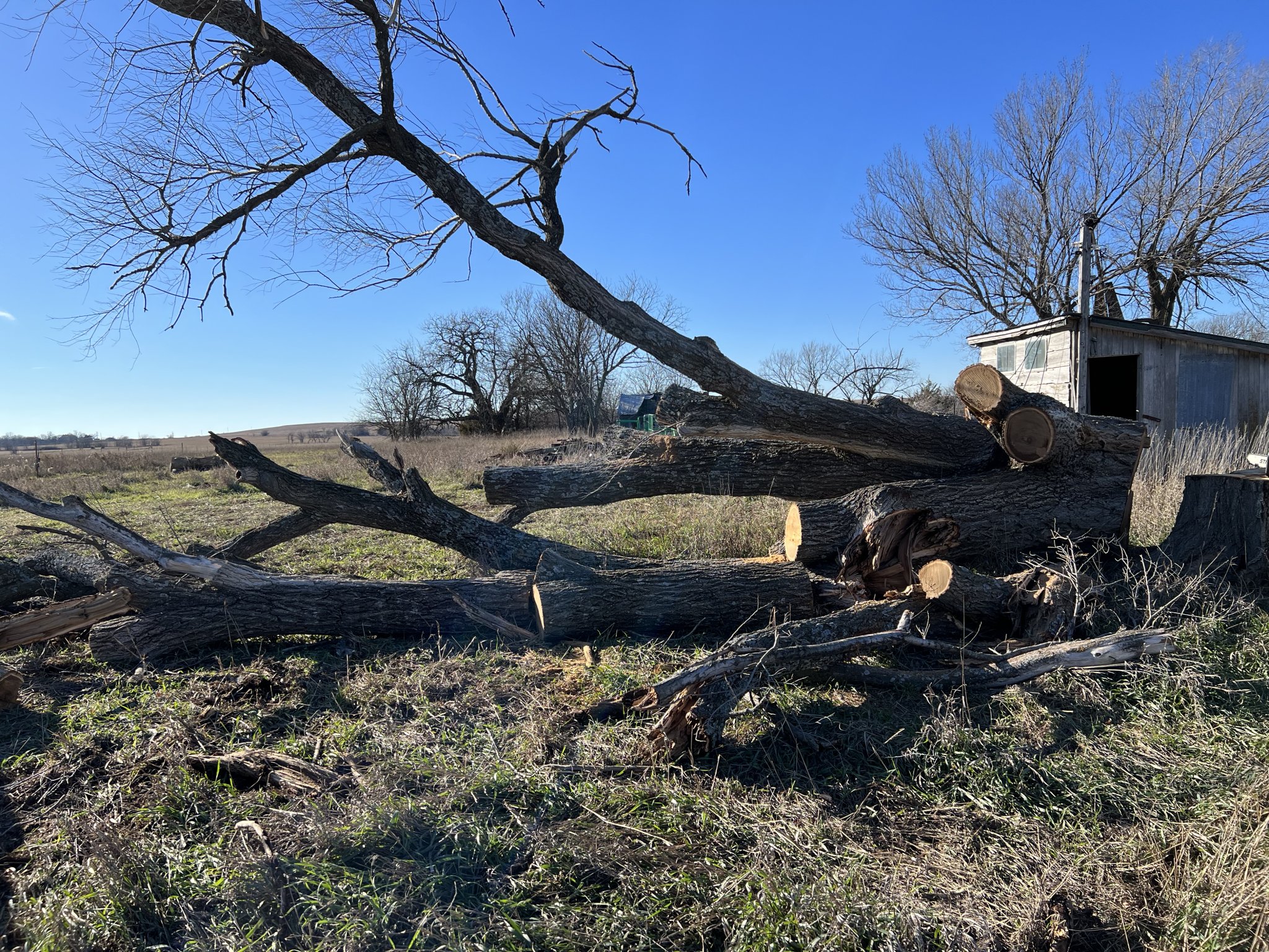

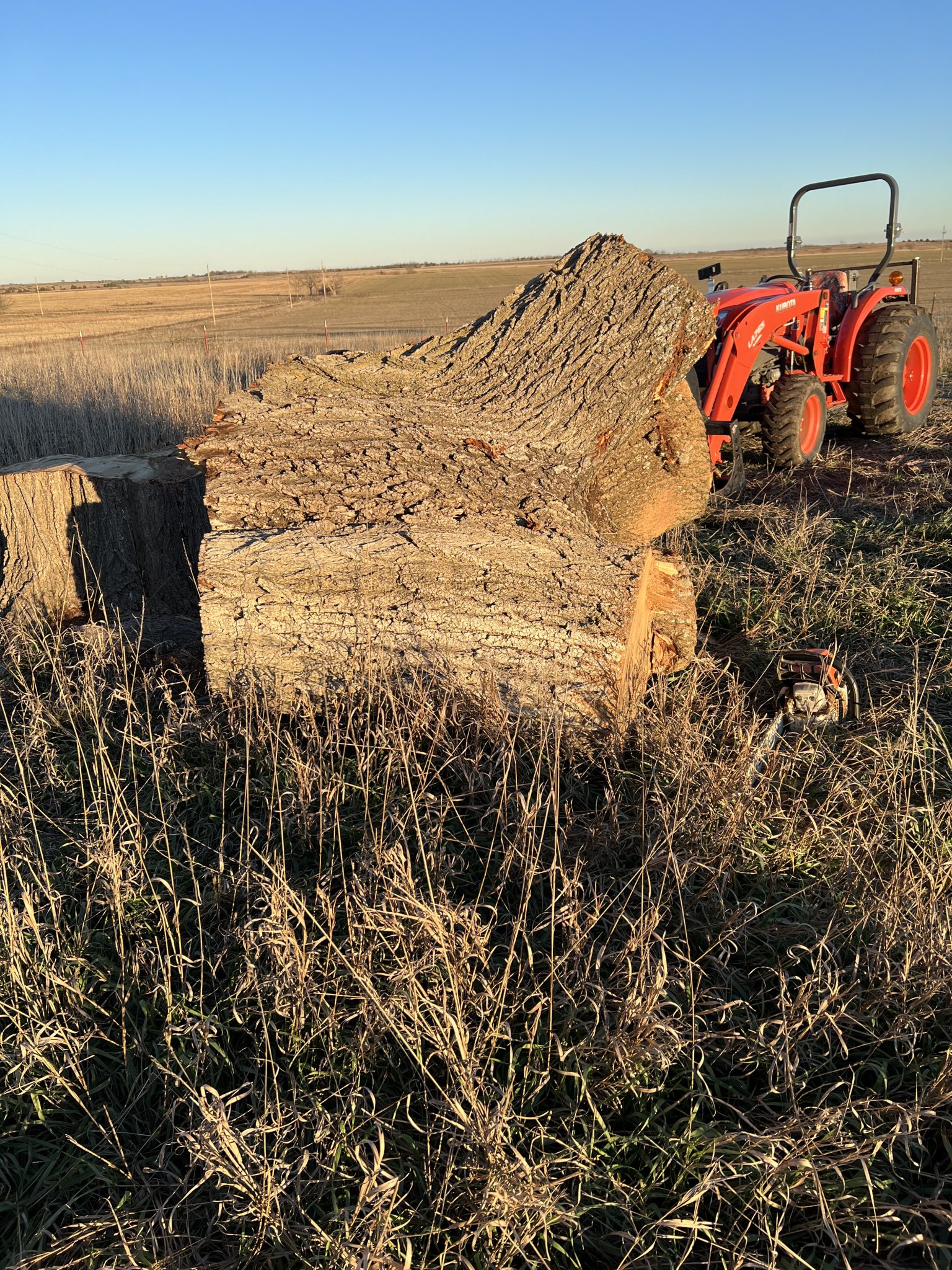

I have a Stihl 311 with a 20” bar. I’ll have to cut from both sides. I’ve done that before. This tree had a twin. It was an obvious leaner & I cut it down already. This is part of the trunk.

You'll want to look at the root flare to see if there are roots inline with the hinge, if there are , bore into the trunk well below the hinge to sever any root wood .
What happens is the roots can hold the tree to the stump well into the ground with hardwood causing the tree to pull to one side.
Use a good open face notch to keep the tree on the stump longer.

If you think it’s hollow, I wouldn’t mess with it. Have cut a bunch of hollow trees. They can be unpredictable depending on how much solid is left in the area of the base. Sometimes even a large hollow tree doesn’t have enough to make a decent hinge. They also tend to fracture vertically unpredictably. There are a variety of methods to getting a hollow tree down. In order of safest to least safe: 1) hire it out; 2) chain the base with heavy chain and load binders to keep it from fracturing vertically, take it down piece by piece from the top down accessing with a spider lift if you can rent one big enough; 3) chain the base, fell it to the south (where the weight is) in one piece and hood there’s enough hinge wood you don’t end up running for your life (literally); 4) fell it in one piece and pray constantly through the process that God has mercy on you and you survive.

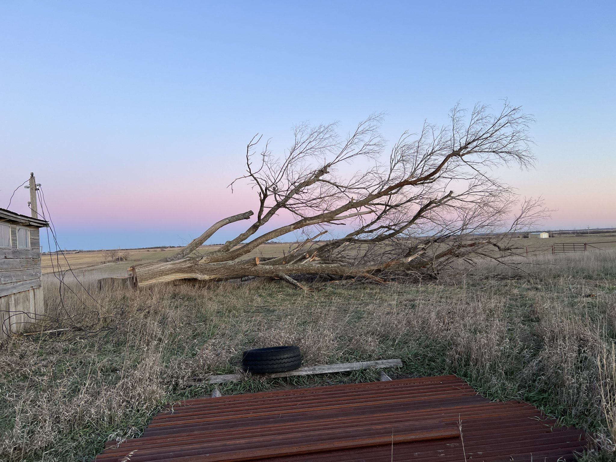

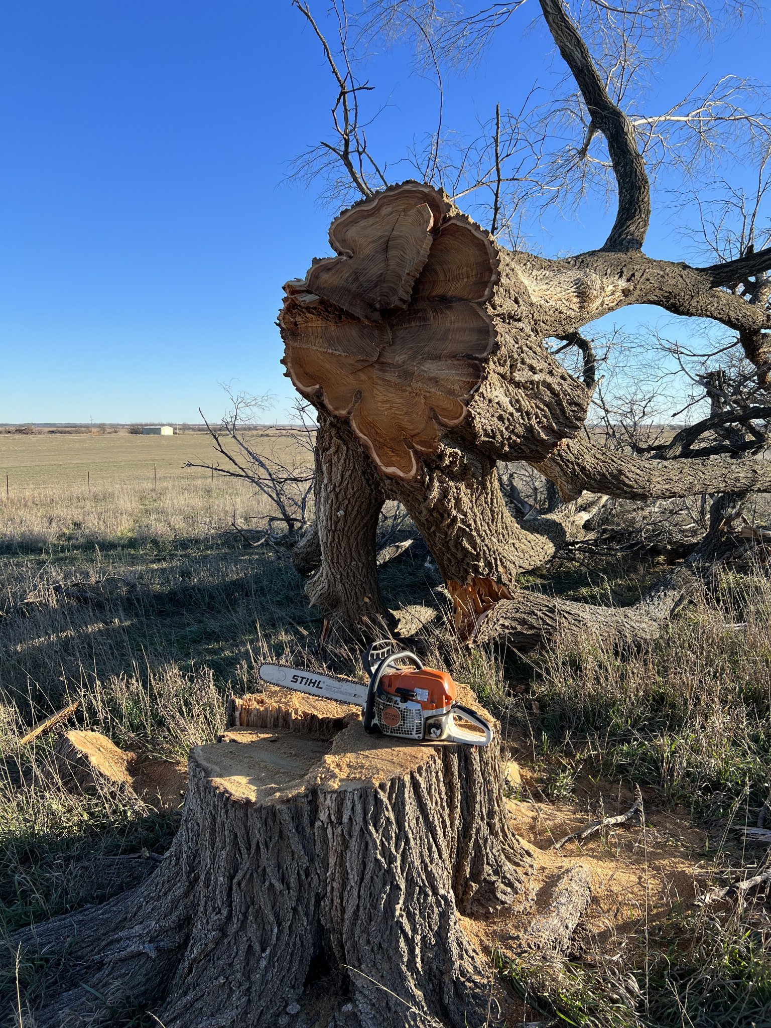

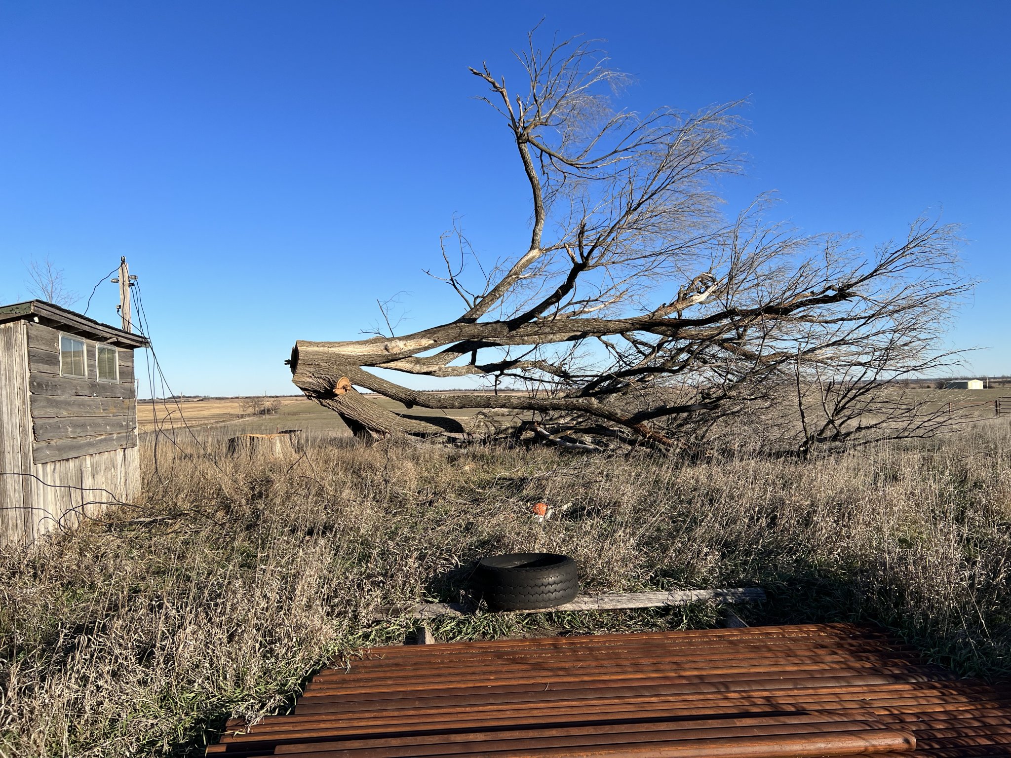

I took the Elm tree down today. It fell SSE (notched that way). My saw was barely long enough to meet in the middle of the tree. I was off a little, but the weight of the tree (& a nice N wind) brought it down. Had to whittle on it to get it completely on the ground.

Great job. At a glance, does it not look like the trunk grew in the 3rd pic?

NICE, and still have 10 finger and toes ,where they belong and NO bandaids !!!
Looks like a LOT of firewood to be cut.
Wonder if you can cut a branch off close to the ground, then use tractor to rotate the tree to get the high branches closer to ground ? Some way to keep your two feet planted on the ground ?
Love the 3rd picture...colours in the sky ,far,far away.....

Now next question. How to get rid of this monster tree trunk, where my new shop is going? I second the tannerite 😂

Yup, all appendages right when they belong & in working order. The tree made a very satisfying “thump” when it hit the ground. I did cut the branches I could reach from the ground, moved them with the tractor (love that grapple), then rolled the tree with the tractor & chains. This exposed more limbs I could access from the ground. I left a stump because the dozer operator will need something to push against when removing it. He will prepare a pad for a shop on this site.

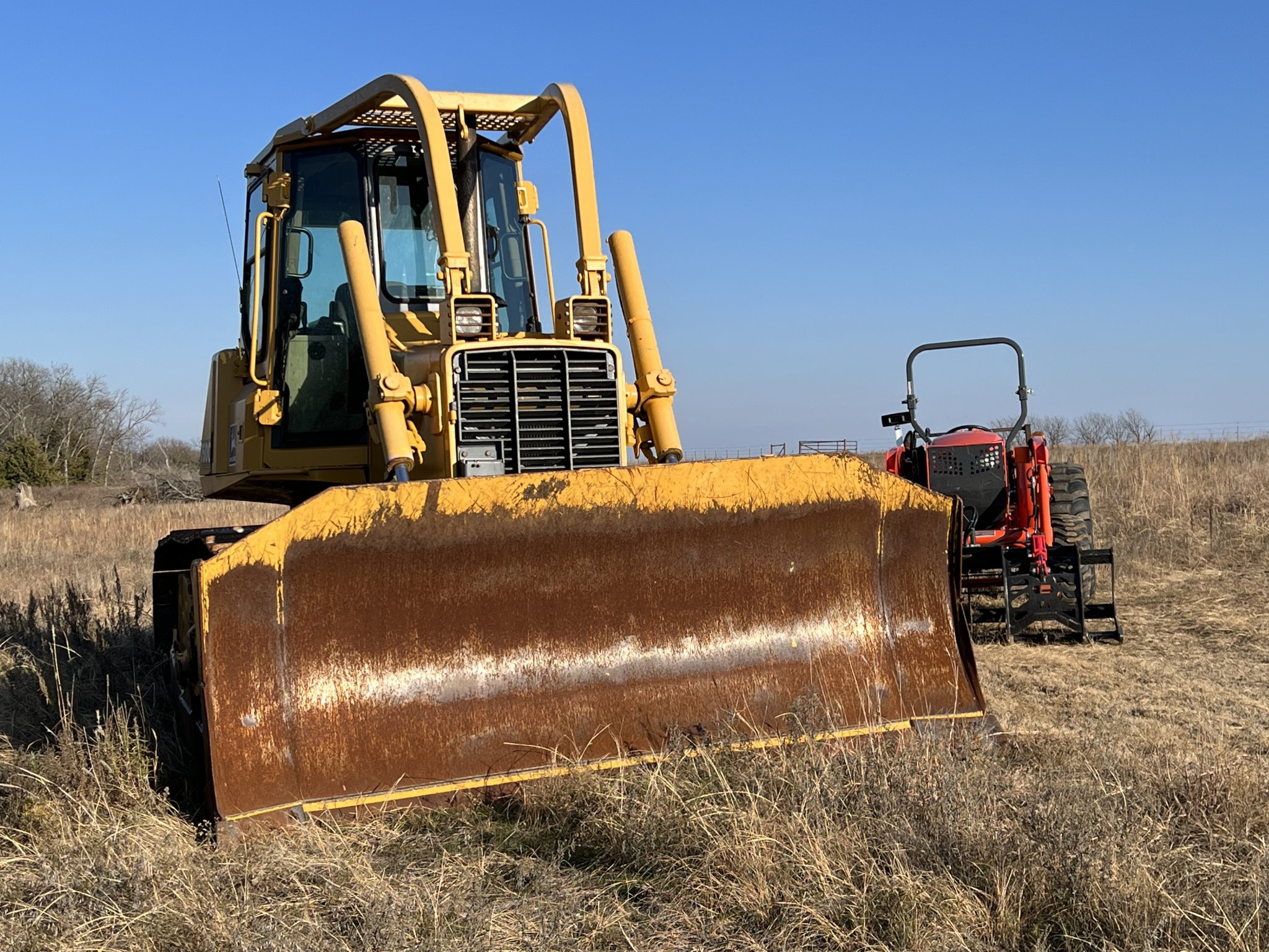

I'd like to know what the dozer operator says about it. I he might rather have taller stump for leverage if not all the top to help pull it over. I would still send him pictures or have him come by in advance. He might say you can save him time by using a hoe to pull soil away and cutting some roots. That or he can have a ripper on rear to cut roots before pushing stump. If you let us know how the dozer handles it we might learn something.

The dozer operator was there when I cut the stump. He is a neighbor & leases my ground. He has a big dozer & a track hoe as well. He will prepare the ground for a building which includes removing the stump.

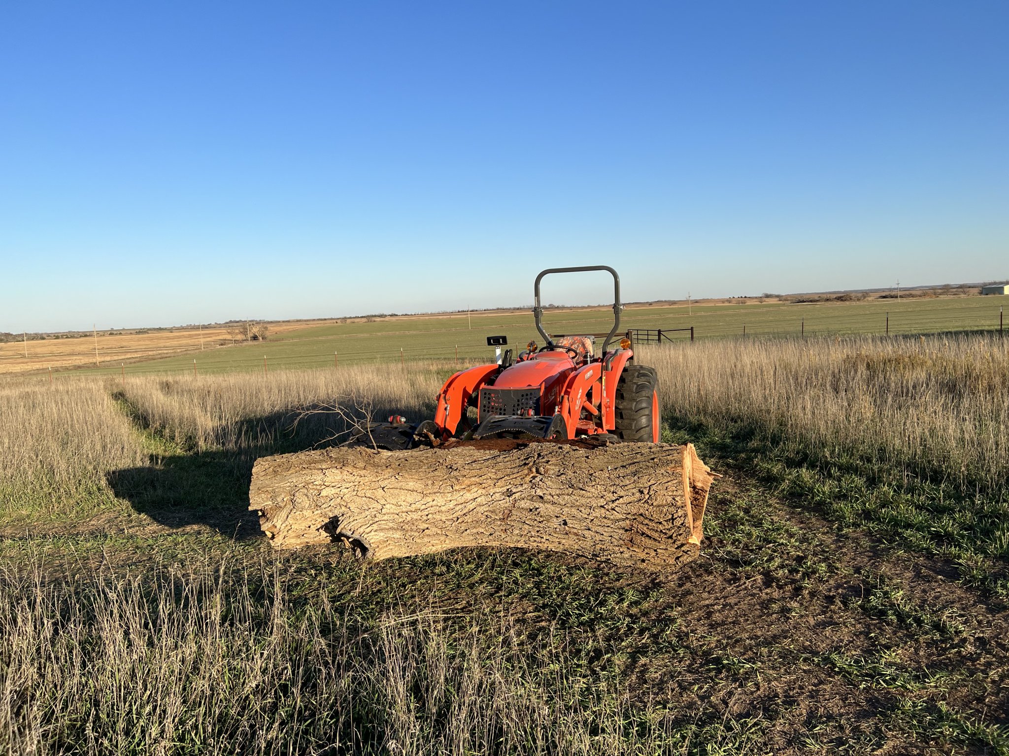

I cut up the large Elm today. The solid logs went to the wood pile & the rest to the burn pile. I still have a sizable stump to deal with. The tractor would not pick it up. I’ll have to split it or whittle it down some more.
