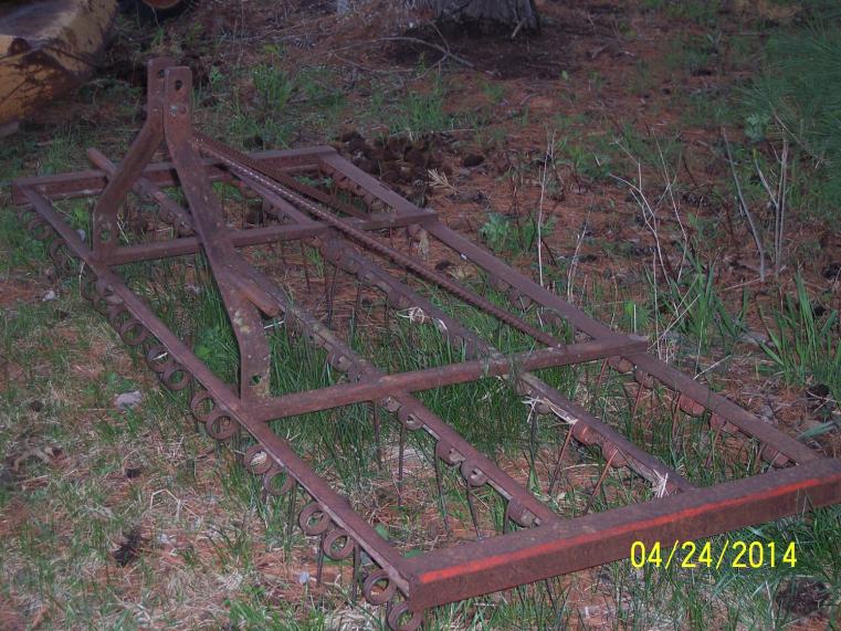

Ray, here's a rake I made years ago. Originally built it to clean thatch out of field that was going to be our yard. After using it once for that there was no more thatch to rake up!
I then started using it to rake my drive way. It works excellent. A few passes at a slow rate it looks like you hauled in tons of rock!!

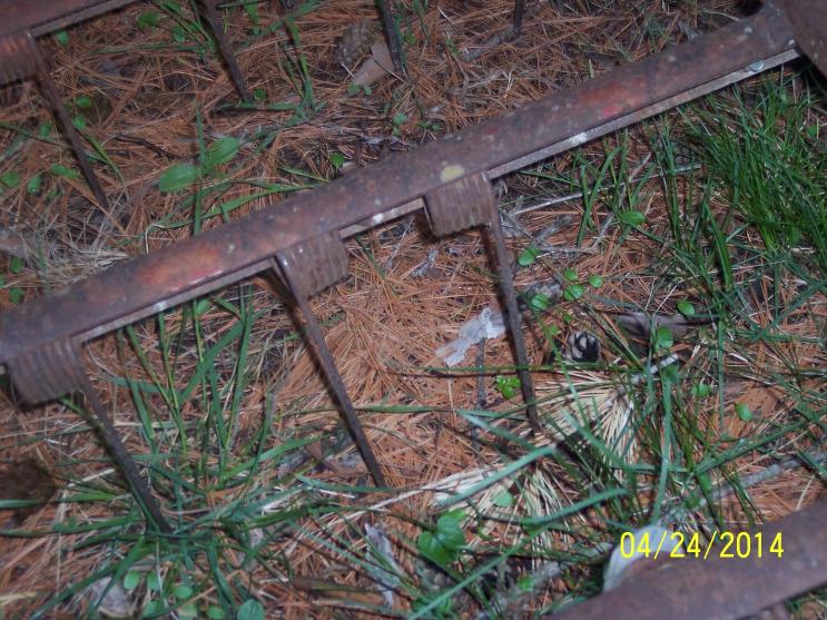

Easy to build. I removed the pickup teeth from a square baler and mounted them on "bed rails" with a 3pt hitch welded up.
Pickup teeth from a round baler works just as well. Just don't make one out of the style that has the teeth mounted with tubing going thru the center ring. Because on them when you need to replace a spring you have to then disassemble the entire row.

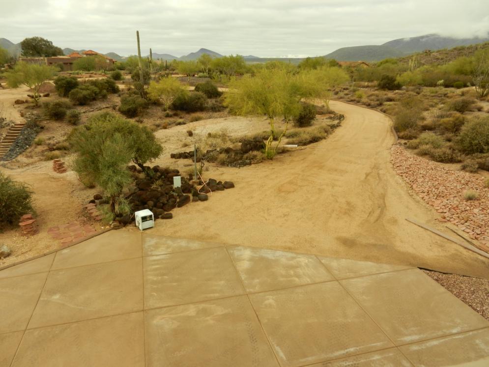

Here is a partial shot of my driveway as seen from my barn roof... It wanders back and forth at the top of the picture and you can't even see the part that goes from the street to the house garage. Its all granite and in need of leveling....

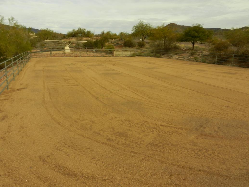

This is the area I want to encourage Marigolds to grow... It looks so nice in the spring and summer to see loads of yellow flowers...
