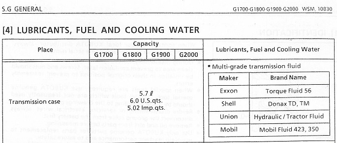

Dan said:
"I am the curious sort and would be interested in knowing what product your owners manual actually recommended. I looked for a freebie download and could not find one. It appears the G1800 was introduced in Nov 1988 which predates the introduction of SUDT by a couple of years...."
Here's a cropped page from the WSM:

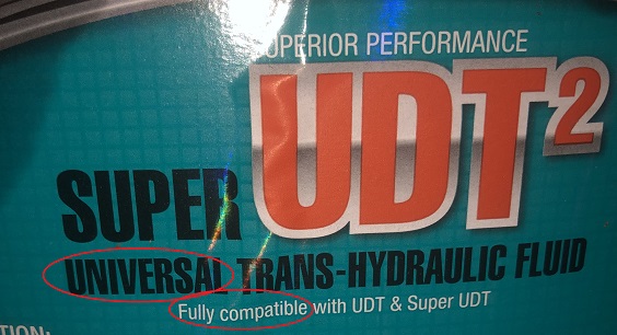

And, here's the Super UDT label:
So, ya, SUDT was not cited for use by the G1800 WSM in 1988.
I guess we could debate the meanings of "UNIVERSAL" and "Fully compatible"...
Also, the Troubleshooting section of the WSM for the transmission lists "Transmission oil insufficient" as the first Probable Cause under the Symptom "Noise from Transmission". The Solution is to "Replenish".
That's been done. Symptom gone.
I submit that there are several potential reasons for the transmission oil to be insufficient.

When all else fails lets turn the discussion into a debate of semantics.
There are a lot of terms that are common to the lubrication industry but misunderstood by the consumer. There is no need to debate the meaning of Universal in this context because it is well defined.
Universal Tractor Transmission Oil (UTTO) is a standard industry term for a defacto formulation of tractor oil that performs multiple functions in common sump machines:
  • Final drive lubricant
  • Transmission lubricant
  • Wet brake and clutch lubricant
  • General purpose hydraulic oil
  • Rust and corrosion control
It should not be confused with a Super Tractor Oil Universal (STOU) that does all of that and can also be used as an engine oil.
Those are both established terms that define the operating characteristics of a specific class of lubricants and no different than Heavy Duty Engine Oil (HDEO), Passenger Car Engine Oil (PCEO), Manual Transmission Lubricant (MTL), Automatic Transmission Fluid (ATF), Turbine Oil, etc.
