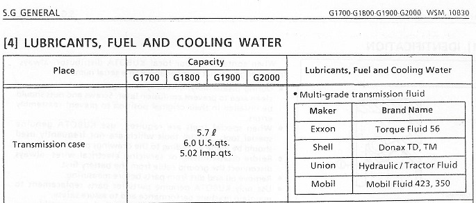

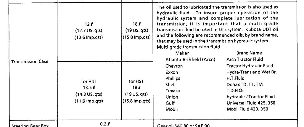

"I am the curious sort and would be interested in knowing what product your owners manual actually recommended. I looked for a freebie download and could not find one. It appears the G1800 was introduced in Nov 1988 which predates the introduction of SUDT by a couple of years...."
Here's a cropped page from the WSM:

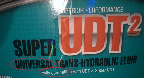

And, here's the Super UDT label:
So, ya, SUDT was not cited for use by the G1800 WSM in 1988.
I guess we could debate the meanings of "UNIVERSAL" and "Fully compatible"...
