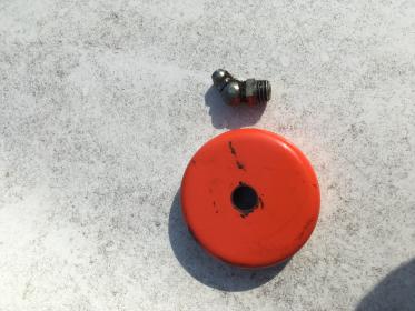

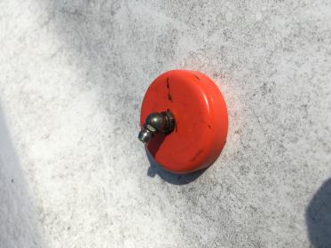

Was blowing the accumulated grass of my belly mower, and found this- just sitting in the clippings. It's metal, a cap of some sort, with a grease fitting. The screw end of the fitting likely is what keeps it on.
Where does this thing go? I've looked things over and don't see anywhere obvious.
Many thanks.

Just curious- what holds that cap down to the spindle?

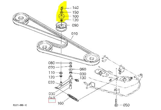

Need to be aware that if part #150 is lost then grease nipple will most likely not line up away from gearbox & make grease fitting difficult to connect grease gun. Found out the hard way on mine.

Yep they are shims and not normal washers, to set the direction of the zerk. ;)
