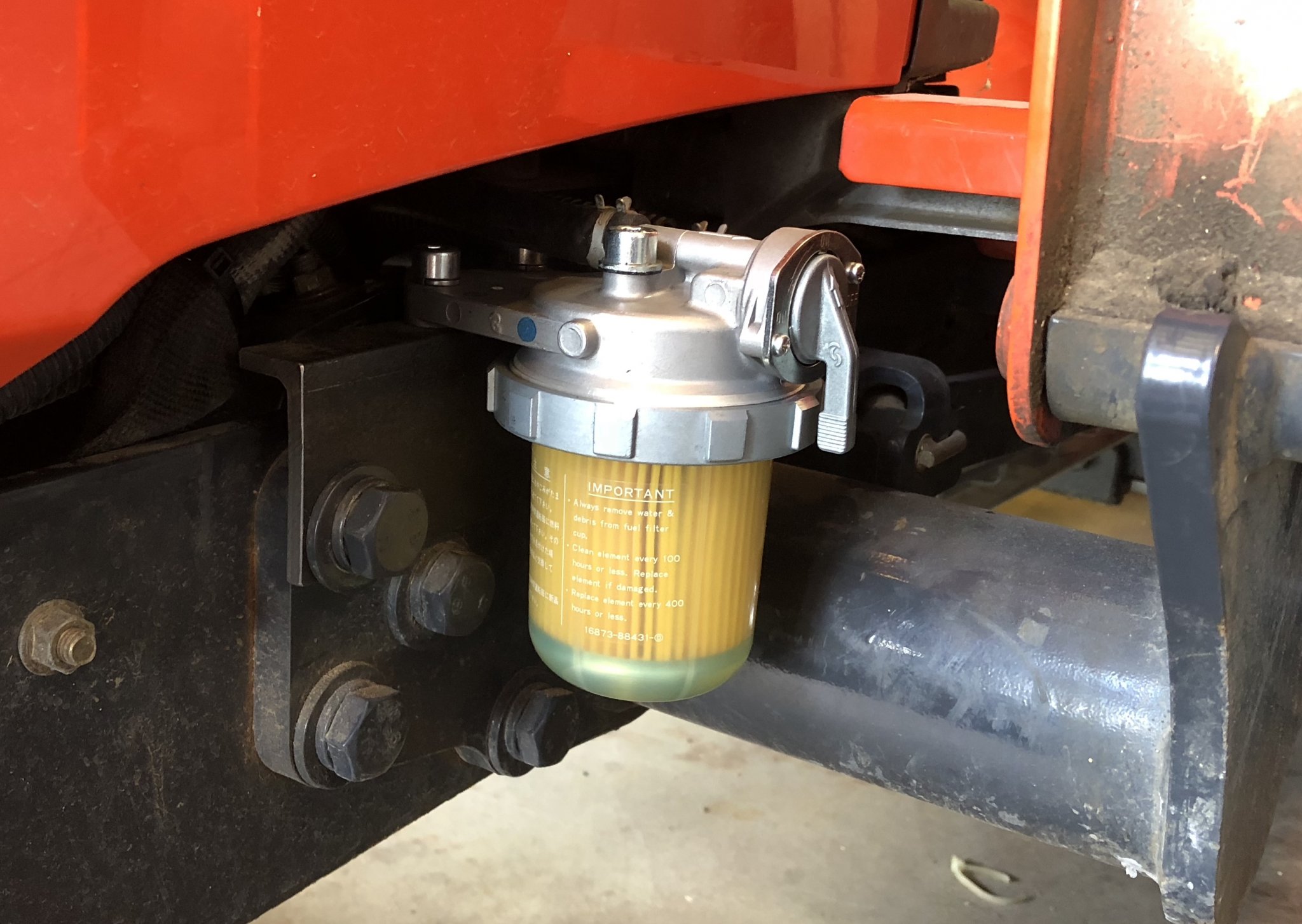

I had thought about using that filter setup but the plastic drain hanging off the bottom looked way too delicate. I ended up going with a Kubota filter instead. You will definitely want to guard that filter with it hanging out front like that. View attachment 52281
Thats the same one i put on my BX23s. Mine is installed in the same place as yours is too. Mine is going on 3yrs old, not one single issue. I bought my filter kit from Mike (bxtractorparts.com) Built in shut off valve, love it. Actually i just put in a fresh new filter for this winter. Buy the replacement filter right from the kubota dealer. Dosent get any easier than that.

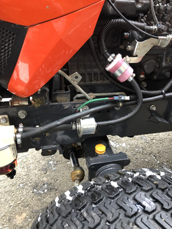

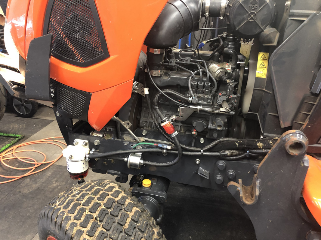

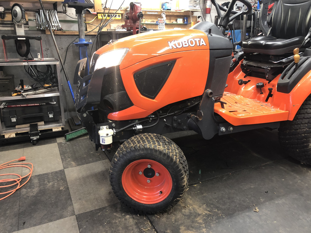

Here's my version:
I fabricated and installed a fuel filter bracket and protective shield for my BX.
Your comments are appreciated and welcomed.
Here are several pics;

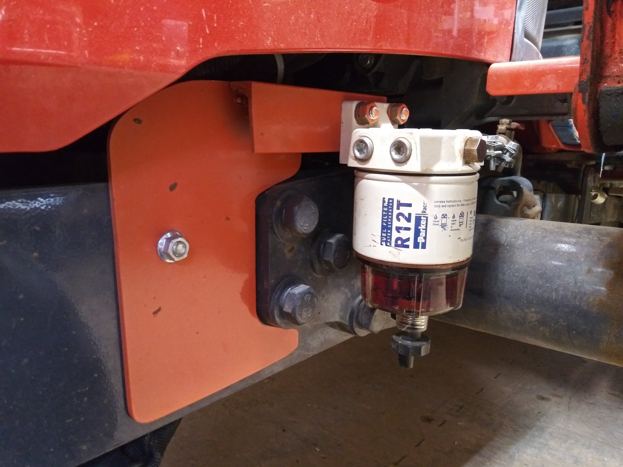

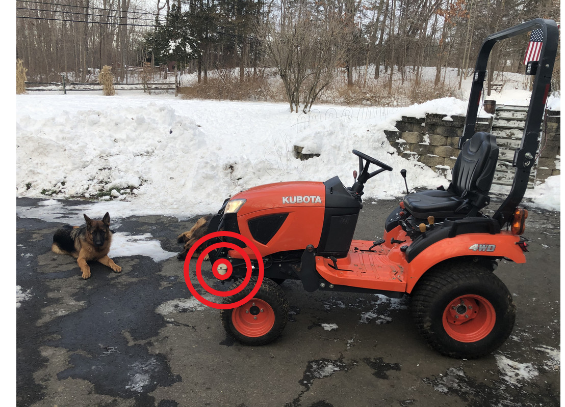

This was my solution. The local Kubota dealer has asked me a number of times if I'd be interested in making kits to sell at the store.
3,441
4,446
I like the idea, but
With my luck I would need to add this.....That thing would be on the deck in minutes.....LOL
Hell, I knocked mine off my L within the fist 20 minutes of going into the woods.
Nice job. 👍
