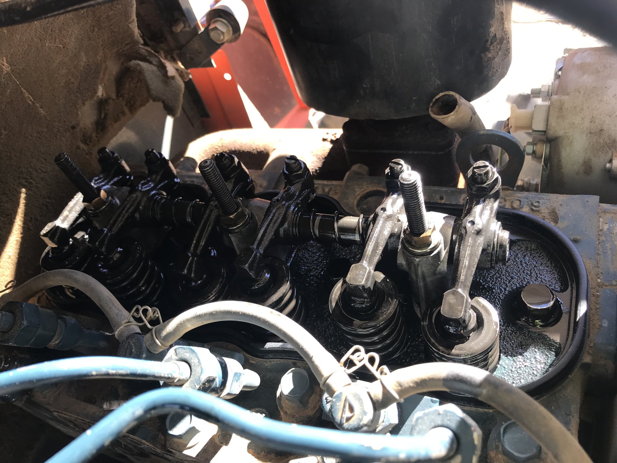

Finally pulled the rocker cover off and rocker arms all have slight play as described I turned motor by hand with glow plugs out.

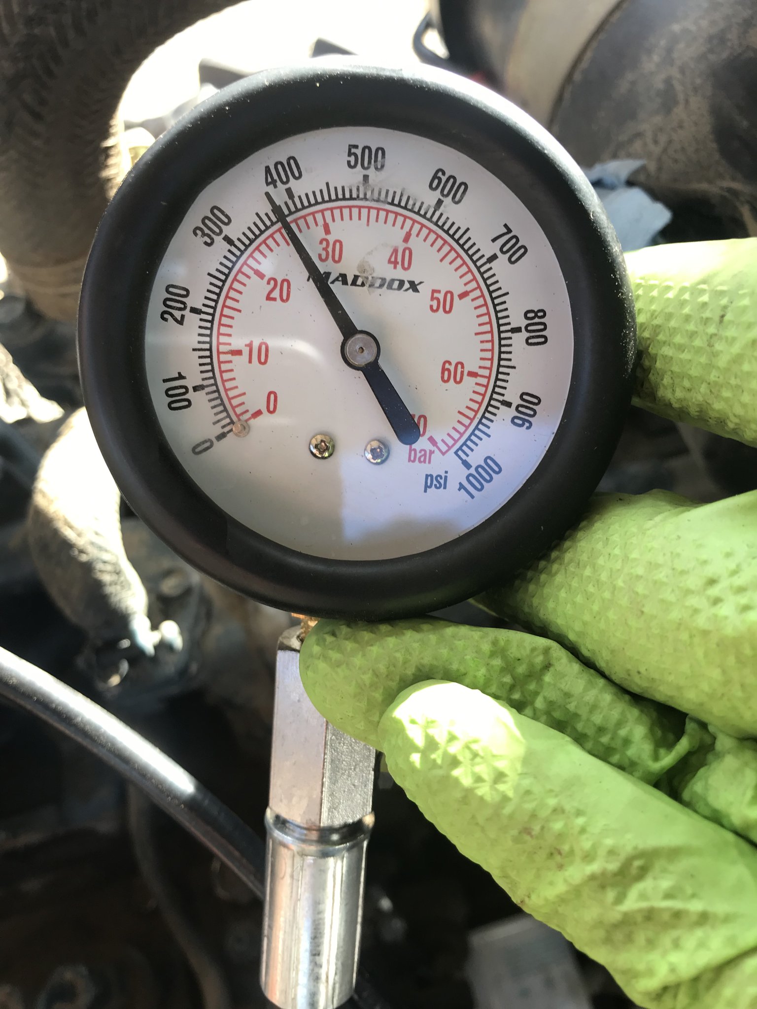

Re compression tested with full battery charge and charger on for test. Compression did go up but still have two cylinders low
275 rear
375 middle
265 front
Soap sprayed each no leaks no bubbles

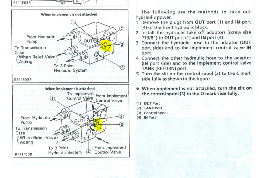

So after testing I tried to rip into the FEL to detach it went great but got stuck
MANUAL says to disconnect the 3 hoses with quick couplers
Next step is where I’m stuck
After hoses are disconnected then
“reconnect the hose remaining on the front hydraulic block to the out port of the front hydraulic block with quick coupler as shown in the figure.“
PICTURE ATTACHED of figure and instructions
There is no hose remaining it said to disconnect the three quick couplers.. All hoses are now disconnected and hanging freely.
Are my hoses not factory and I SHOULD have another quick couple in middle of a hose to loop the in and out or ?? I hope that makes sense haha
THANKS EVERYONE AS ALWAYS AND HOPE THIS HELPS SOMEONE ELSE ALSO IN THE FUTURE
33,886
9,106
You can accomplish the same thing as attaching a hose loop by turning the slotted valve in the middle of the block.
Just turn the slotted valve counter clockwise.
You'll know you got it right if the three point works.
Will do Wolfman my wsm mentioned the spool also and said turn To the “o” mark which I couldn’t find no matter how much I de greased and wiped .
