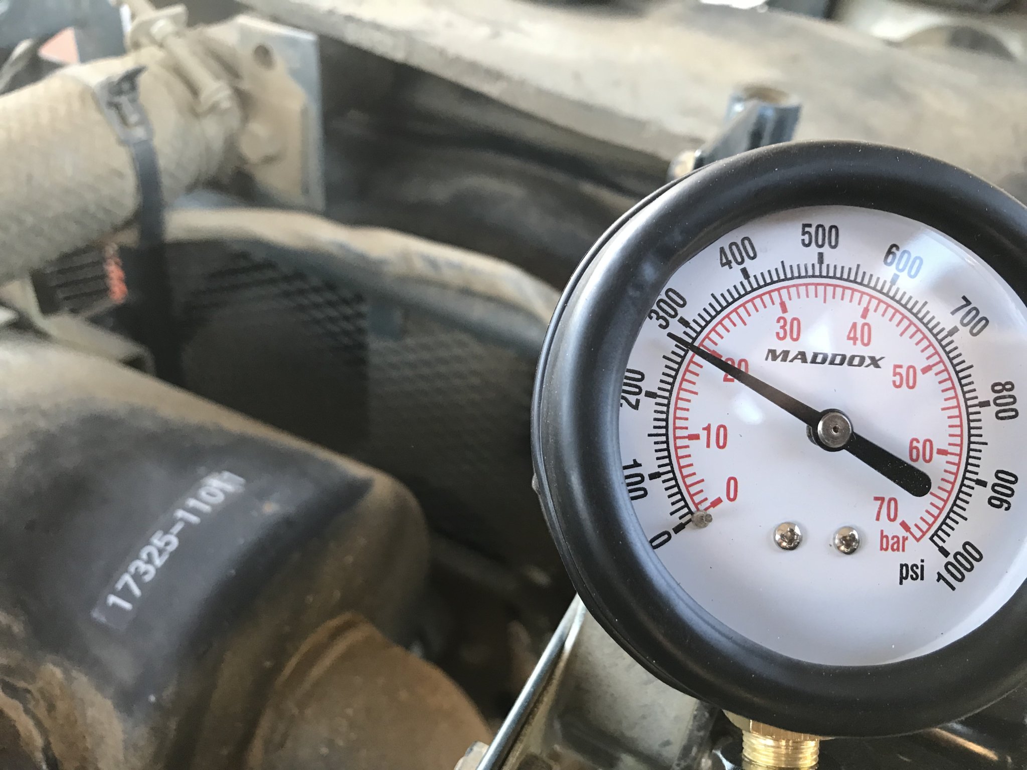

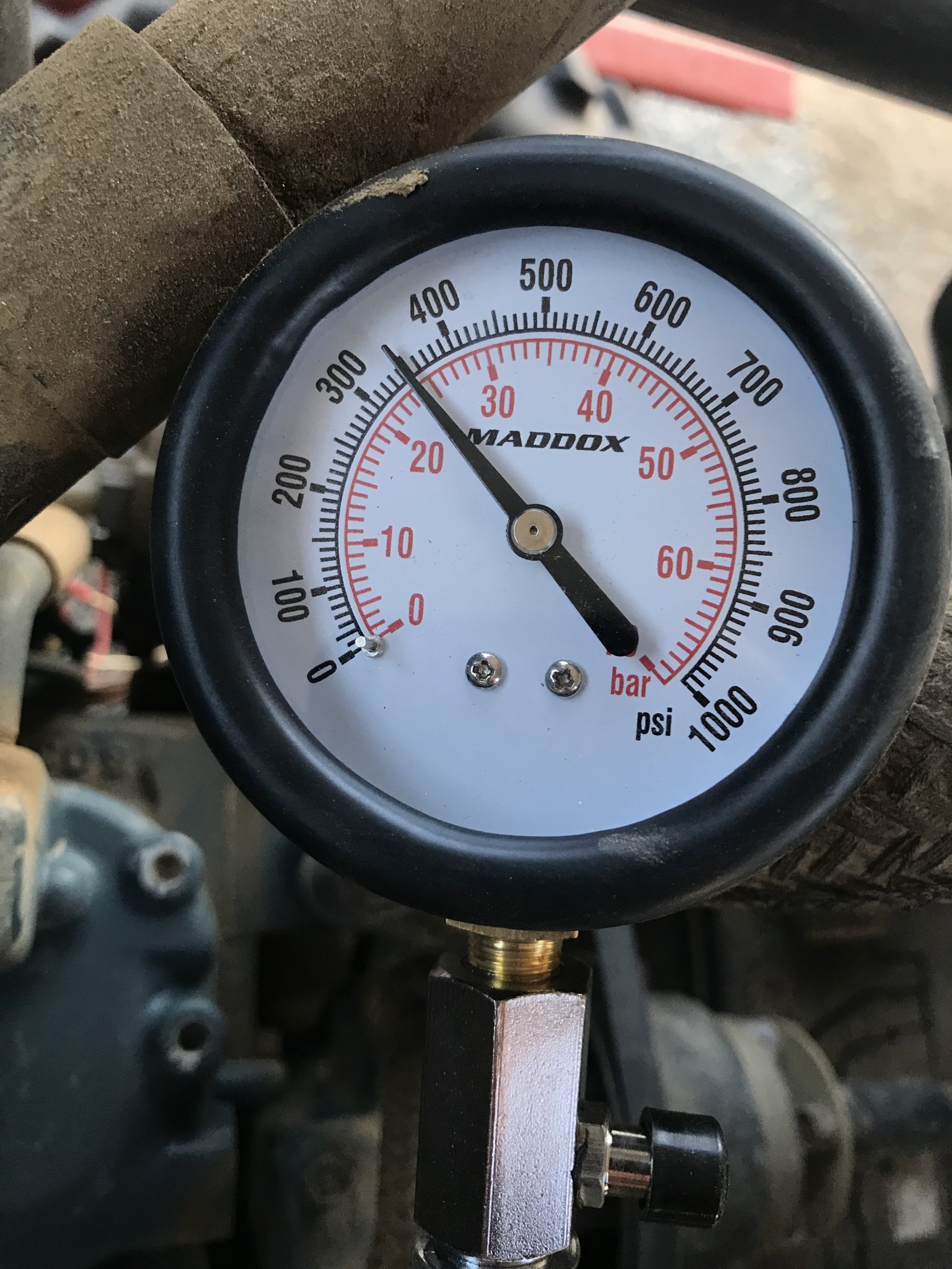

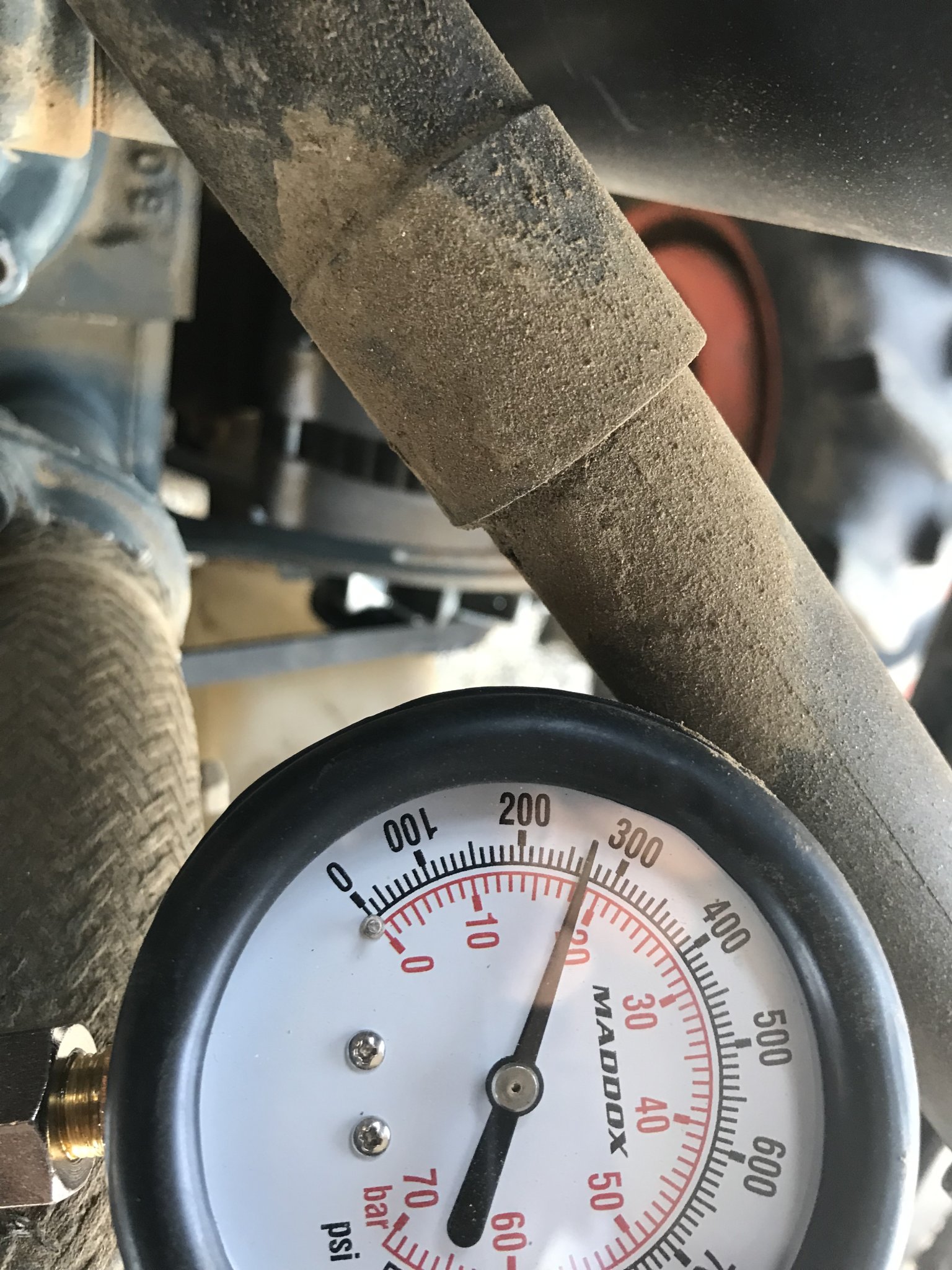

Ok bought the tester and spent a day getting it cleaned and torn apart.
Wolfman, On length, the kit had two glow plug adapters right width and thread but both were too short.. PIC ATTACHED
Both yielded the same pressure results on each cylinder (harbor freight tester keep in mind
Forward cylinder 280 psi
Middle cylinder 345psi
Rear cylinder 265 psi

Thanks to everyone as always for your time and help !
So questions of the day are:
Is this range of compression acceptable (265 psi low 350 psi high) or are my young un educated concerns reasonable in this case? what are my best and worst case scenarios?
with these numbers in mind what is my course of action with the still smoking engine oil filler spout?? I saved up to get this beauty so I hope hope hope all is ok but my heart says near 100 psi is not a good difference between cylinders…

28,664
5,098
Yep sadly you need a rebuild!
You have one cylinder that's doing most the work the other 2 are dead and just along for the ride.
With this kit you'll have to have a machine shop / engine builder remove, reinstall liners and bore them to size.
