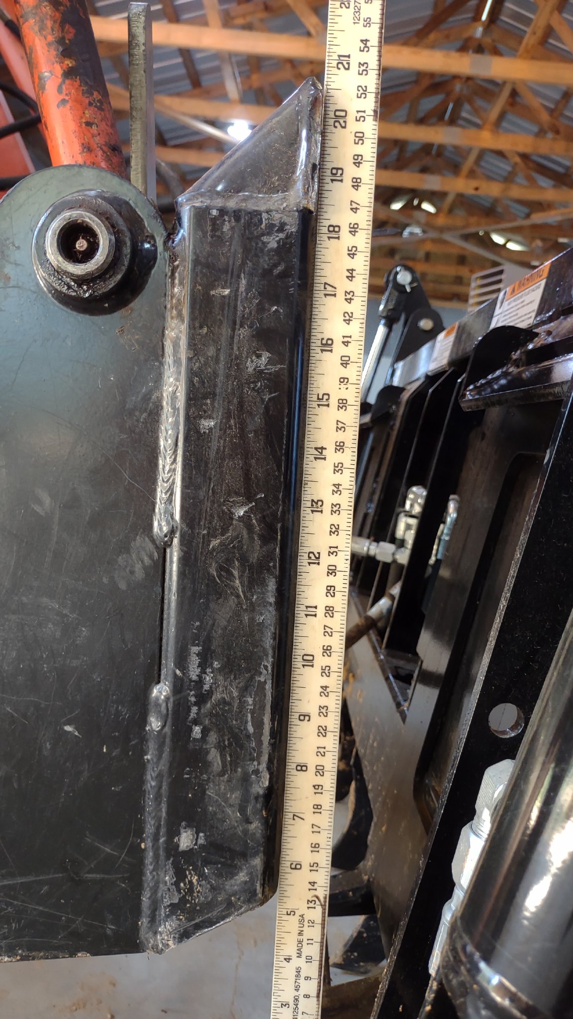

so I have taken more photos. nothing is bent, all top edges of shoes are square. I would need a much longer square. both sides have same wear and line up very equal on new implements. spacing on implement the same on each shoe. I'm hoping that kubota dealer is talking to manufacturer. I have lined up a welder who does very large equipment and should have large straight edges. But I think it is like old timer said - some were not manufactured to universal specs.
I have a feeling that top corner of flat bar is hitting the back of the 'socket'. Some grinding might let it sit down.
First, make sure the adapter isn't twisted. Are both sides of a new attachment out at the bottom about the same amount?
Assuming so, you could make a template out of something fairly stiff, sheet metal, hard plastic, wood, hard board, etc. to match the standard below. Then hold it up to your attachment and see where there's interference. Some grinding might fix it. Or some re-fitting and welding might be required.

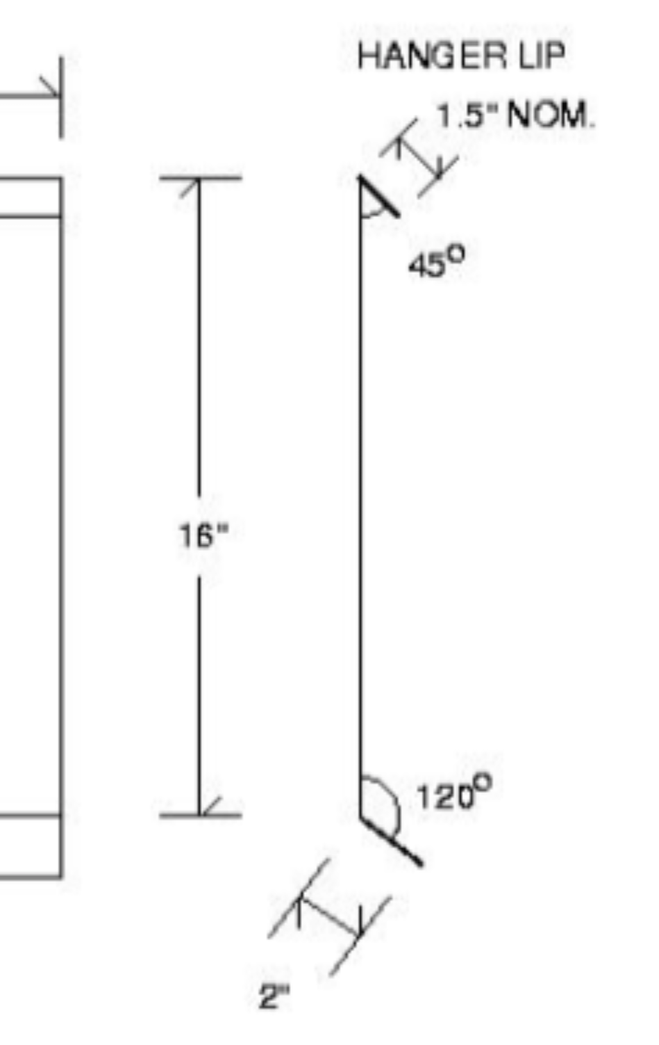

Here's a picture of the ATI adapter on my TL720 loader. You can see it's about 15-3/4" from the extended point of intersection at the top to the bottom corner.

The top of his shoe looks pretty thick. I am thinking the top hook (vee) on the forks may be too small/acute and is binding and wont let the bottom of the forks swing all the way in. Different problem with similar solution - grinder.
I do agree, It does appear ln the OP photo that the top shoe may be extra thick.

33,017
8,460
This picture (bottom) says your SSQA on the loader is spot on.
The issue is in the plates on the attachments.
Need to see the SSQA Adapter in the top pocket of the SSQA plates on the implement.
Also measure the SSQA plate height on the implement, and compare it to the pic that @PoTreeBoy put up here:
