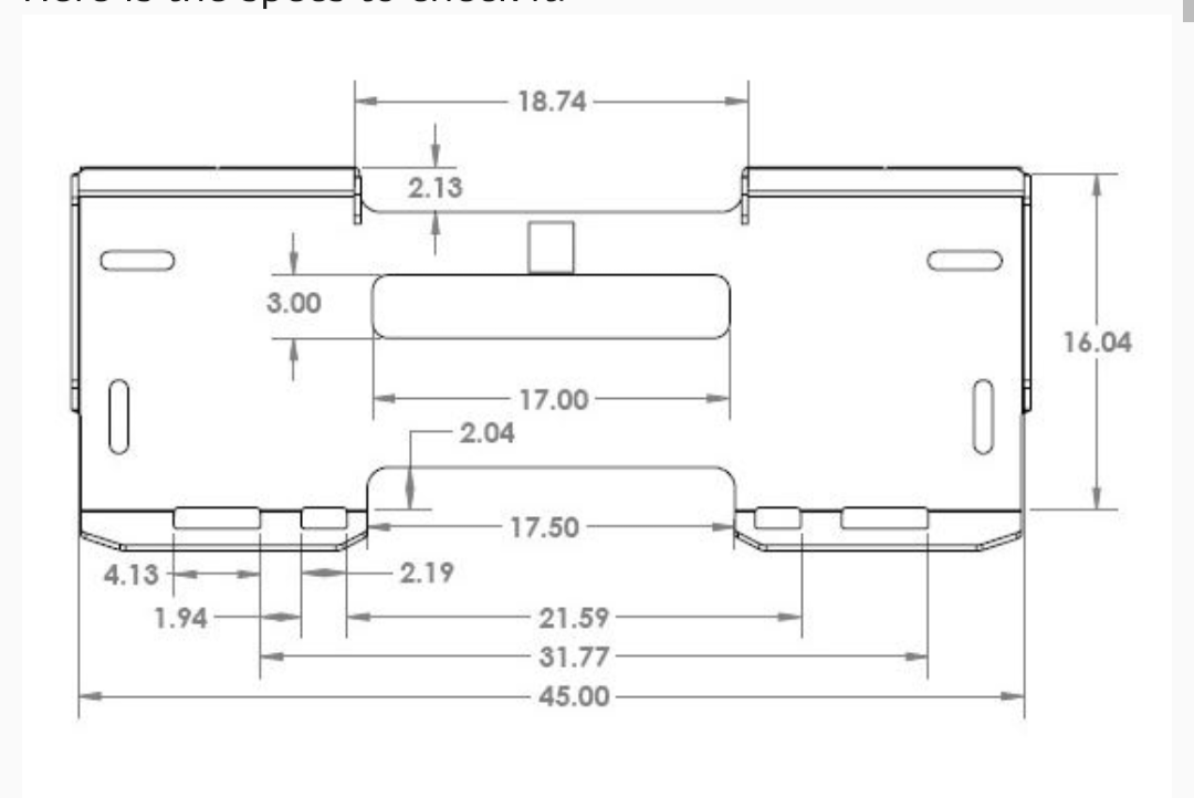

Since you wrote 'loader', I'm going to assume you meant skid steer quick attach (SSQA), not quick hitch.
Are you saying the tractor adapter is too wide to fit into the implement plate? The adapter should be 44" wide and the implement receptacle should be 45".
If this isn't the problem, we need more explanation, or a picture.

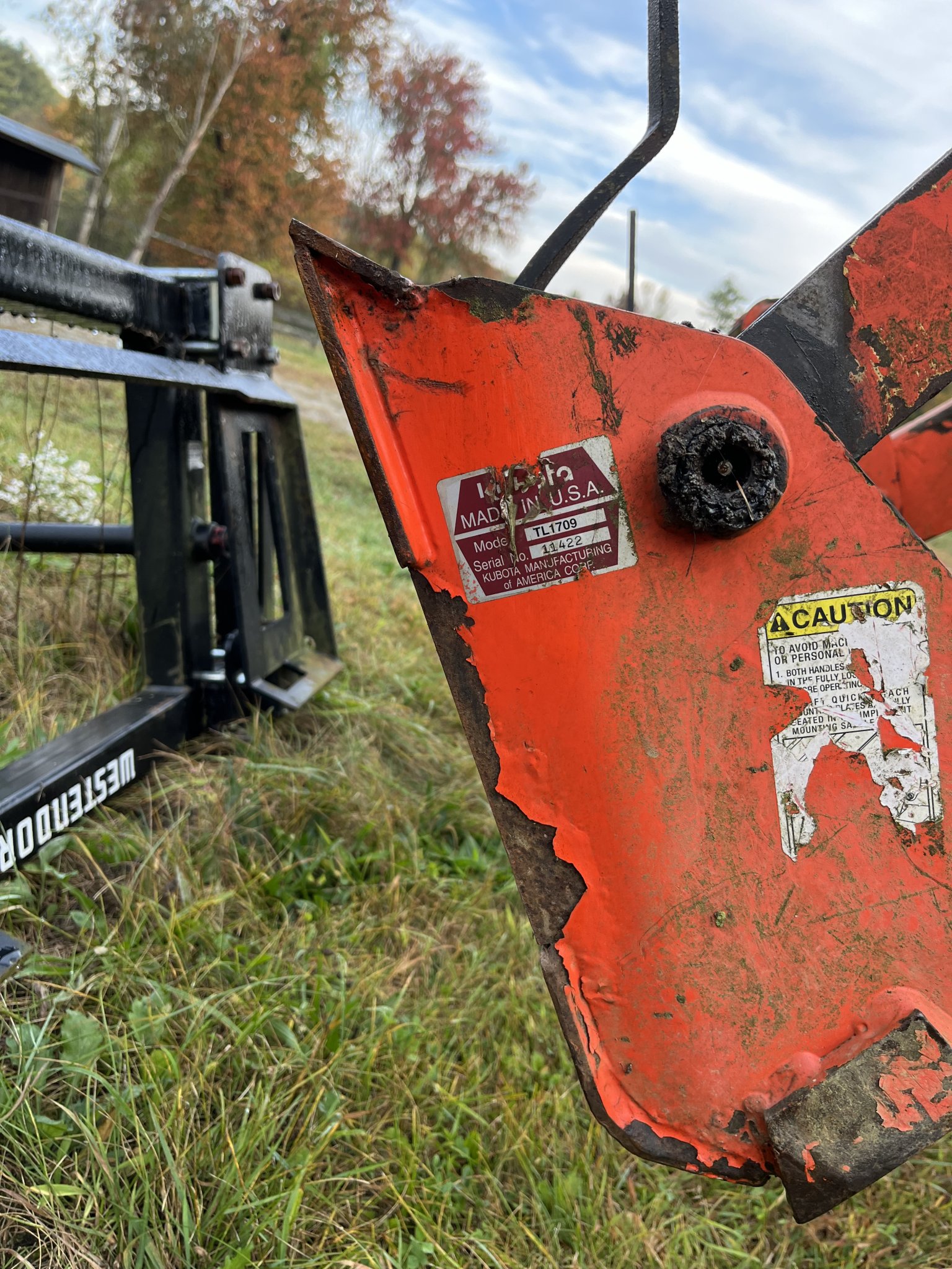

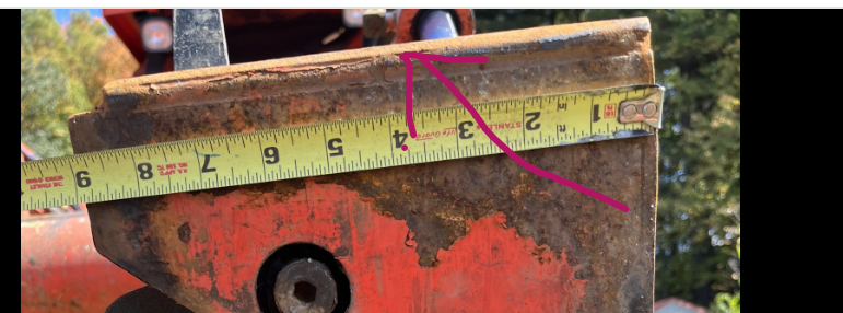

So here are pictures. The bottom of the shoe rests on bottom of attachment but the bend on attachment prevents the shoe from making full contact. So I am refering to the gap on the vertical line which is about 3/8". The pallet fork attachment I purchased is worse. I tried 3 of them they had in stock. Same problem with each.

I just took a little golf cart ride to look at my L48TLB quick attach.
My OEM quick attach assembly appears to be totally different from yours.
You mentioned your serial number.
Mine is: 61802, and was apparently purchased in 2006
Is it possible, that mother Kubota, manufactured some early L48 TLB models with different quick attach dimensions, or....... could the previous owner have added a non standard quick attach system as an after market item?

so I have taken more photos. nothing is bent, all top edges of shoes are square. I would need a much longer square. both sides have same wear and line up very equal on new implements. spacing on implement the same on each shoe. I'm hoping that kubota dealer is talking to manufacturer. I have lined up a welder who does very large equipment and should have large straight edges. But I think it is like old timer said - some were not manufactured to universal specs.
