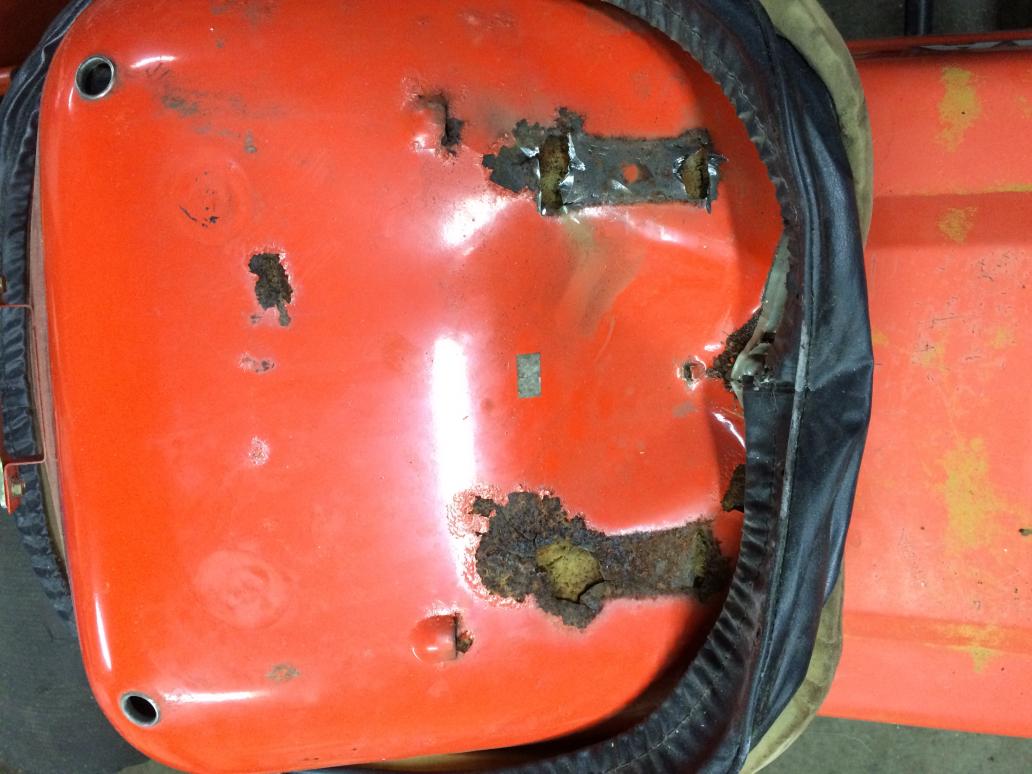

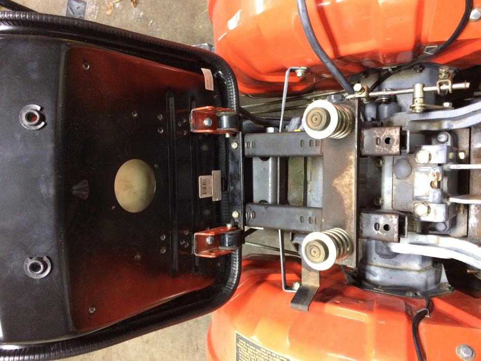

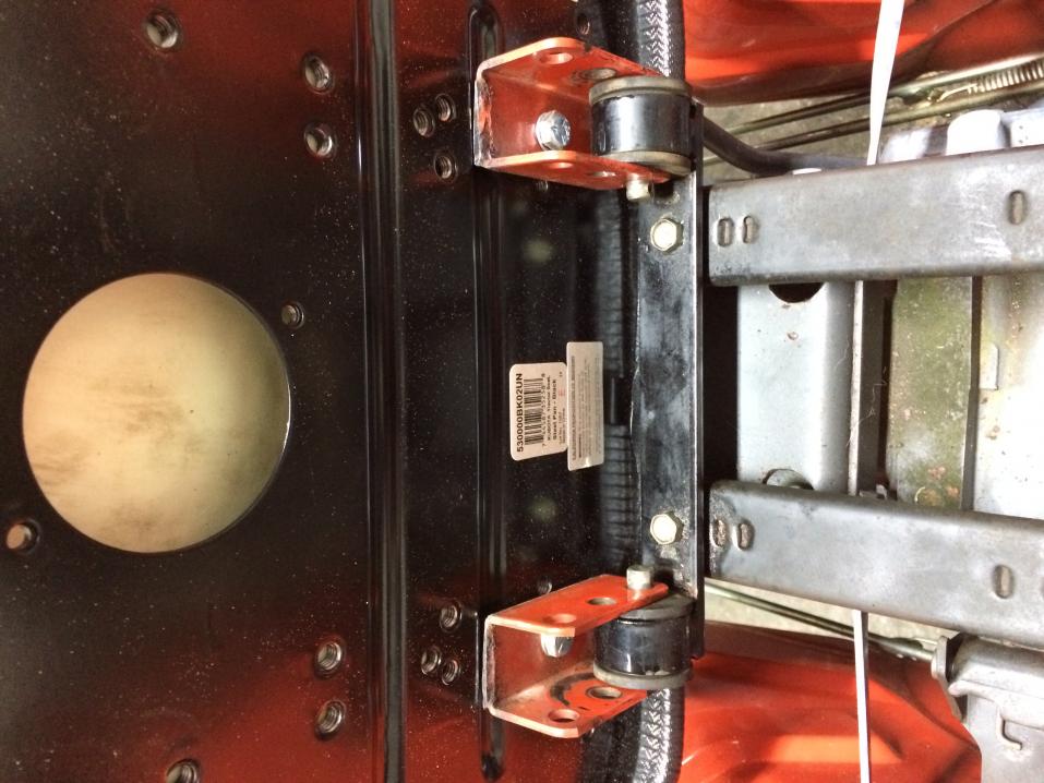

The 1st item to be upgraded was the seat. There is many options, but this is the one that I choose and was a fairly direct fit with minor modification.
The original was getting rusty around the hold down brackets. I found the Black talon compact seat at a local (they don't pay me, so I don't advertise for them) store that listed Kubota as an option.
I had to cut off ( grind) the rusty welds and remaining old seat material from the old seat mounting brackets. Then bolted them into the new seat where I felt would work for me. Like I said, easy with minor fabrication skills. Its a great time to lubricate the seat rails with seat off.
New seat is soooo much better now and I can actually lean back. :)

thanks for sharing. Looks great
10,972
2,825
nice seat fix - I went ahead a replaced the whole thing, mine was shot!

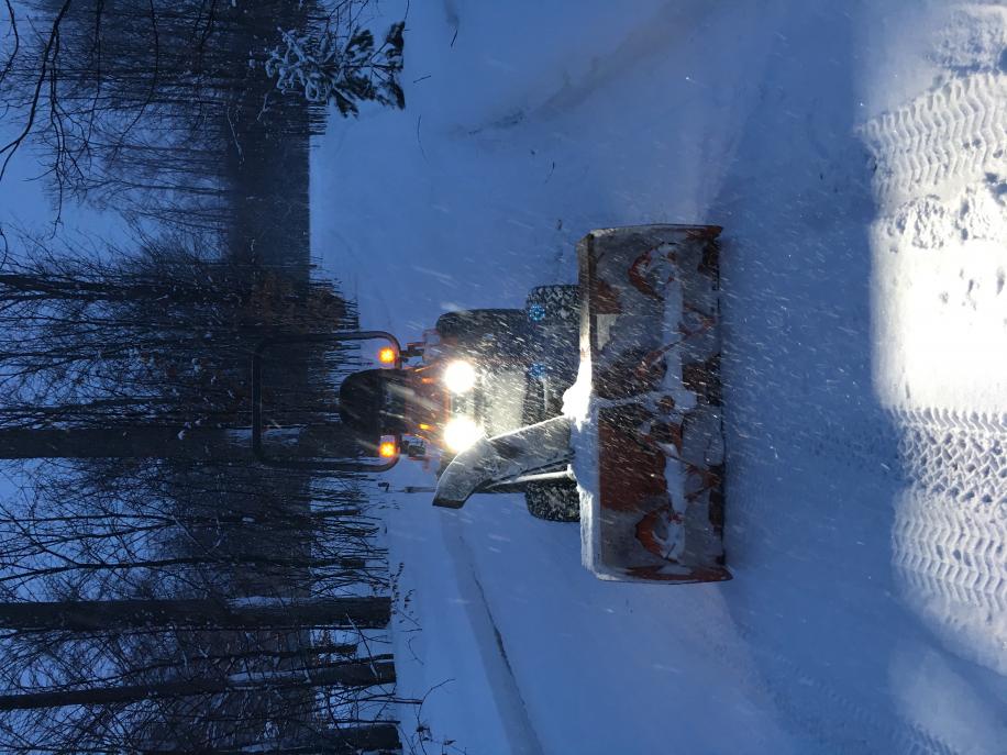

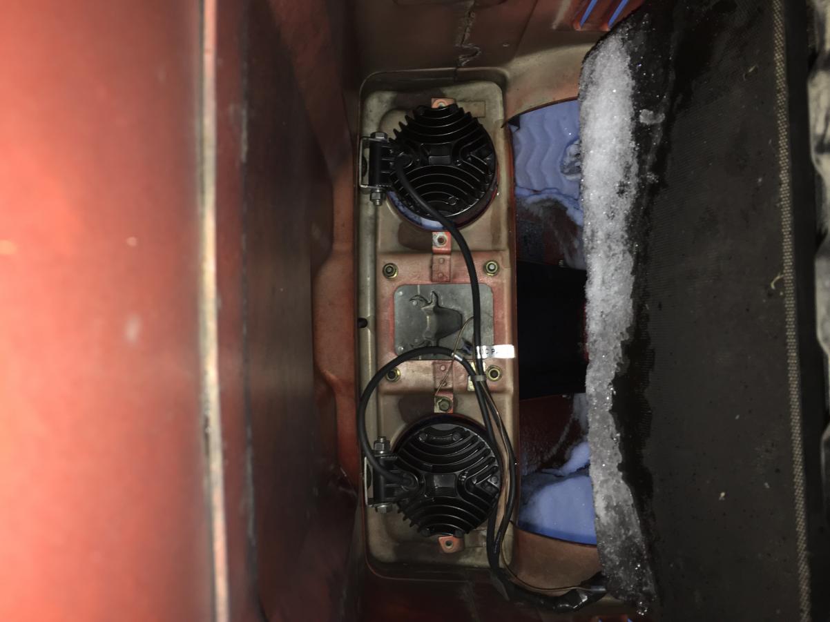

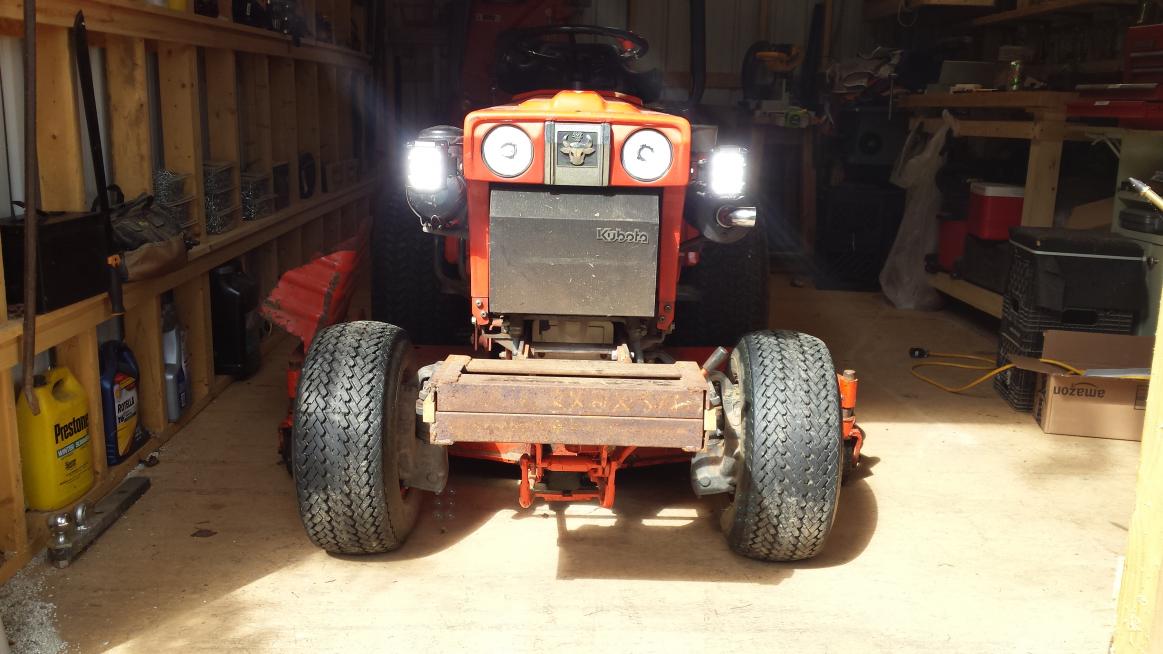

It took me a while to figure out what I wanted to do with the headlights as the original sockets disintegrated like many of this vintage do . The options I thought of were to find a good used set or after market lights and then upgrade to led bulbs or just modify the hood and install LED light asmbs. As you can see from the picture, I just drilled into the hood an installed new light asmbs.
I believe the diam of the lights are 3 1/2 " . They are a 45W flood light and paid around $30. They are super bright and I actually have to aim them down so the cars aren't blinded on the road.

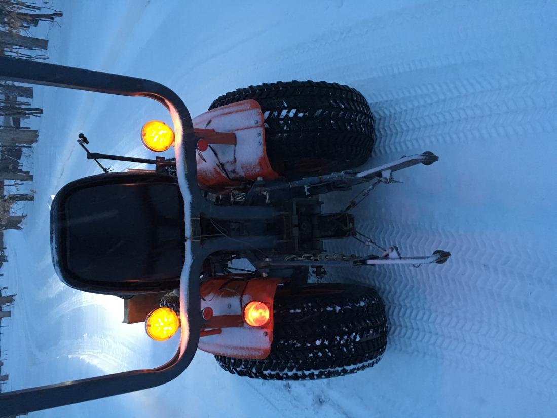

The next lights I upgraded were the flashers in rear. Not sure the watts but they bolted right in. I changed the flasher relay to compensate for led lights, but they still don't flash. Oh well, flashers are annoying anyways.
Both of these light upgrades are a great welcome change to the old dim lights originally installed. If you have a little experience on how electricity flows wiring these up are a piece of cake.

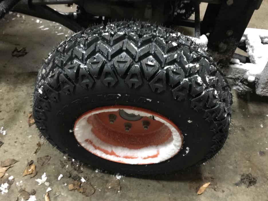

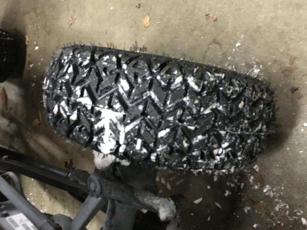

The front tires were do for a change as it kept sliding more then I wanted. The search for good 20.5 x 8-10 front tires is a joke. Thanks to this thread here
http://www.orangetractortalks.com/forums/showthread.php?t=1956&page=2
I realize I'm resurecting a 5 year old thread, but this is the one that both Google and the site pull up when searching for this info.
And now they're discontinued again. :(
Mine came with Goodyear 20.5 x 8 x 10 trailer tires on the front from the dealer. According to the original owner, it shipped with Ag tires, but he wanted turfs so the dealer switched them out. At 20psi, I measured the worn tires' circumference to be 65" even.
I replaced them with the 20 x 10 x 10 Carlisle "All Trail 2" ATV tire mentioned above. At 20 psi, I measure the circumference to be 64-3/8" -- which works out to a calculated 20.49" diameter. Tread width is virtually identical at 7", although the trailer tire sidewalls bulge considerably more on each side.
I really like the tread compared to the trailer tire.
My mind was made up. I ordered the atv 20x10x10 tires up online and installed. They work great. The size difference draw back is the top speed may be a tad slower, but that is a minor draw back I can live with when it keeps me out of the ditch.

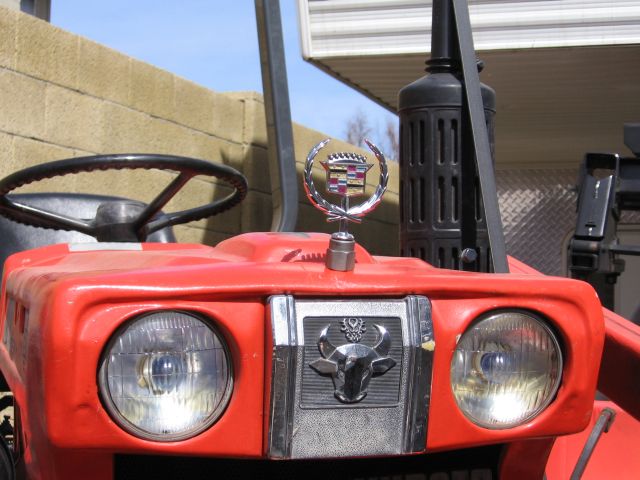

Hi TLC, tell us more about your headlights. They look great! I have swapped my bulbs for led but the stock reflectors aren’t too bright.
PS - I had a 1967 FJ40 for 20 years, sneak in a shot of your cruiser, by the B7100 of course!
7,856
3,088

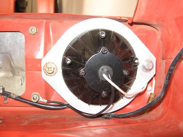

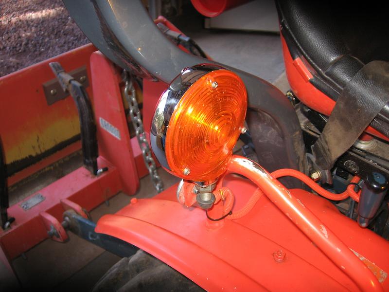

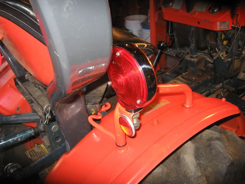

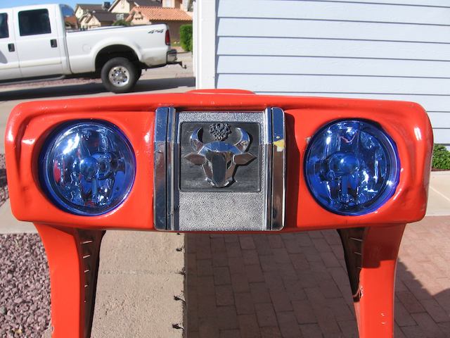

My first lighting mod was to replace the original bulbs/sockets with new ones from O'Riellys.
The second was to replace the whole assembly with "blue" lights. (right before LEDs got popular & cheaper:mad:) LEDs will be next.

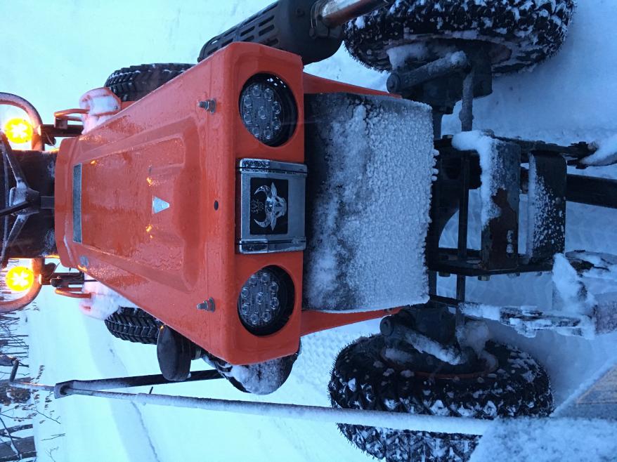

Third, I added these red/amber LED flashers. They are very bright & noticeable from a long way off.

Hey Lencho, sorry just say your question. The lights are TURBRO 2 x Mini Size 3.5inch 45W CREE LED .

How did you get your rear lights to flash with the LED lights ?
