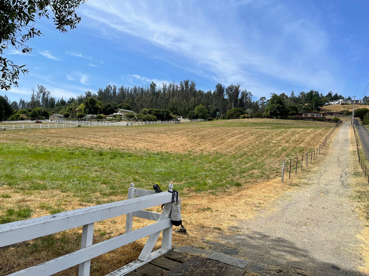

My wife and I were finally able to buy a house last year, and it happened to come with almost 5 acres of mostly meadow. I'm slowly piecing the story together, the property had horses, sometimes cattle, and the grandfather had mules. But not much in the last decade, I think.
The grass mowing is important in this part of central California since we are prone to wildfires. The former owner had a Kubota BX (of some sort) with mid mount mower and no loader to keep the grass down, or so I deduced from an old photo. Too bad it was gone before the sale… (For scale, about 700 feet to the top of the driveway.)
We got a mow last year from a nice young man who used his Kubota tracked skid steer at a very good price; sadly he had mechanical issues this year. A neighbor in the tree business did this cut with his Bobcat tracked skid steer and rotary cutter at a good price too, and he could slide the cutter under the lower rail of the PVC fencing to cut down on trimming. We would keep hiring these nice folks but circumstances have blunted that effort: broken equipment, no room on schedule, "I'm not taking any more clients since I'm 75 and want to retire", and so on. We want to be really good neighbors and keep ours and their properties as safe as we can from fire danger, so a tractor is in our future.

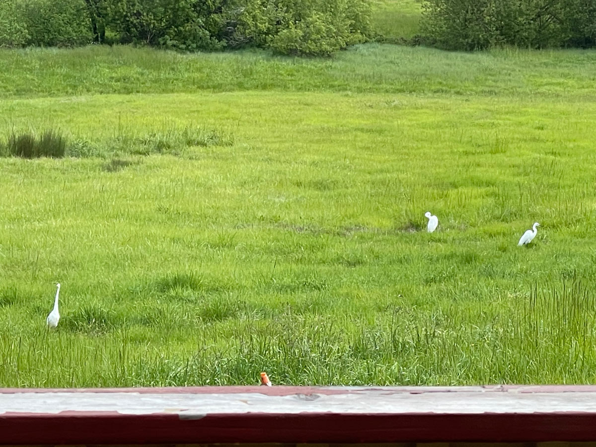

There is a lot of underground water in the rainy season, this image from April shows how lush and dense the grasses can be. By the time we got it mowed, the grass was over six feet in many areas. Also, the lower flats are prone to boggyness.

2. From the lush picture it sort of looks like you have egrets there…is that what those birds are? I am not familiar with your property or anything but if you would not drive a car through there when the egrets are visiting I would not be driving a tractor or ZT thru there either unless you feel really sure not getting stuck and ability to recover the machine….looks a little marshy to me. If you plan to mow that while the egrets there, look into KTAC and what it covers.

2. Pretty sure they are egrets. I enjoy seeing the bird varieties, got annoyed by the woodpeckers trying to stash sunflower seeds within cracks in the house siding… Delighted to see a turkey buzzard circle a bit and land only to fly off with a dead rat I had thrown into the meadow. They can smell from so far away.
